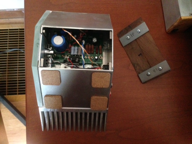

Drjbf1, I too think its smart to be able to take apart an amp without de-soldering. It's crazy to have to de-solder to work on an amp! What I do now when I build is put RCAs on a sub-pannel that unscrews. It does call for a bit of fussy cutting, drill and tap work and some care wth the wires and such but it makes good sense and keeps connections to the minimum.
Cinco, yes, heat management is most of the problem that defines an amps shape, that and then wire path. Its no wonder amp cases tend to look one way. The next logical step is to cease with running cables front to back at all and keep everything on one side, the business side! Stuff would end up looking like a new kind of steampunk switchboard but that could be cool too!

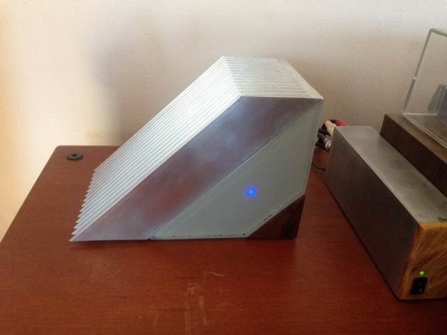

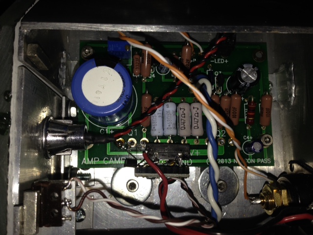

ACA Monoblocks

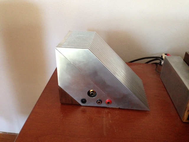

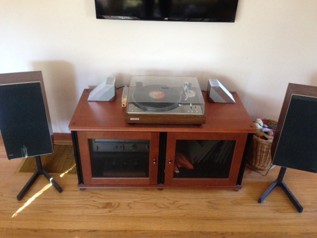

Amp Camp Amp monoblocks. Electronically just the basic ACA boards with the addition of a latching on/off switch circuit activated by pressing the glass tile on the front. Build thread can be viewed here

Just one thing your amp boxes have some air flow
or is closed all around the circuits ?
There are vent holes drilled along the bottom and top edges of the sinks. Theoretically, convective flow draws cooler air through the bottom and spit out hot air at the top. In practice, I've run these amps for hours on warm days without any ill effects. I do realize that the lifespan of some components may be shortened, but I'll cross that bridge when I get there.
Yeah so is not one beauty amplifier but safe as well.
Very cool design i like it very much. Thanks :)
