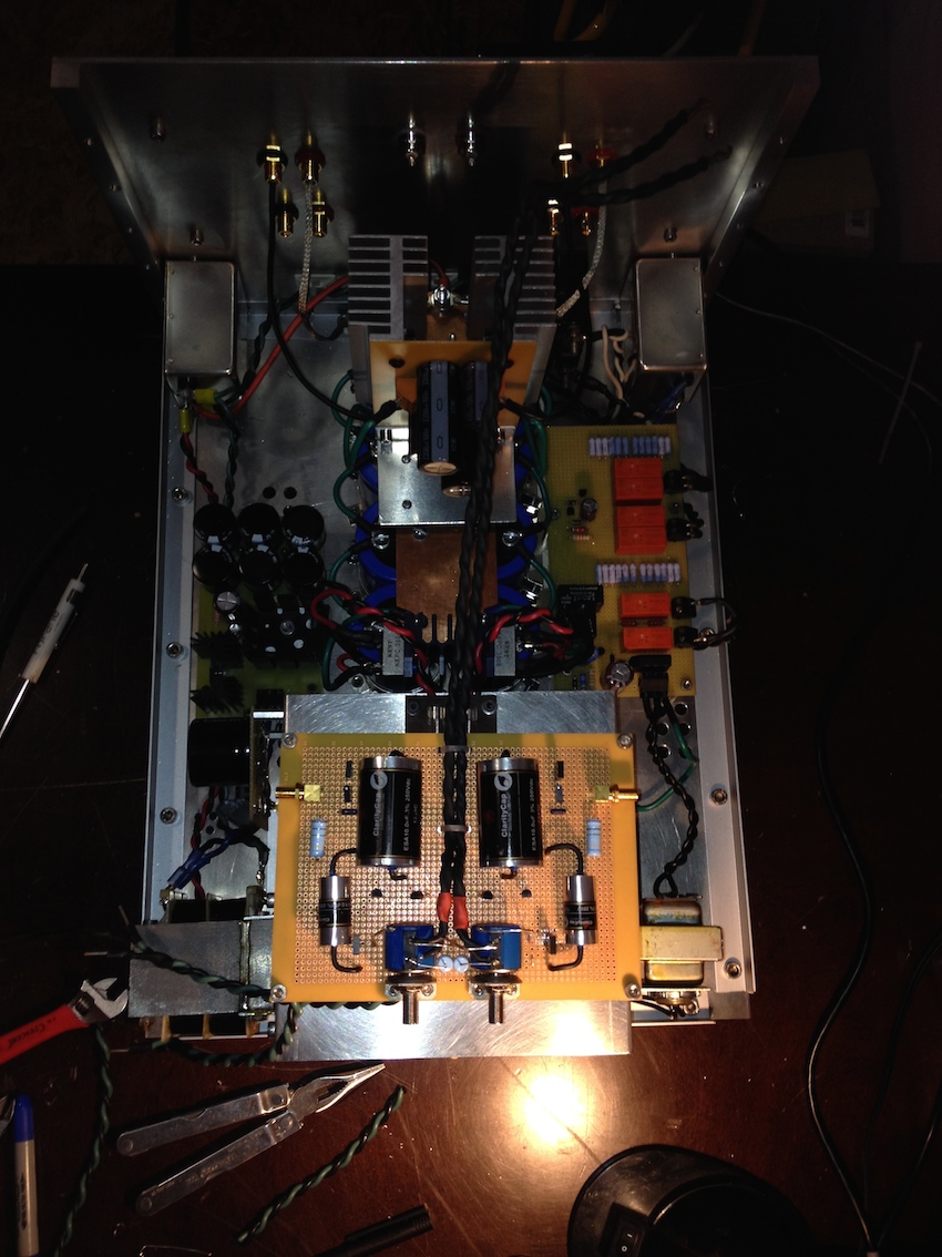

Hello,

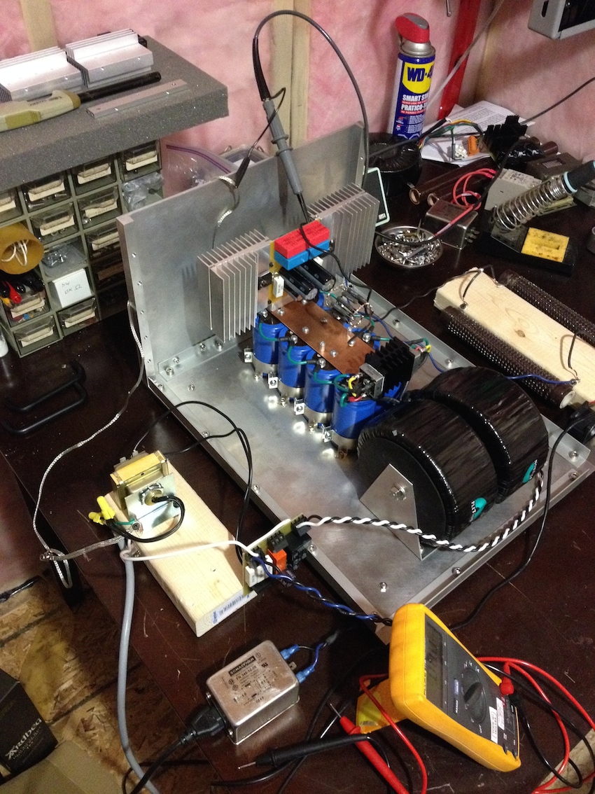

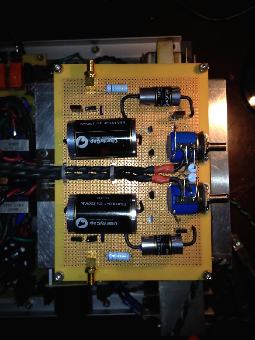

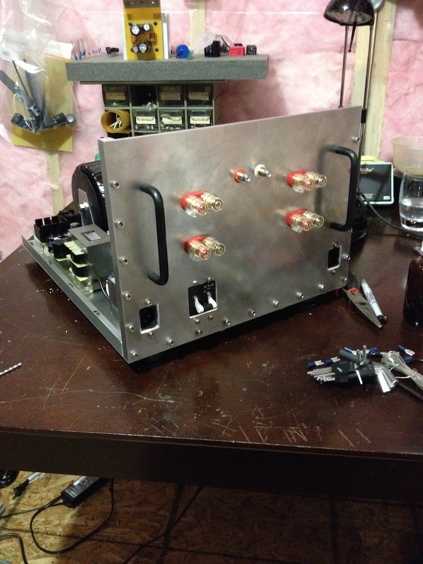

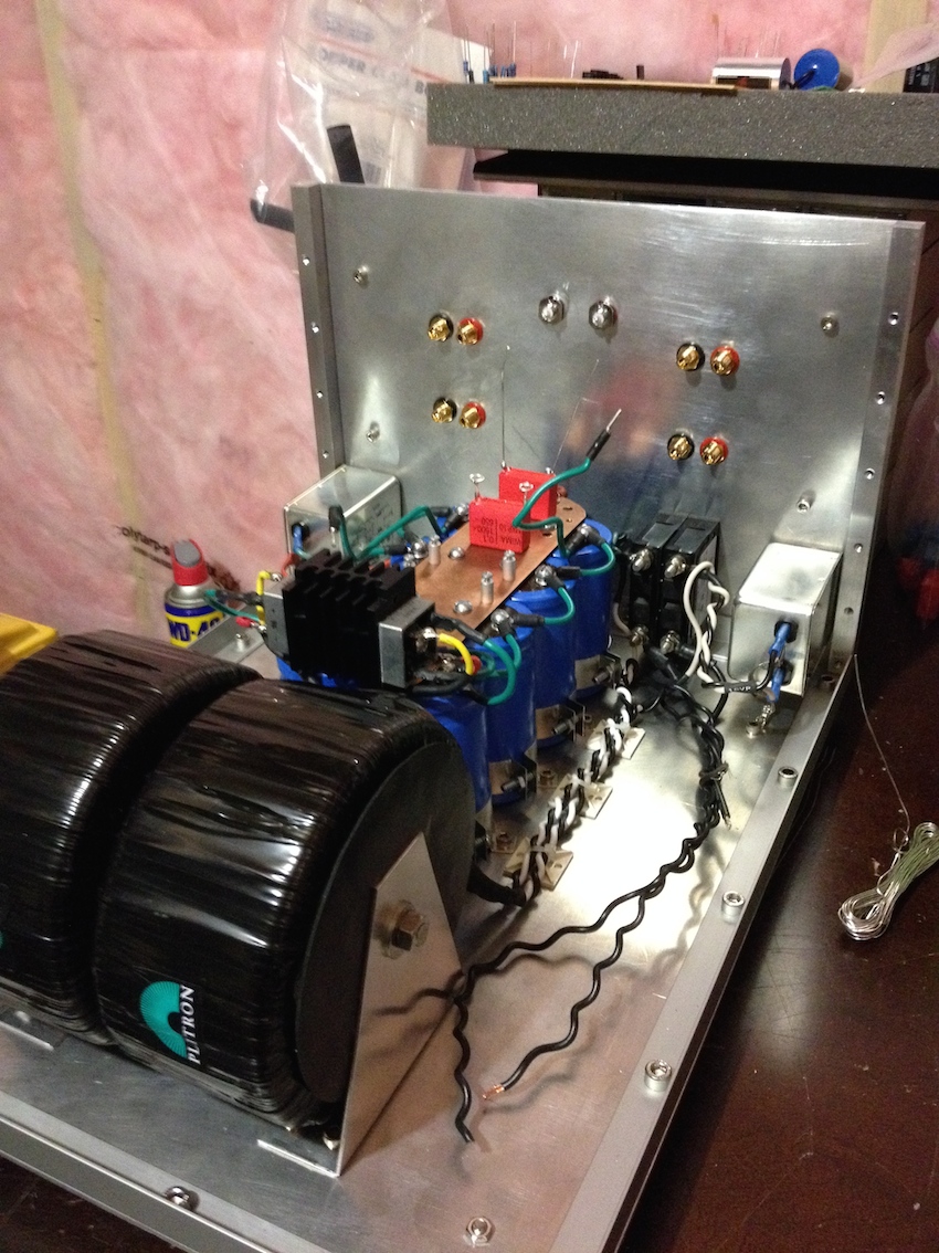

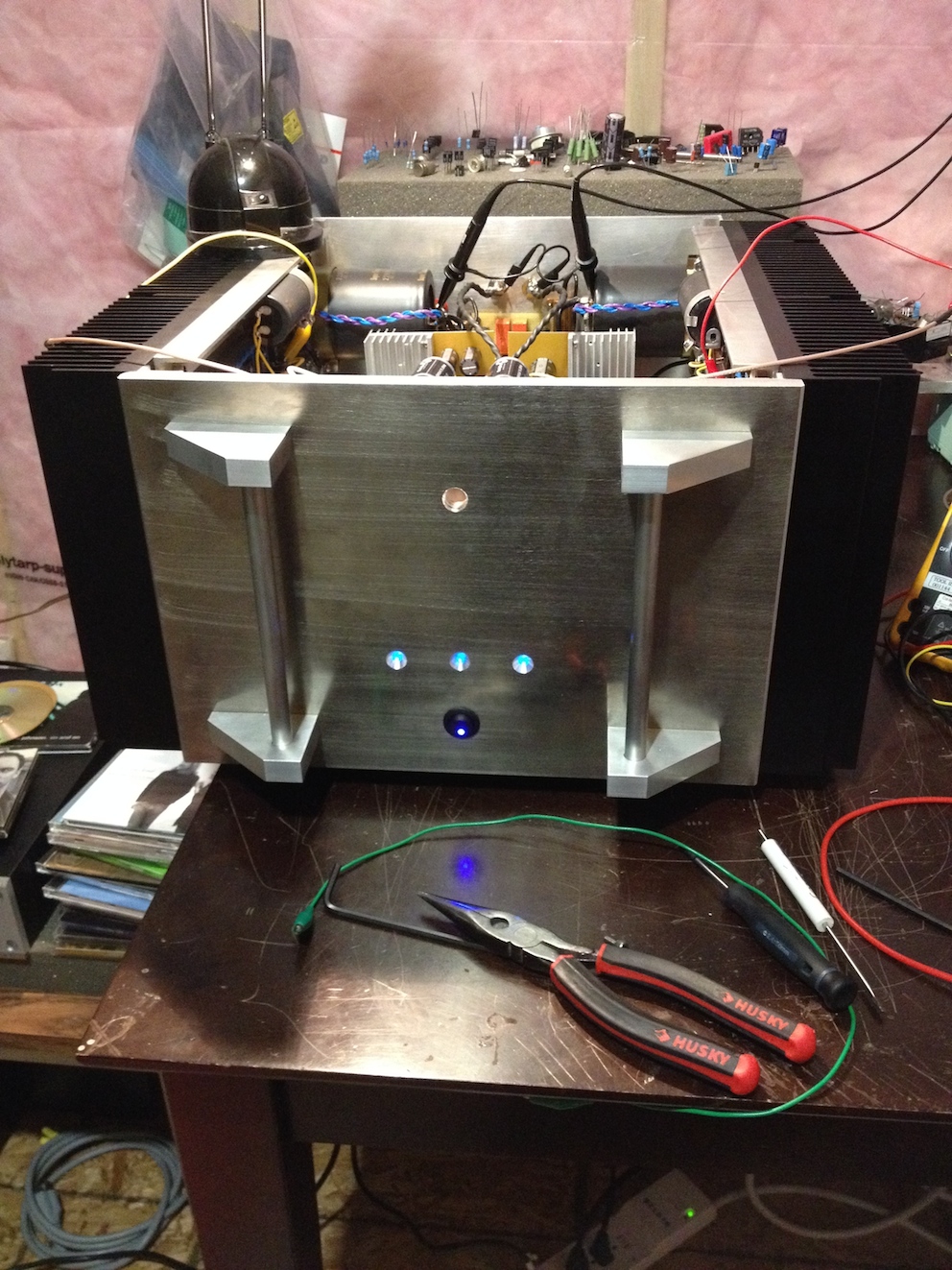

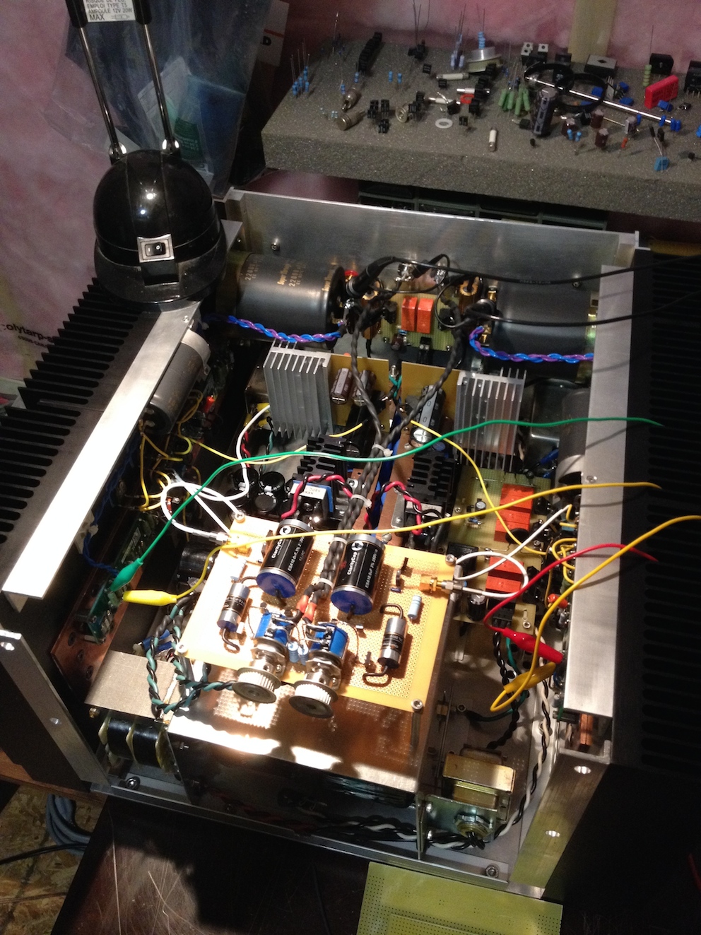

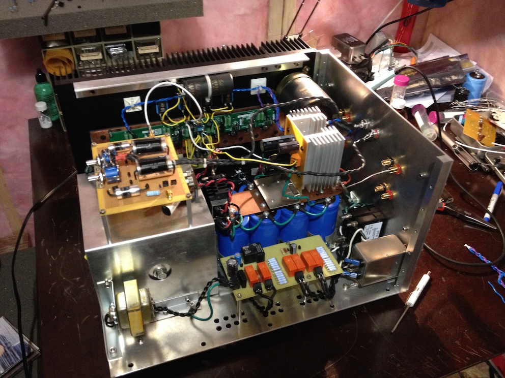

Here are some of the pics from my F5 Adventure. Many thanks to all who have helped along the way! Infinite thanks to Nelson for sharing his ideas and schematics in such a clear and concise manner.
This was my first amp. In hindsight I should have started smaller than a F5 V2. I integrated a B1 preamp into it as well. It's probably not a clean as it could be in terms of wiring but it measures well and is very quiet. I'm bringing it in to work and chucking it on the spectrum analyzer to see what kind of distortion specs I get. Biased up to nearly 3 amps per channel. Sinks get to 49 degrees.
Cheers!

F5 Turbo V2
Hello,
Cheers!

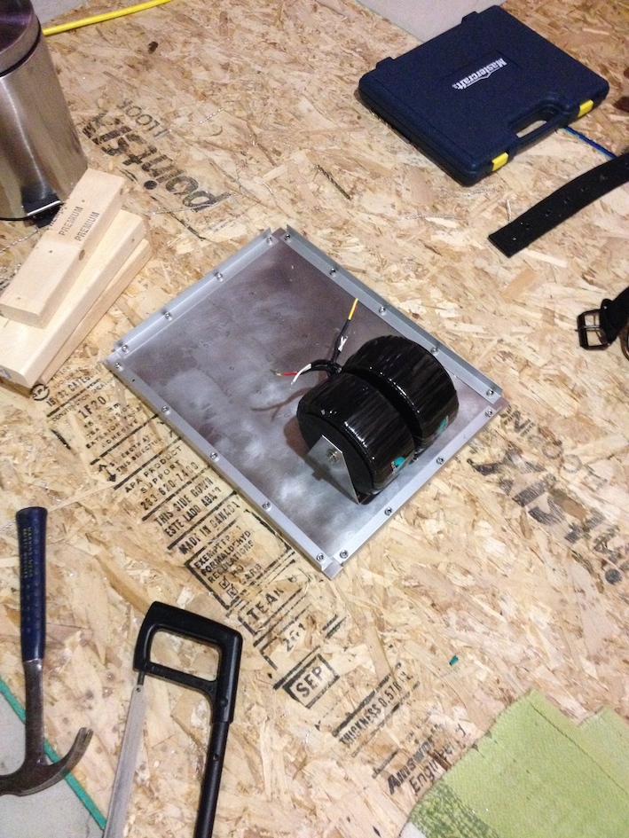

Mounting bolts
I have been told not to write in a post Thread but I can't ignore what I see in post2902, transformer mounting bolt.
How is/are the bolt/s done up?
Ah, why yes. After many years of lurking on this forum I was sure at some point I would be having a conversation with you Andrew! Good to finally make you acquaintance.
It's actually 2 seperate bolts. Counter sunk heads into the epoxy potting of the donut and the chucked a 5 mil layer of kapton between them with some high voltage putty to help with any vibration or shifting.
Cheers

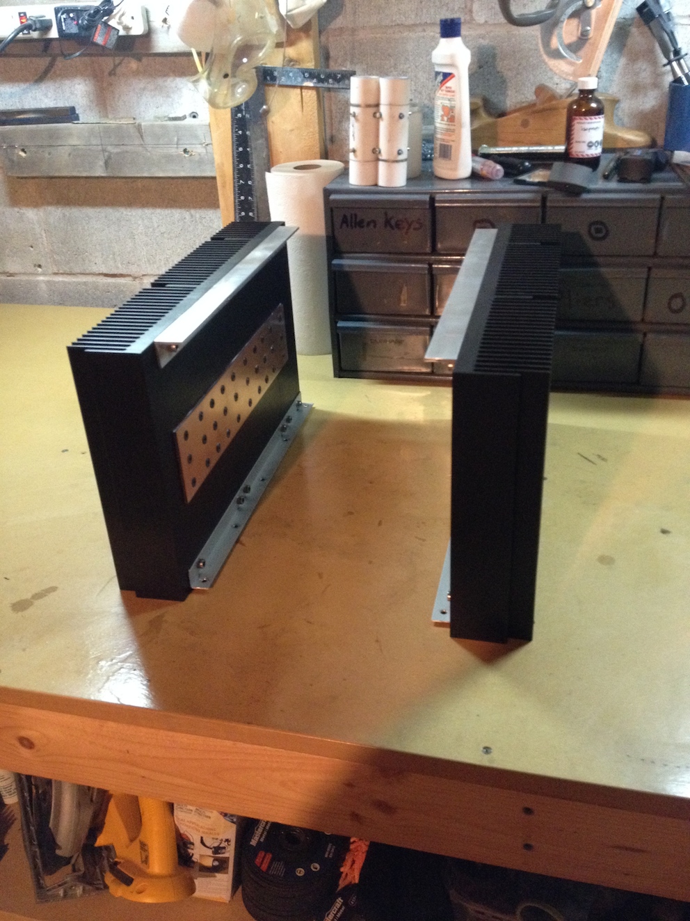

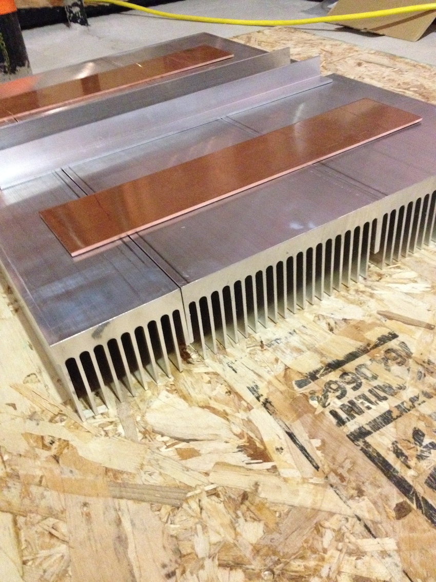

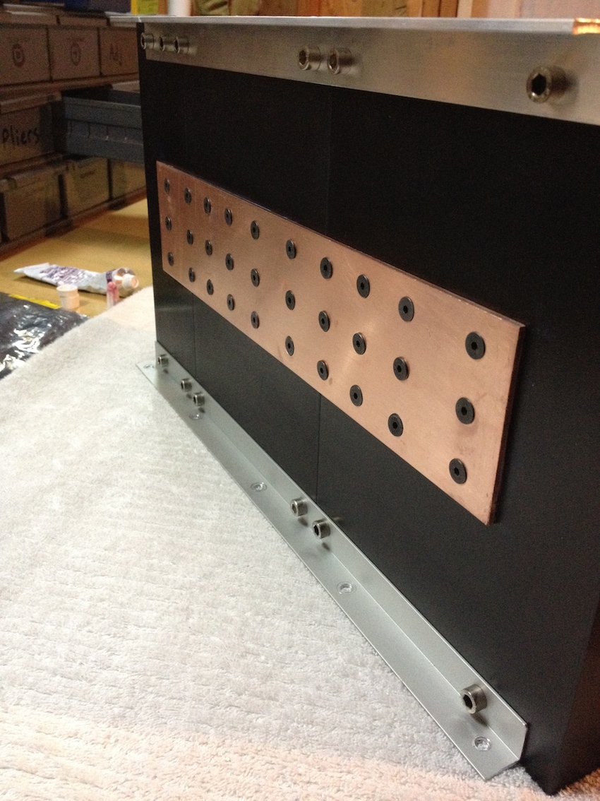

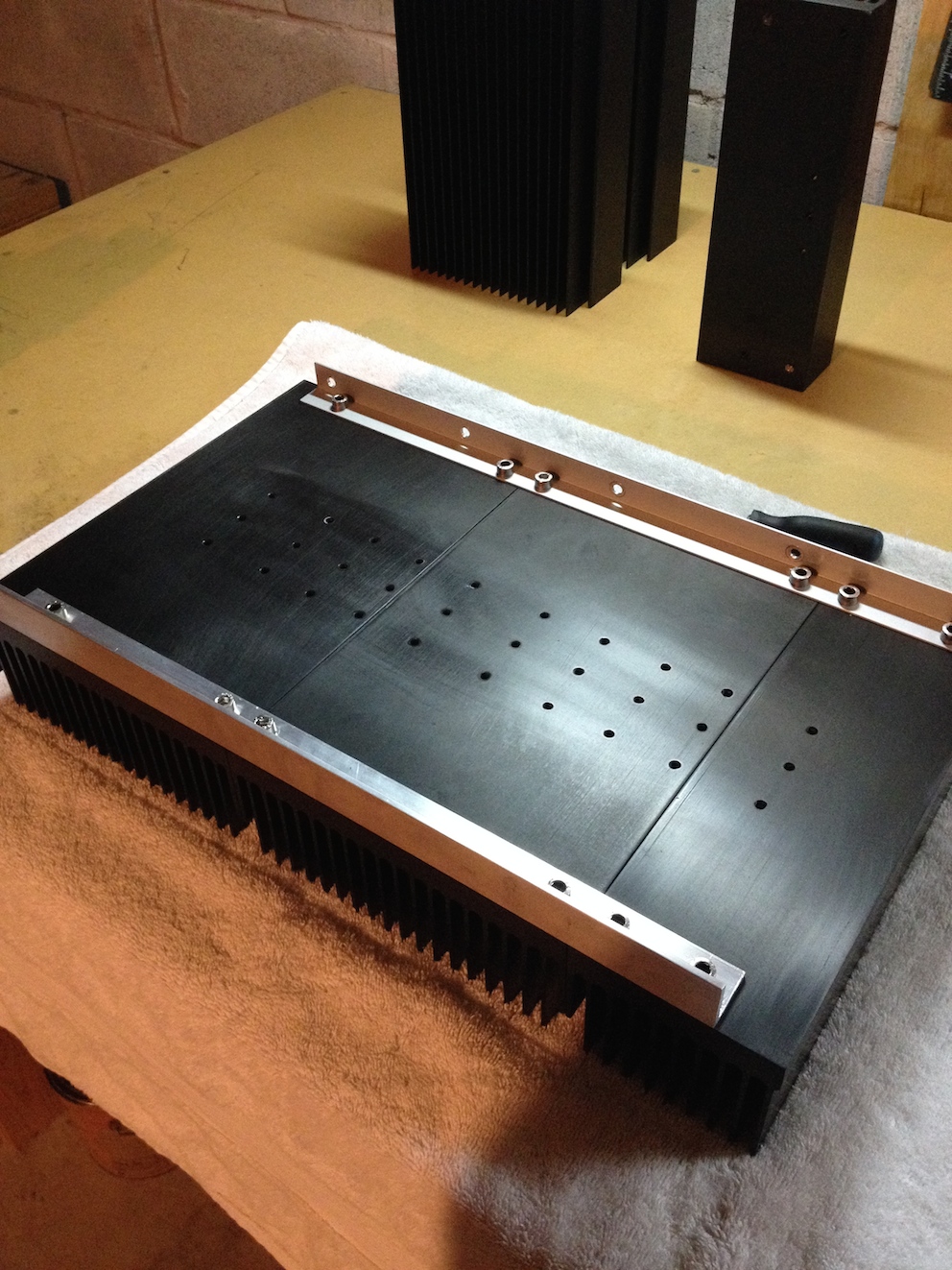

Eggplant,
What a nice monster! How do you screw the alu plate to the square bar? Dis you drill holes all the way and fix the screw with nuts&bolts? Or did you tap the hole? Heatsink tapped, or with nuts&holes (drill all the way)?
Thanks! I drilled all of the holes to a depth just shy of all the way through and then used M5 M4 or M3 bottoming taps. There is not a single hole directly through the heatsinks.
Cheers.
Uh okay. One last question. Did you (black) anodized the heatsinks by yourself? How did you do that? Any links? Thx Eggplant!
No problem. Glad to help. I actually purchased a 6 foot length of extrusion, chopped it up an then got the whole works anodized. It was 125$ for the whole works and I have enough to do up a couple of F5s. I'm building a set of full range single driver speakers next and I think I'm going to build the f5 monoblocks into the enclosures.

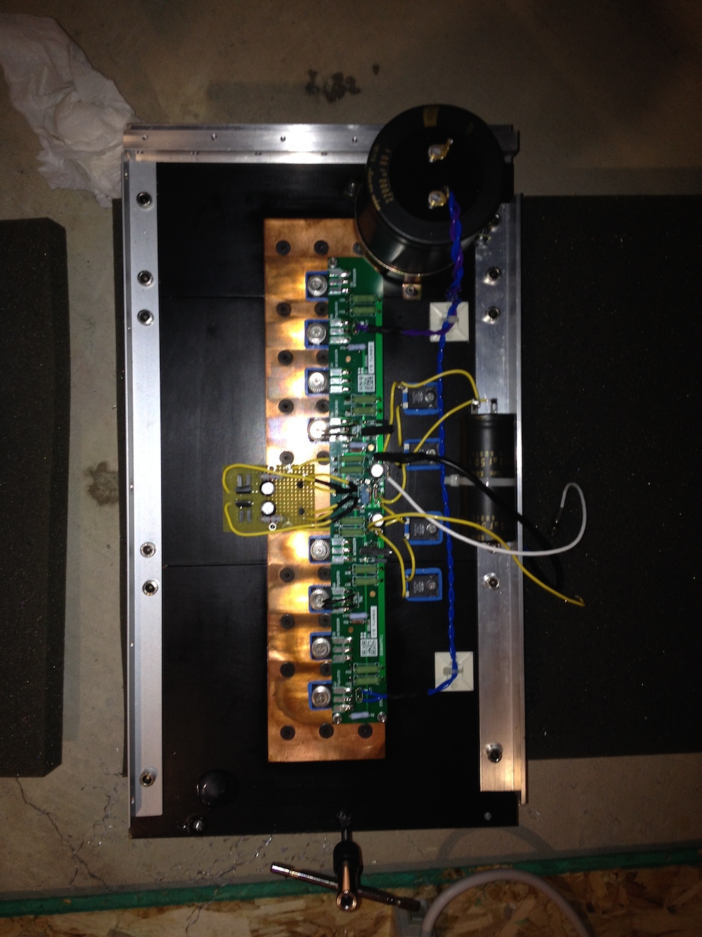

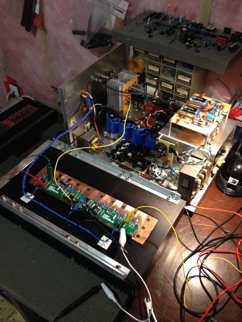

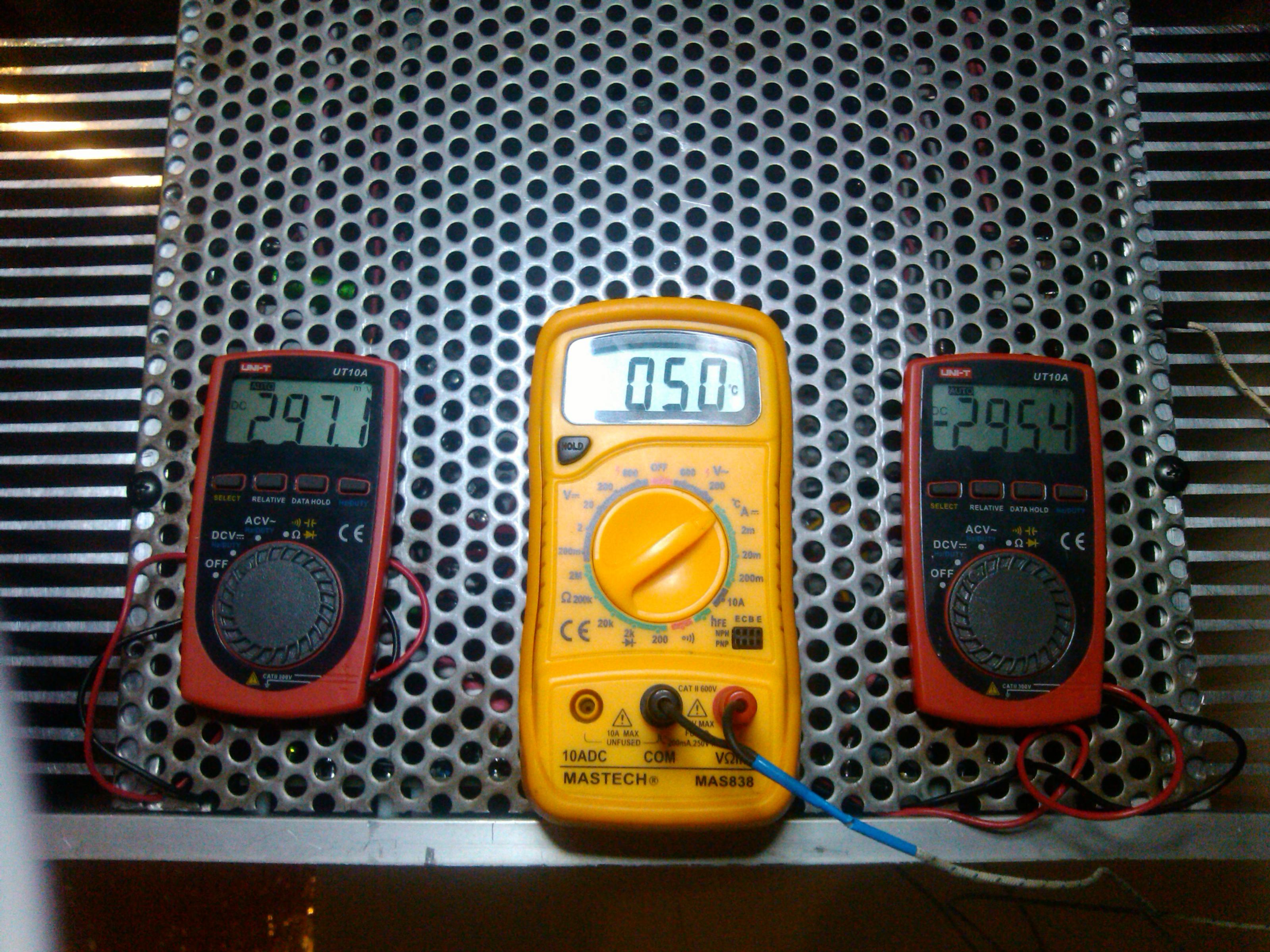

Here is my latest. Just in the process of biasing, and the faceplate needs to be straightened out, but that's just adjusting some screws..... the bias still wanders a little, and I think the noise I complained about now, is probably sloppy wiring.
Will show guts soon. The heatsinks are 2 pieces 10"x10" each side. There are 4 pairs per channel, and it's doing about 90 watts with 50 deg heatsinks.
