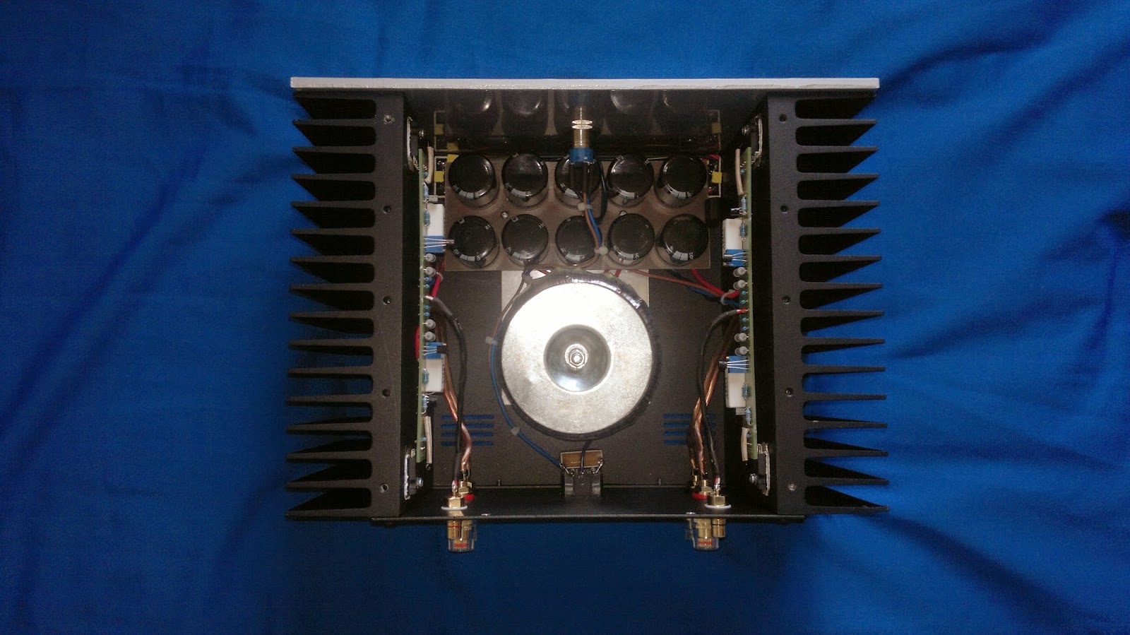

My jfet boz. Sounds amazing for an $18 build cost.

Very nice F5!
Thank you walter

Looks nice, but I'd be concerned about the small size of the heatsinks. Monitor their temperature closely. What bias voltage have you dialed in on those?
Thanks stijn001
The bias is about 1.1a , every time a biased my f5 amplifier to the 55deg/C of heatsink, in that way you keep your amplifiar in safe limit whatever your heatsink is (as far as i know Nelson Pass recommend something like that ).
By the why the pictures may be illusive but it has pretty tick heatsink 1.2cm tick wall with 6cm wings.
Thanks stijn001

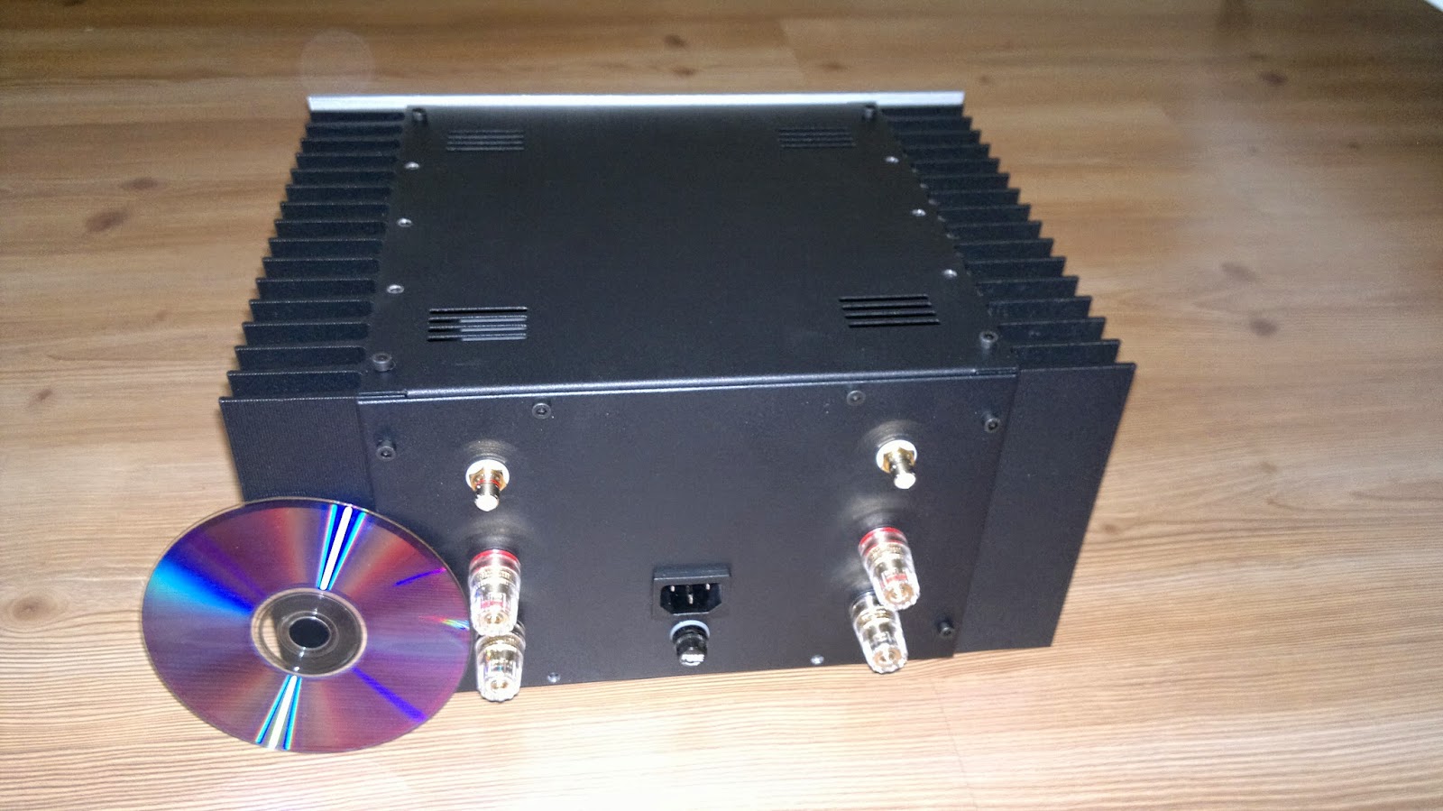

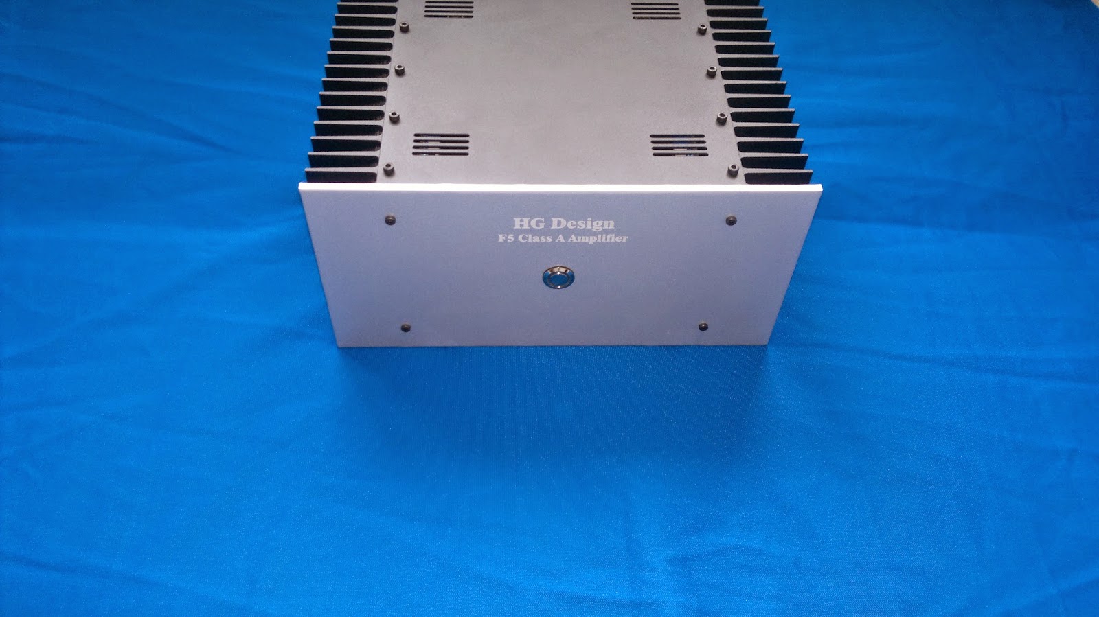

I think it was a radio transmitter made in Japan for radio stations ( there was a Japan brand on it) at the first glance i thought it was an amplifier but there was no RCA input and binding post at the rear panel only two BNC connectors anyway i bought it, when i opened it i saw 6pcs parallel power mosfet, a couple of hard wired coils , 3 or 4 small transistors, a handfull capacitors and very big transformars with 12v must be 300w.
I never pluged it in main supply, instantly i cleaned its inside , drew a front and rear panel in autocad and applied powder coat to them here was my new amplifier's case :)
Unfortunately i have never came accross something like that again in whole sellers electronic parts store in Turkey :(
in my opinion it was tailored for F5 amplifier , also it could be used as an monoblock apmlifier if there were two of them.
