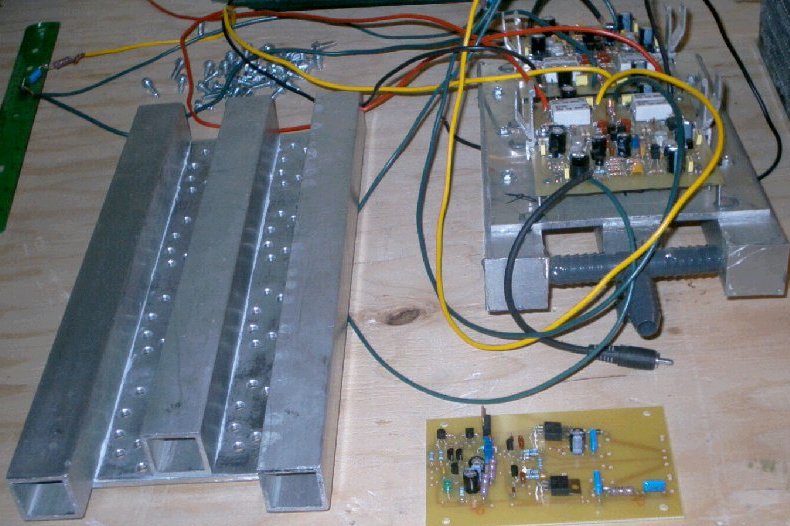

kilowatt - you saif you screwed the tubes together? Doesnt that leave a potential leak at every screw? Wy not weld it ?

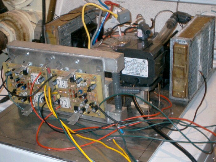

I was going to try something like this with an A75 amp a while back. Water pumps are noisy, so I was going to put the pump, heat exchangers, fans, and reservoir in a separate chassis and run hoses between the amp and the cooling system. Put the colling system chassis in another room, or hang it out a window. I figured I'd fill the thing with that weird flourescent green car radiator fluid and use clear tubing so it would look really neato. Like Reanimator!
I couldn't find a decent sized pump at a reasonable price (heatsinks are cheaper and quieter) even at surplus, so I decided against the whole idea. 500 gph seems excessive...

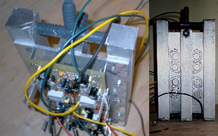

"you saif you screwed the tubes together? Doesnt that leave a potential leak at every screw? Wy not weld it ?" The screw holes are sealed with epoxy, so they should not leak. I could not weld it because I had no access to a TIG welder at the time I made the block (I do now because school has started again).
"I couldn't find a decent sized pump at a reasonable price" I got my 500gph pump at Petsmart. It was $50, and it's pretty quiet. Large heatsinks can cost more than that.

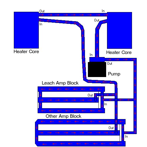

Kilowatt said:I haven't worked on the amp for awhile (but I bet no one missed me ), I have been doing other electric stuff (high voltage pulsed power), sort of a much-needed vacation from audio and amp bulding, but I will get back to it some now and hope to have all channels of the amp running within an month's time (but maybe that's a bit optomistic).
"high voltage pulsed power?" Sounds like a Tesla Coil or a Marx Generator. or even a "quarter crusher." I've been meaning to finish "Project Groucho, which sits about 95% done on the floor behind me.....
Back to the topic at hand. I remember seeing your "cooling schematic" a month ago, but it didn't hit me until now.... With one pump and two aqua sinks in parallel can lead to some heat problems. The water will tend to flow through the sink with the least resistance to the flow. All things being equal, that's the one with the shorter path. Electrical analogy: with two resistors in parallel, the current favors the lower resistance (executive summary ). Therefore, the larger sink will run hotter than the smaller one. It probably won't be a problem unless you're attempting to drive a 2-ohm sub to clipping all day long or are using an exceptionally healthy bias.
To fix it, the easiest option, IMHO, is to add a small ball valve on the smaller sink. Yes, another leak point, but you wouldn't want one amp to overheat while the other remains cool....

Anyway, back to the subject, I have thought about that, but wasn't sure if it would be a problem. Maybe I will have to add a valve to each block to control the flow rate. Yes, that's what I'll do. Because I actually do want 2 of the modified p3a channels on the big block to be able to drive 2ohms.
