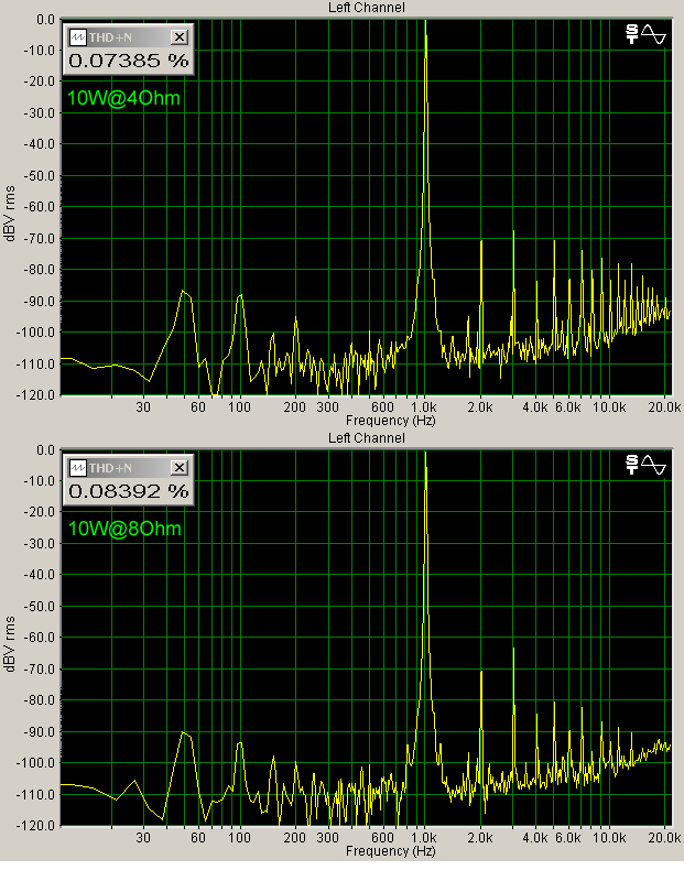

I tried to short cicuit output. OCP protection works. After a delay all will start normally. For test i use supply voltage +-25v and 100v mosfets.
I have tried to measure parameters of a sound card in Spectralab (direct output to input). And it have only 81db SNR and THD=0.008% (SB Live 5.1). Parameters of the amplifier I shall try to measure today.
