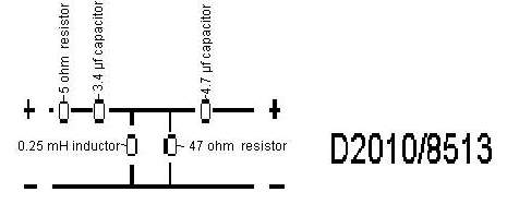

Swede: If I understand you correct then you just have switched the cable between the amp and biwire terminal at the speakers so that you place the + cable from the amp in the - on the terminal etc.
I am not sure that this is how jacq explain the polarity issue or at least it's not how I have understood it. Though I could be wrong or perhaps I just have misunderstood you. I will attach a little drawing that shows how I have understood the polarity issue because that's easier than explaning.
Now I have been reading another place about the polarity issue and gotten even more confused. I thought I had it right but now I don't know. If someone please could common on the drawing I have attached at my earlier post. I am thinking about the + and - in both ends and the layout of the parts in the xo.

Seve
From your drawing, change the left hand side +ve & -ve around (+ve on bottom and -ve on top) . And use Jacq's crossover modifications.

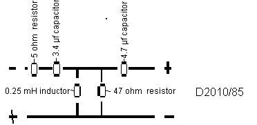

Thanks a lot for clearing up my confussion. Also a thanks for you making this speaker possible by your homepage.
I am planing to use the modified xo by jecq, but it's only the woofer part that is modified is it not?
I will attach the tweeter again to be totally sure that I am right this time

Saci

I think it is time to start building the speaker before your mental energy is totally wasted. Jacq says to modify the woofer crossover, have you read the website.
Sorry guys I am not trying to be rude. We will try to make the website clearer for some, but most people find it OK to follow.

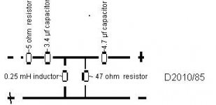

Yes I have read your homepage about the proac clone. I have actually read it many times. Overall I like it very much it gives you some ideas about how to start the project though If I was you I would be more precis about the tweeter placement(thinking about the difference in the cad and text) and also would I explain the polarity issue better. The things I would change if I was you is mentioned because they would be helpful to me but others could find them not necessary.
I could probably have started earlier building the speaker but because my knowledge level about DIY speakers is rather limited I wanted to be sure I understood everything before doing something stupid. It is simply because I want to be sure I hope I have not annoyed you to much.
The reason why I asked about if the woofer was the only to be modified was because of your earlier post where you commented my drawing and said to use the modified xo and I was not sure if you were refering to some changes I did not know about in the tweeter or just the well known woofer modifications. Now I know.....thanks.
Seve
