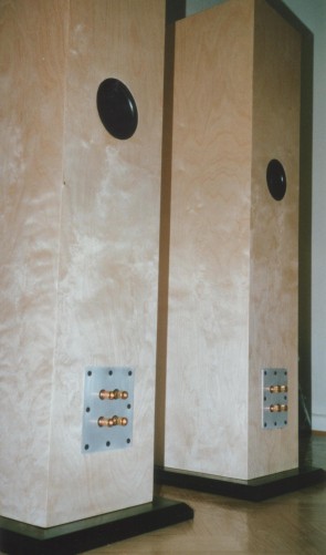

Hi, I just thought I post some pics of my recently finished proac 2.5 “clones”.
They have now been playing for about a month. The sound is everything I expected it to be. I used the crossover from the diy proac site (http://www.geocities.com/diyproac25) with the suggested modifications. Can't say I can notice any 2khz peek.

And how about some internal pictures?

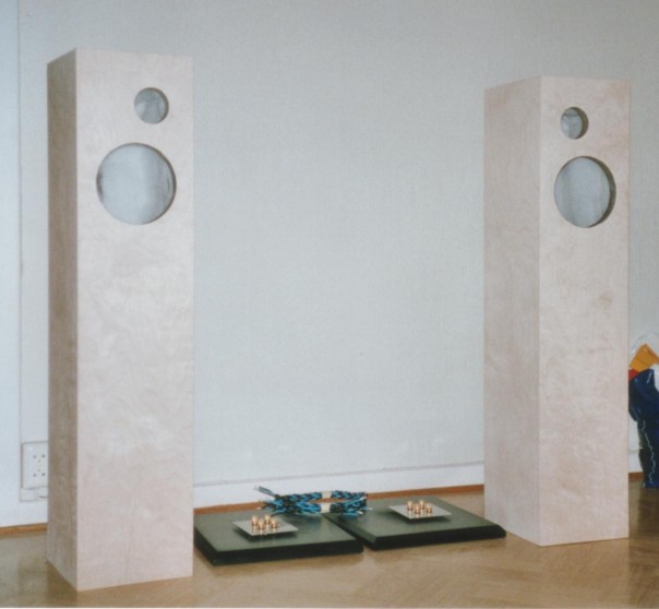

The last picture I have is before the tree coats of lacquer. Sorry, I don’t have a digital camera, and these are the only pics I got.

The veneer is birch. I got it locally, at first it was a pain to get it, not many sell veneer over her. Then someone at a norwegian forum mentioned a veneering factory in oslo, and it turned out to be only “a pitch of a stone” from where I live. So I went there and picked it out myself, got a really good deal, only 150 NOK (20$) for 4 sheets of 2400mm * 500mm. I got plenty of leftovers for other projects. :)

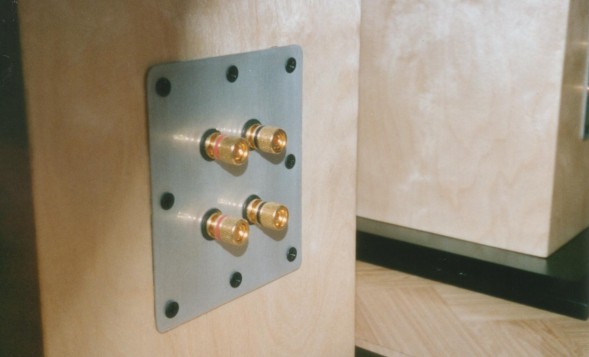

Really great looking speakers you have made. I really like the idea about the binding posts! Perhaps I will use that idea when I get around to building a pair myself. I am in the planing proces at the moment and have been there for a while now, but sooner or later I will get around to building them.....I hope.

bbaker6212,
I made the aluminum plates myself. They are 1,5 mm thick 110mm * 125mm big. I wet sanded them with 320 grit paper and applied 3 layers of clear acrylic lacquer.

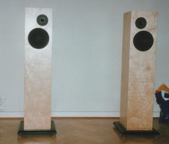

Me and UrSv have finished our projects as well. Urban is still waiting for his luxuary filter parts, though he is on vacation for a couple of days now, and cannot build anything for the moment anyways.
Here is one picture of our speakers:
Here is another picture:
You can look at our whole project at:
http://www.skip.informatik.gu.se/~kmg/diyaudio/projects/proac2.5/
We tried to document everything as much as we could.
