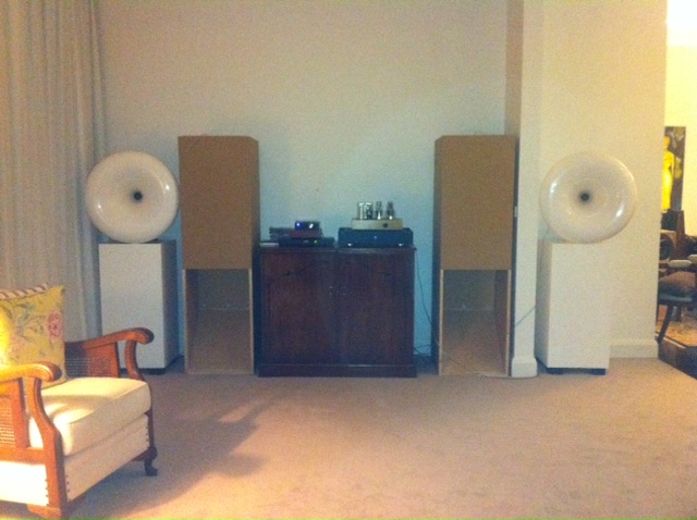

Ray, I tested my horns with 50Hz xover point (30db slope) today and no subs. The bass was still very good. You could almost have this as a great two-way system. I'll be running some recordings soon.
Oh,and this was without the large horn mouth extenion pieces added. The mouth, therefore, is 41cm x 70cm.
I've also moved the Azura's back on top of the subs...this gives a wider sound stage...and a more sensible look.
Certainly presents a massive wall of sound...very good.
