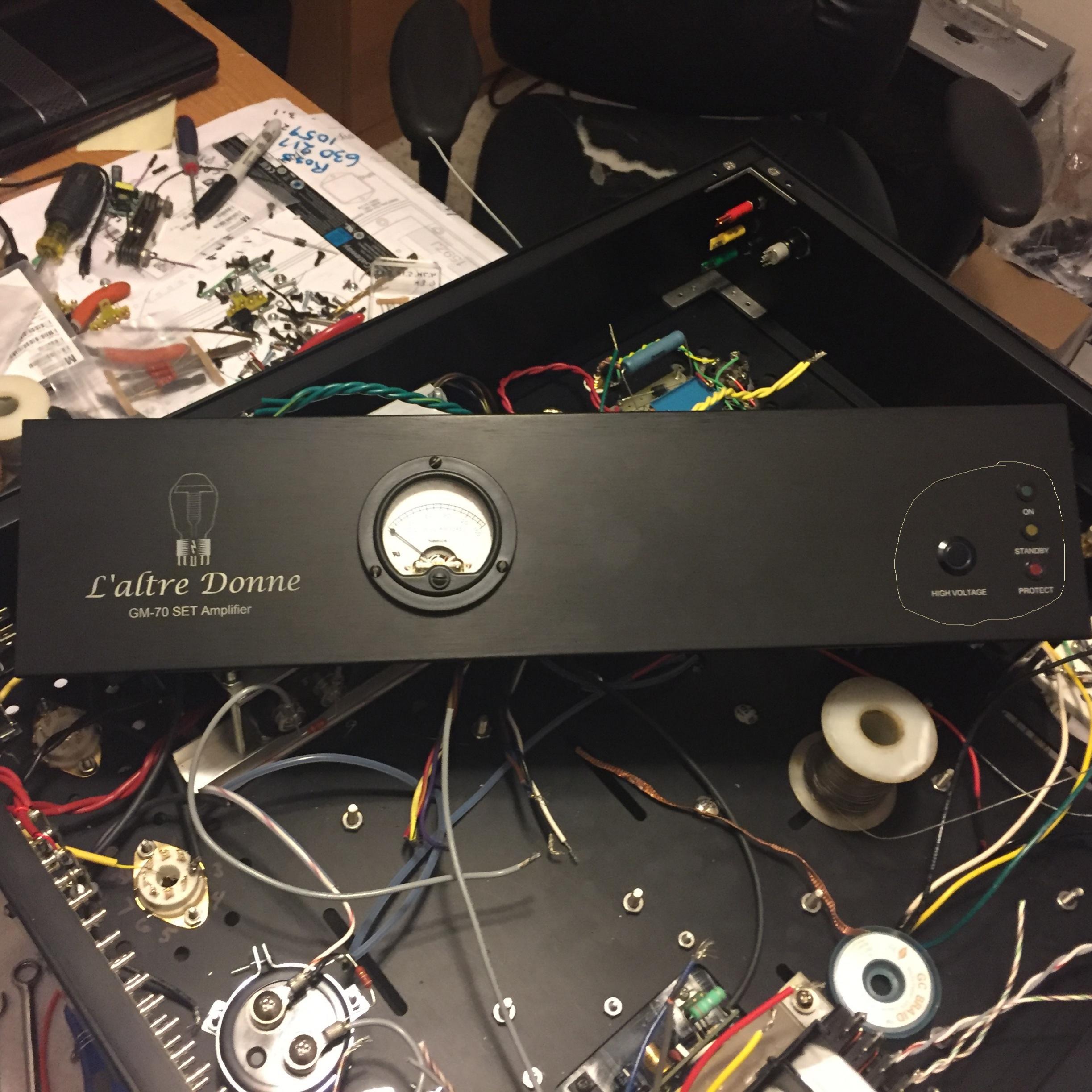

Looks good at first glance except for a missing LED
StatusLED is really a fault only LED
I have an LED within the power button that needs to turn on after the last Relay is energized.
Take a look at the pictures below
The ON LED is tied to the Arduino power power supply. It's just status for the rear power switch and amp is ready to energize.I misunderstood. I thought you had 2 LEDs. So you have a total of 4 LEDs? I'll separate the protection led functions from the high voltage led. When do you want the ON LED to turn on?
Standby LED comes on when pushbutton is closed and sequence started, it turns off when last relay is energized.
ProtectLED is just for power issues, high voltage sensor and any faults (may add future current or temp monitoring). If this LED is on, all others should be off. The number of blinks could be programmed to indicate the fault type.
HighvoltageLED (inside of power switch) tells me that last relay is energized and high voltage is on. If fault occurs or pushbutton is opened, this LED should turn off

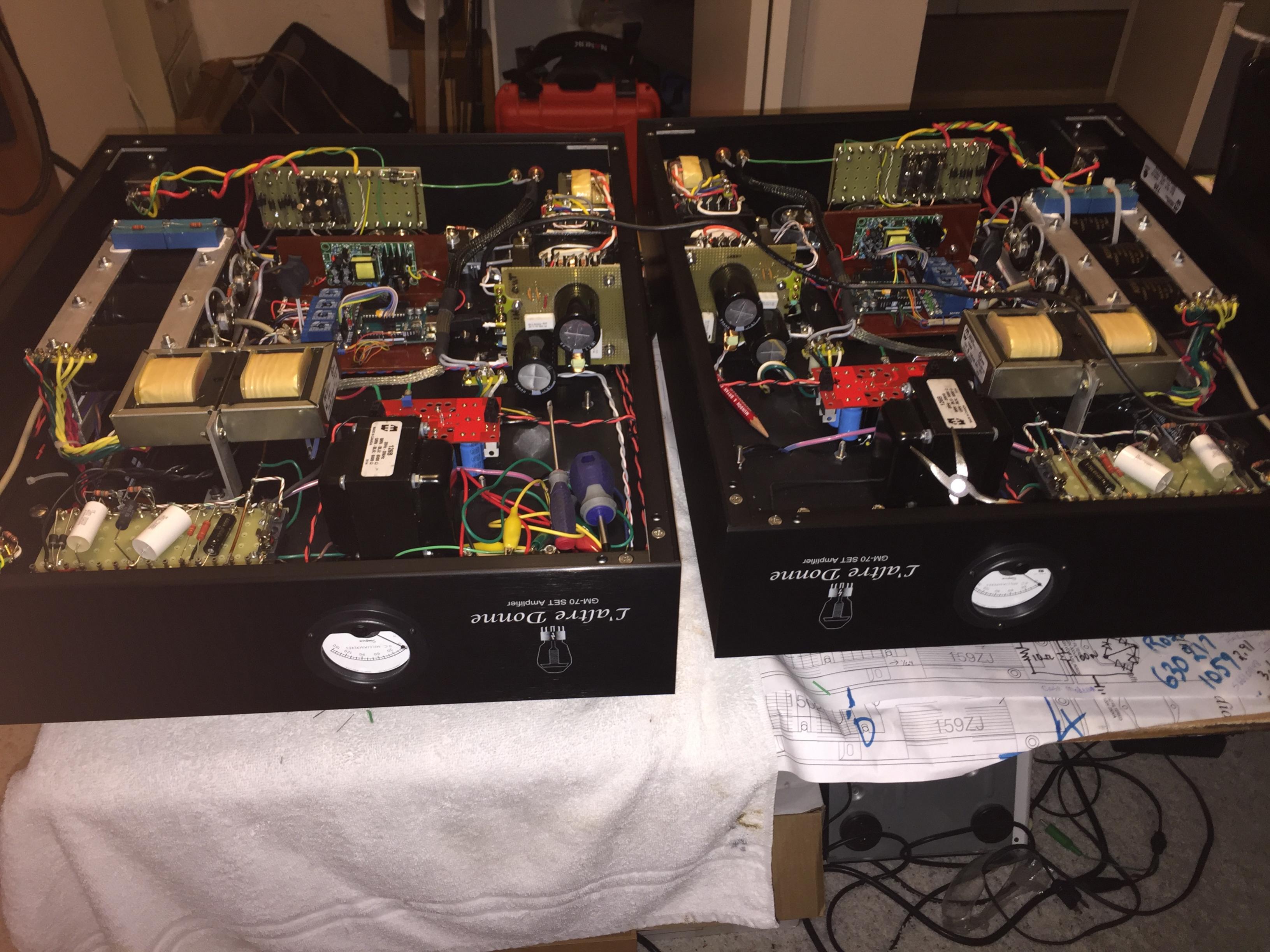

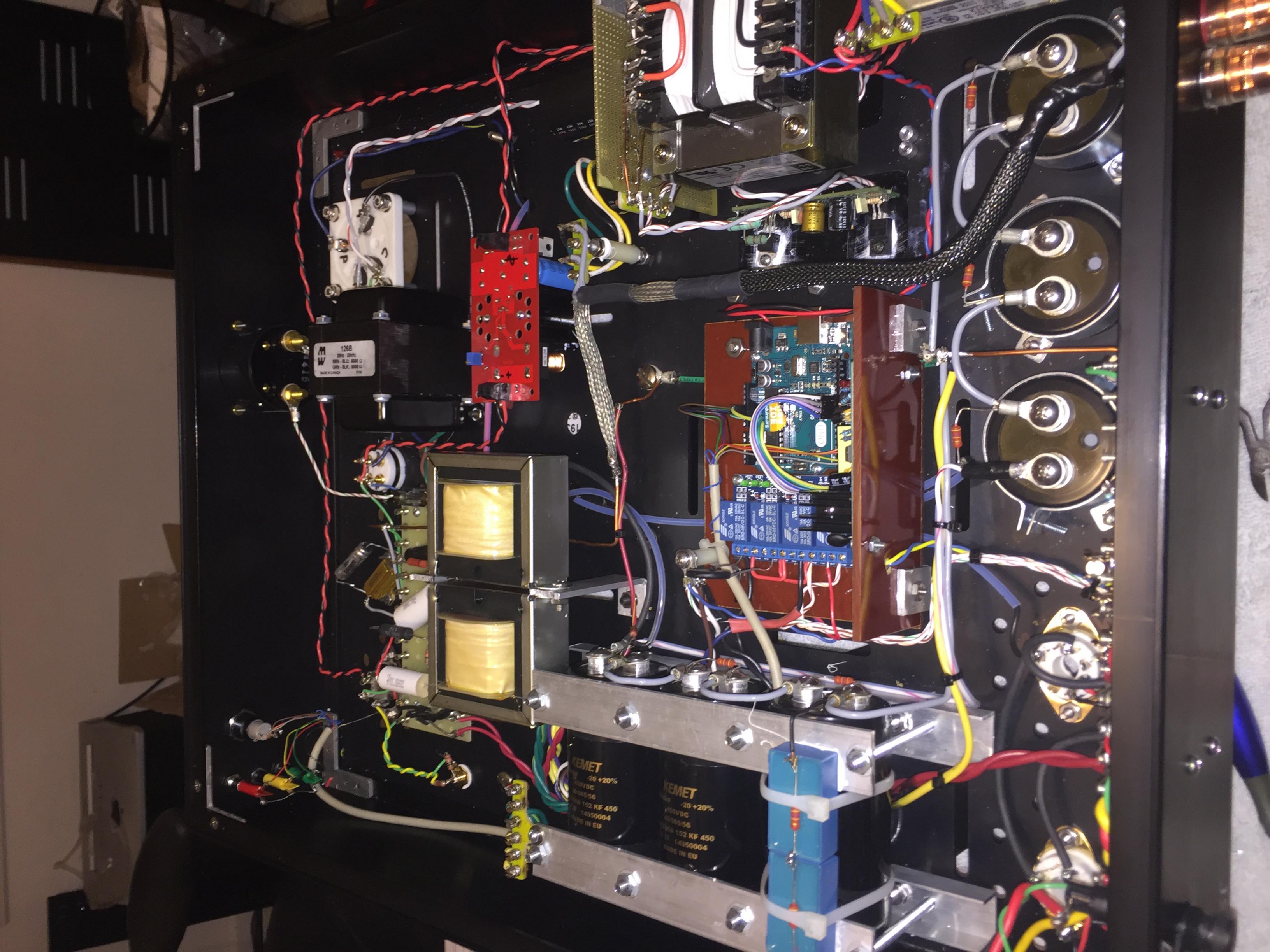

The amp looks great upside down. How about some pictures of it upright?
I'm currently doing some physical therapy on my shoulder and trying to avoid re-injury....
I might get some help this weekend to move these out for some real listening tests.
Also waiting on a couple caps to lower the voltage on the B+ rail.
Right now its about 1225 volts, I need it closer to 1100-1150v. A 5v variation on the primary could easily send this closer to 1300volts!
