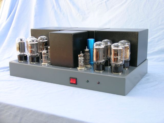

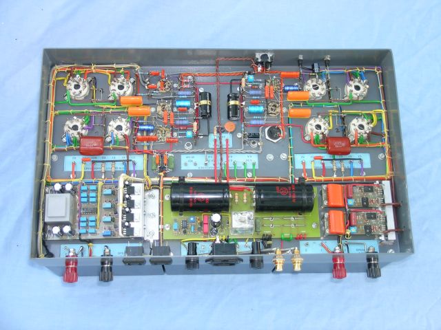

Most excellent! I love your fabrications; its inspiring.
Where did you get the raw silicon for those mounts? That is a clever idea. I have only used the silicon caulk before to mount caps in my amps, but it doesn't look half as planned. I had gotten that idea when I looked inside a Blue Circle BC3 Galatea preamp.
Gerrit,
Thank you very much for the compliment.
The silicone rubber is the kind used for making plaster casting molds. I got it at a DIY store but you can probably get it in any art supply store. Beware that it is pretty expensive (€50/Kg) and tricky to work with. The two components have to be mixed in exactly the right amount and it settles within 10 minutes, so be carefull not to mix too much at once.
BTW,
The copper heatsinks look much better than they work. The one I had planned for the HEXFET in the high voltage regulator was not good enough, I ended up using a normal aluminium heatsink (Fisher).

gertk said:And this is the finished version
These amplifiers have been running for several hours without problems.

After browsing this thread (which takes a while) I'm glad to be able to post something different.
'Impressive' doesn't say enough in this case. Wow!!
Simon
Thank you, thank you,
If you would like a closer look and listen, you're hereby invited. Maastricht is not that far.
I put a lot of time and effort into these amps as it is not my intention to build 'one amplifier after the other'. The next project is building a set of Replikon BL horns for the Fostex drivers.

I checked the schematic and that's really something.... only saw that level of simplicity on high gm tube spuds. How much voltage swing do you need to feed the input trafo for full output?
Simon
+28dBu or about 19V for 6.2W and the source has to be very low impedance. This definitely will not work with normal preamps but most 'pro' gear (like the Benchmark DAC1) can deliver that kind of signal. A lot of people think the high output level of the DAC1 is a problem, I made full use of it. The LL7905 can be wired in several modes (1:2.8 , 1:5.6 , 1:11.2) I use 1:2.8. The secondary can be used as a phase splitter so it can also be used to create a minimalistic push-pull configuration.
