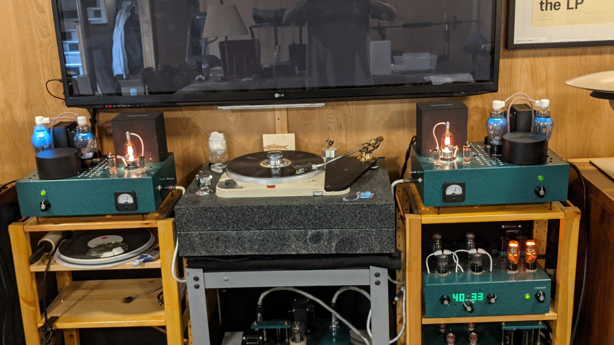

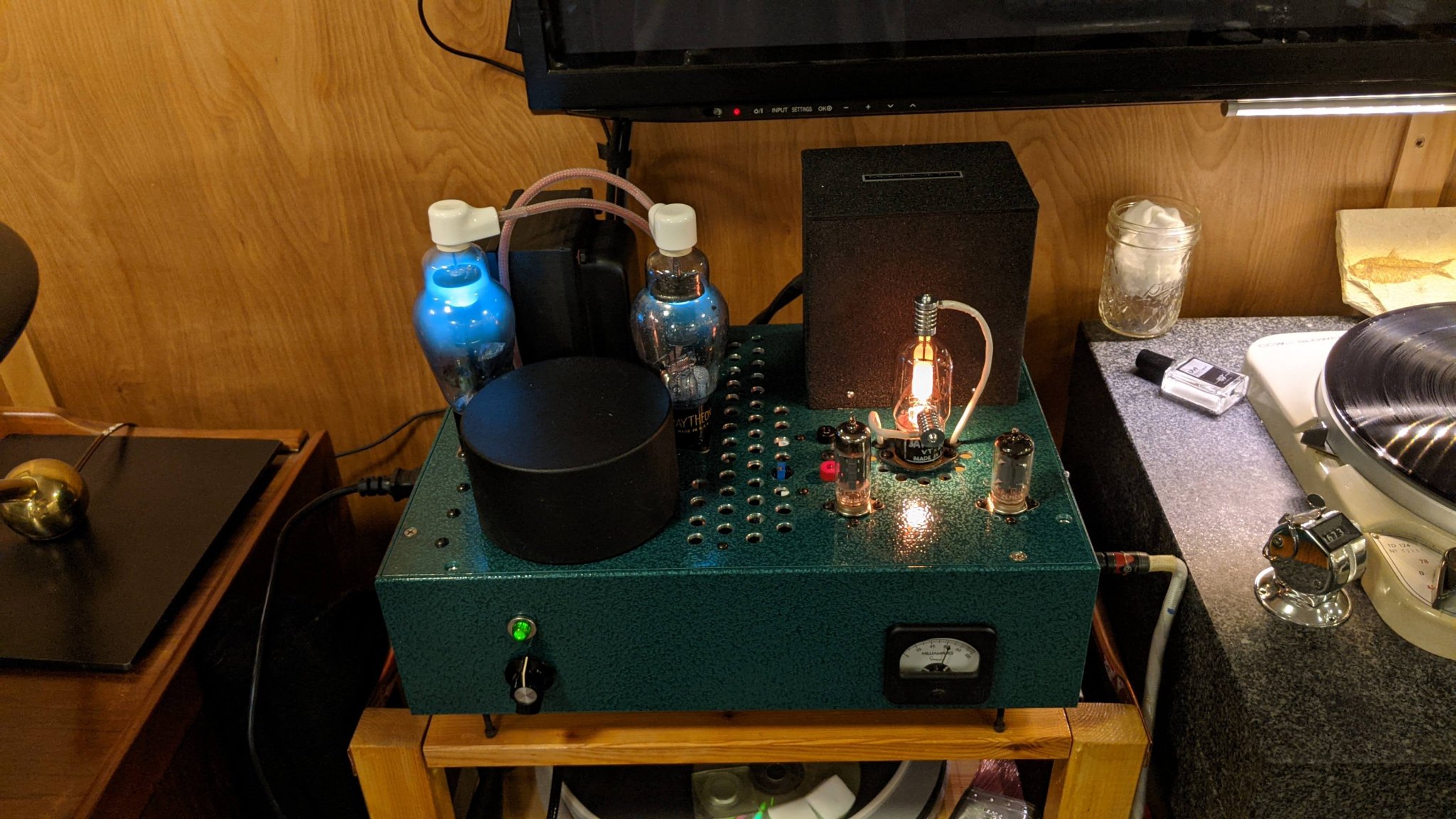

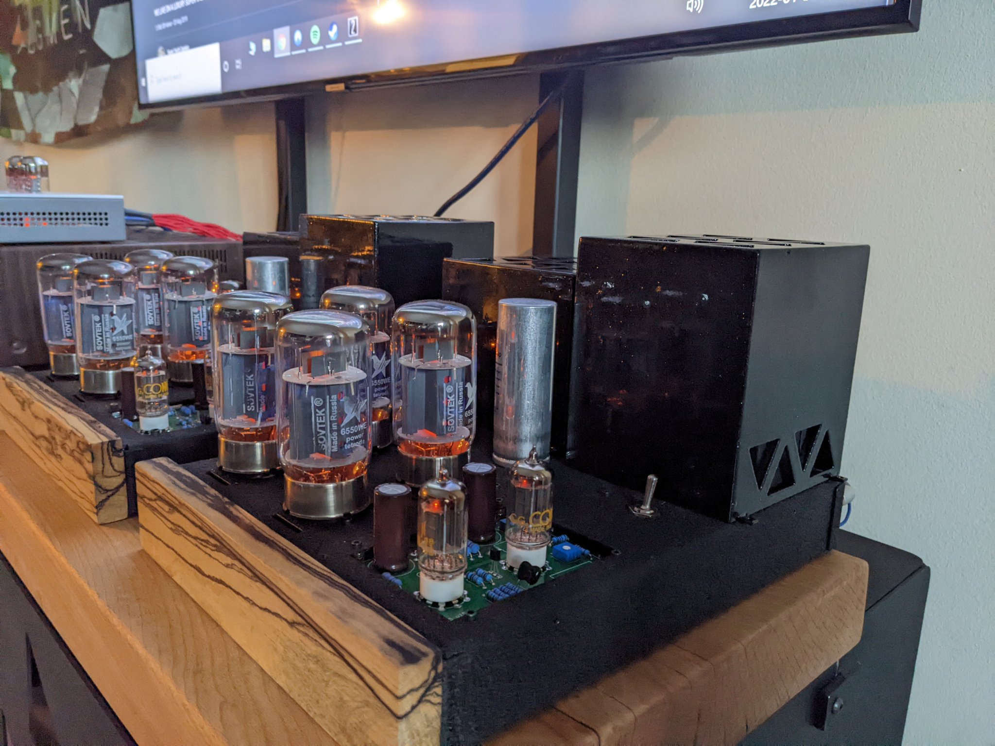

Yes. I have some Pyrex "chimneys" I'll be installing as soon as some threaded rod shows up. I'll post another pic in a day or so. Besides, my dogs are short and I don't like my kids.extremely cool setup but aren't you afraid of freak accidents with those open anode caps?
Nice XDYes. I have some Pyrex "chimneys" I'll be installing as soon as some threaded rod shows up. I'll post another pic in a day or so. Besides, my dogs are short and I don't like my kids.

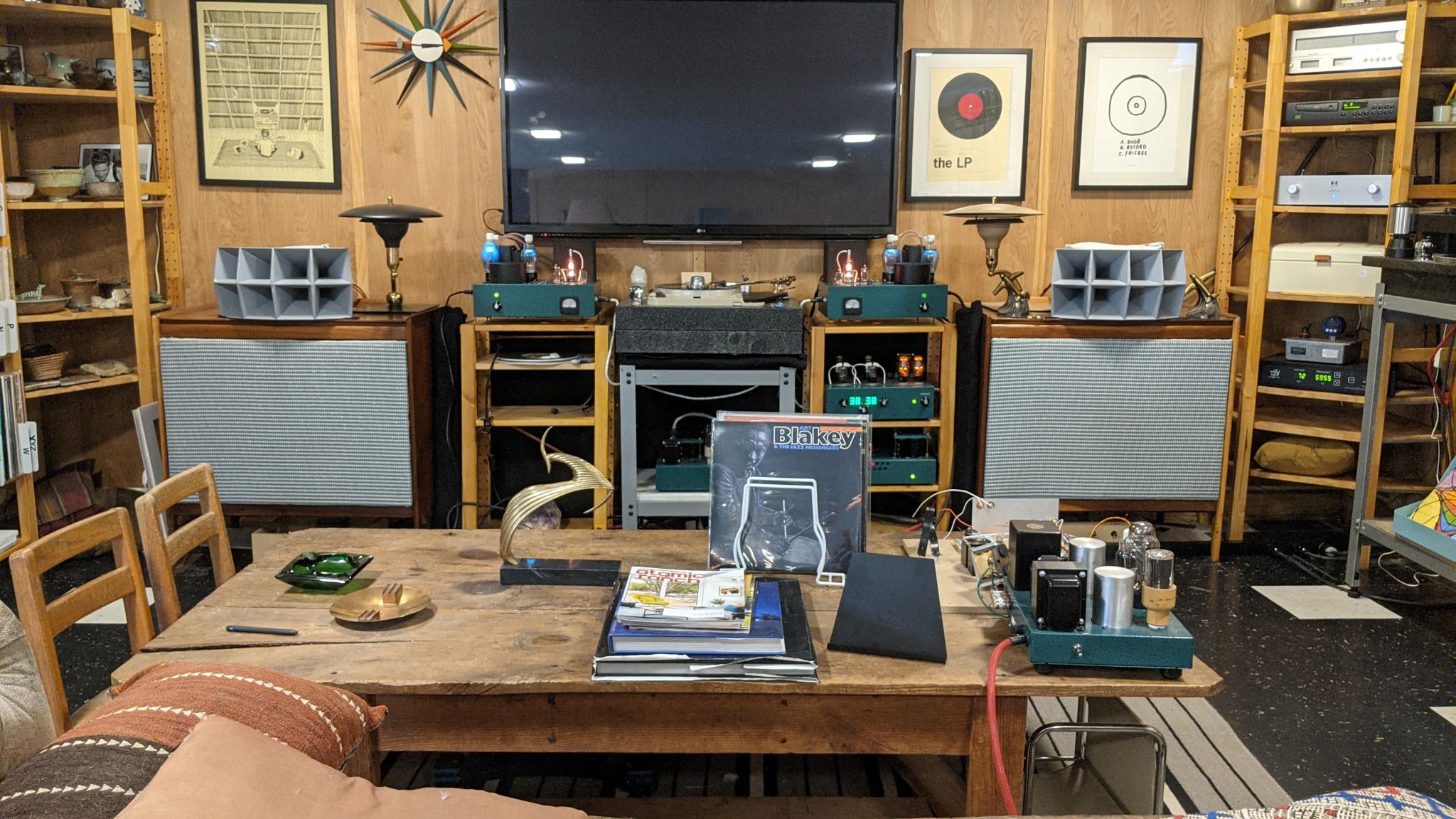

I do believe we had a conversation about this going wayyyy back... love the Mid-Century Modern thing you have going, but just not feeling it from the two UFO lamps. Suggestion is to send me everything from fish to speakers to Garrard to amplifiers (including the tuner on the shelf) to antelope to bookends (nice!) and clock -- I will dispose of it all in an environmentally safe manner. You can keep the lamps and flat panel as a new starting point.
All kidding aside, I like how the green hammer tone pant, the mirrored builds, and Simpson ammeters just work so well together and adds to an already impressive build.
I really appreciate your comments!I do believe we had a conversation about this going wayyyy back... love the Mid-Century Modern thing you have going, but just not feeling it from the two UFO lamps. Suggestion is to send me everything from fish to speakers to Garrard to amplifiers (including the tuner on the shelf) to antelope to bookends (nice!) and clock -- I will dispose of it all in an environmentally safe manner. You can keep the lamps and flat panel as a new starting point.

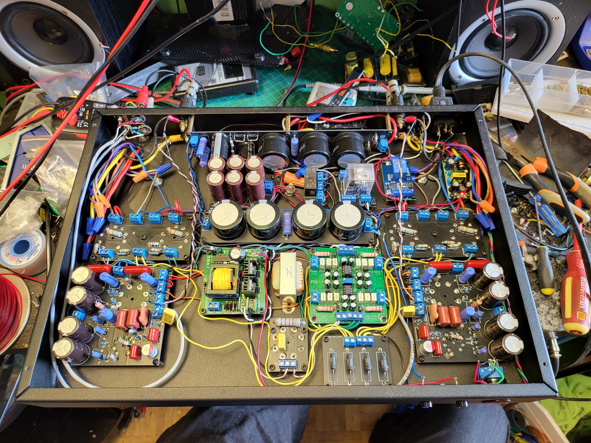

I finally bothered to finish the 6P36S rebuild... I swapped the cathode leads on t he right channel and had 500mA going through the tube but quickly fixed that and so far so good

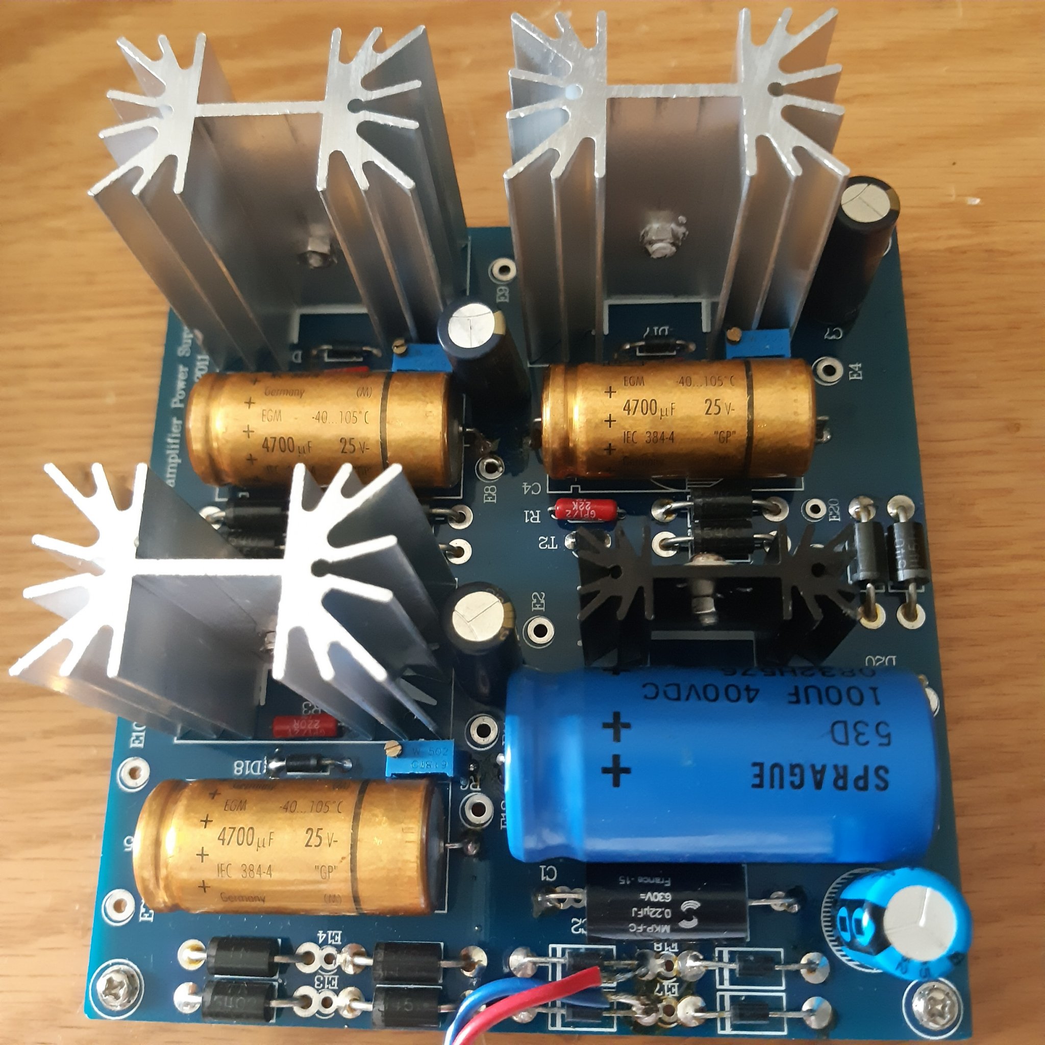

This one is using ~ 1k3:8R for output ratio and linear unregulated supply for 12V using 9V-0V-9V FW into MBR6045 diode into 6x15000uF UCC LBV caps (it's about 11.6V I think). HV comes from my typical dblquad board.

Great modular design! 1.3k is quite low, what B+ are you using?I finally bothered to finish the 6P36S rebuild... I swapped the cathode leads on t he right channel and had 500mA going through the tube but quickly fixed that and so far so good

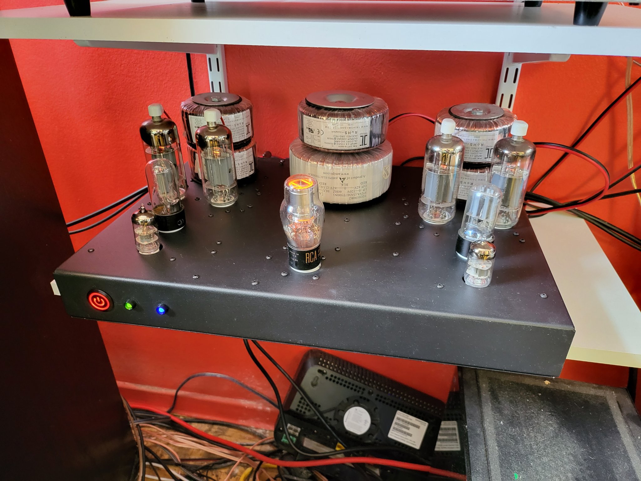

Soon I will finish my new tube headphone amp - my first headamp with output transformers! I call it CFPPHA
as "cathode feedback push pull headphone amp"
Its very small, just 18x13x4,5cm stainless steel laser-cut chassis, and very simple... ECC803S diff stage with TL431+2N5551 CCS as input and fixed biased ECC802S as PP class A output with 12% cathode winding. Apart local nfb, it has also 10dB of global negative feedback. It contains also MOS+LM317 regulated +220V and LM337 slow turn on -25,5V PSU all in one PCB! Internals:
Output power is ~0,1-0,5W RMS into 32R or 250R outputs. Output transformers are of my own design and winded on order. They consists of 4 series primaries sections, 2 parallel tapped secondaries and 3 paralel balanced cathode windings. Primaries+cathode windings together results as 21k "Raa-Rkk" load. Its relative "big" silicon grade oriented steel cores EI60/21, go as far as 3Hz -3dB!

But anyway : a very nice piece of workmanship!!Nicely done!
I love the chrome finish but I know from experience I only love it for a couple of days before it becomes a dusting nightmare LOL
