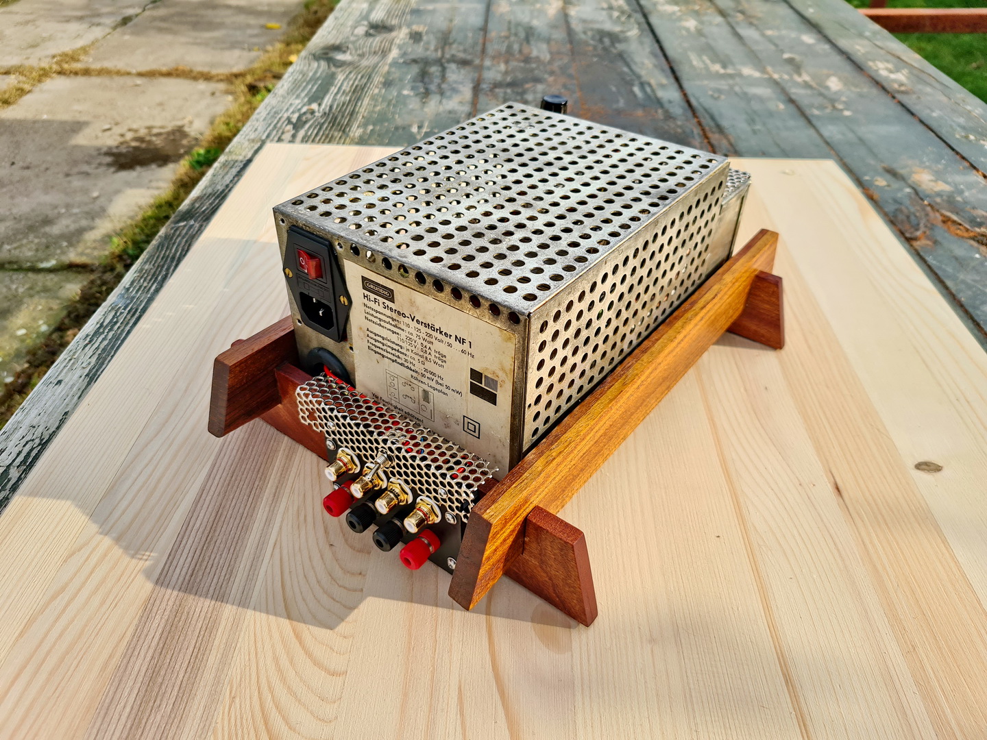

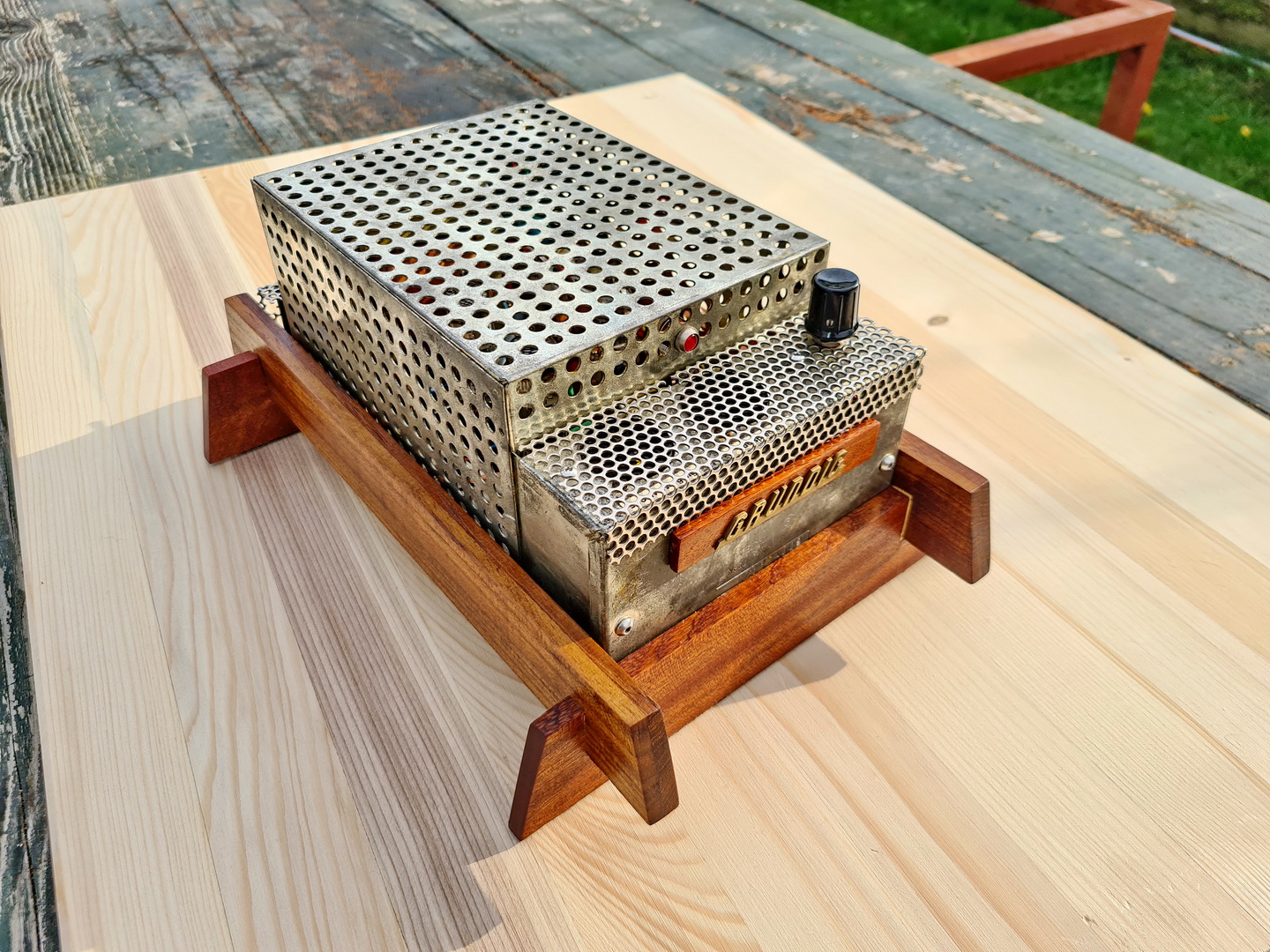

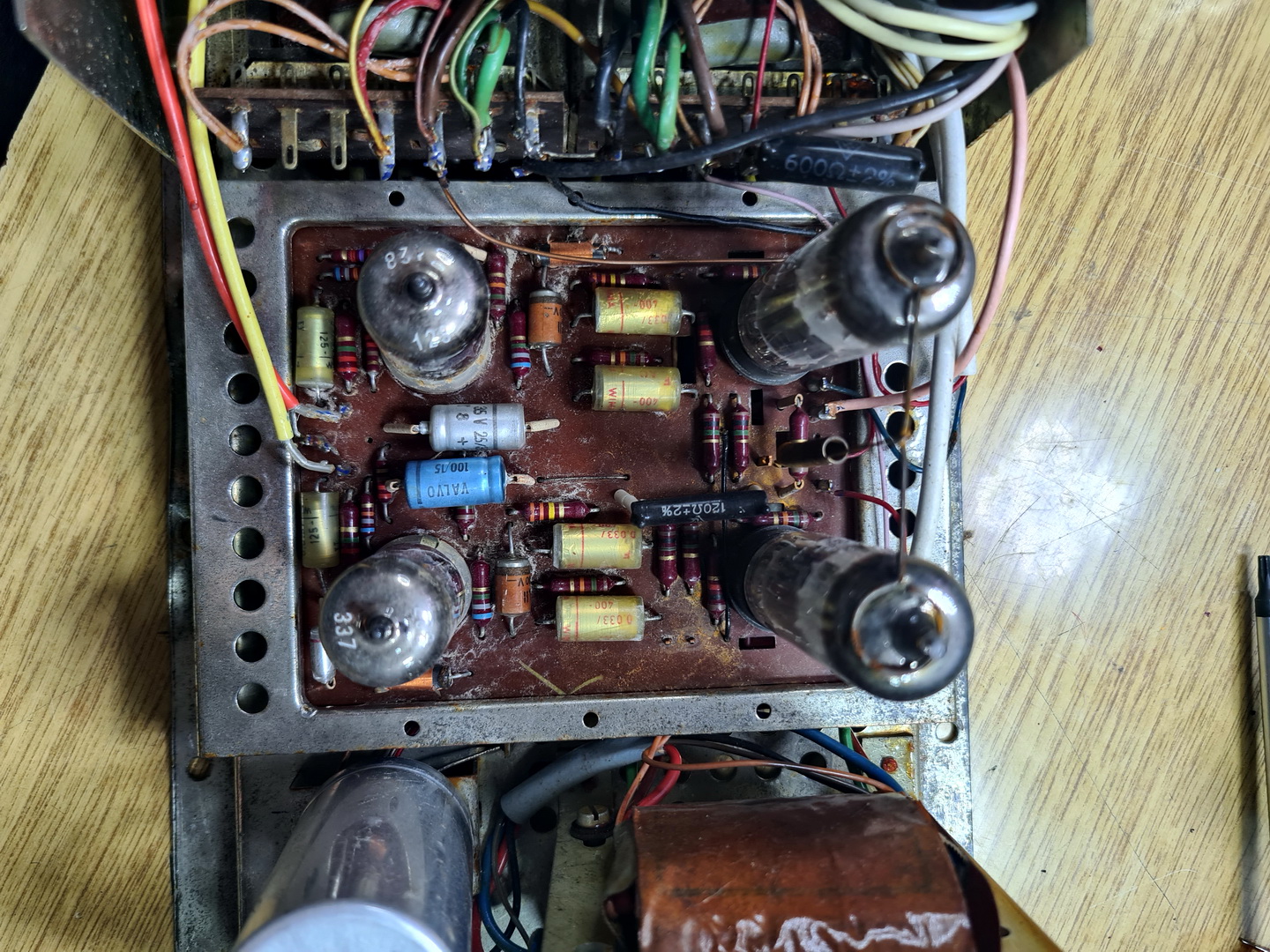

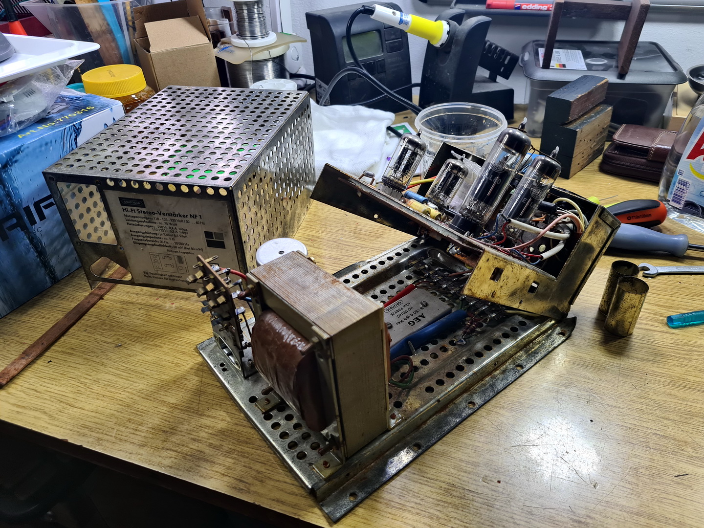

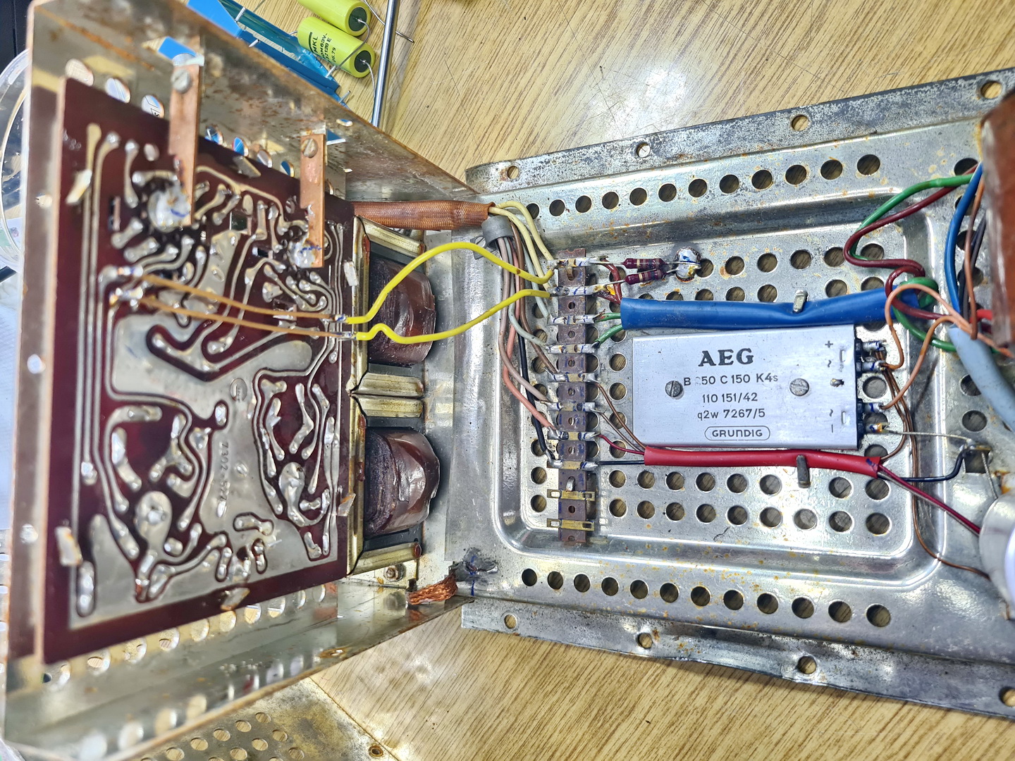

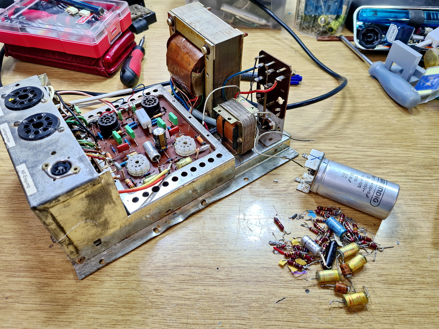

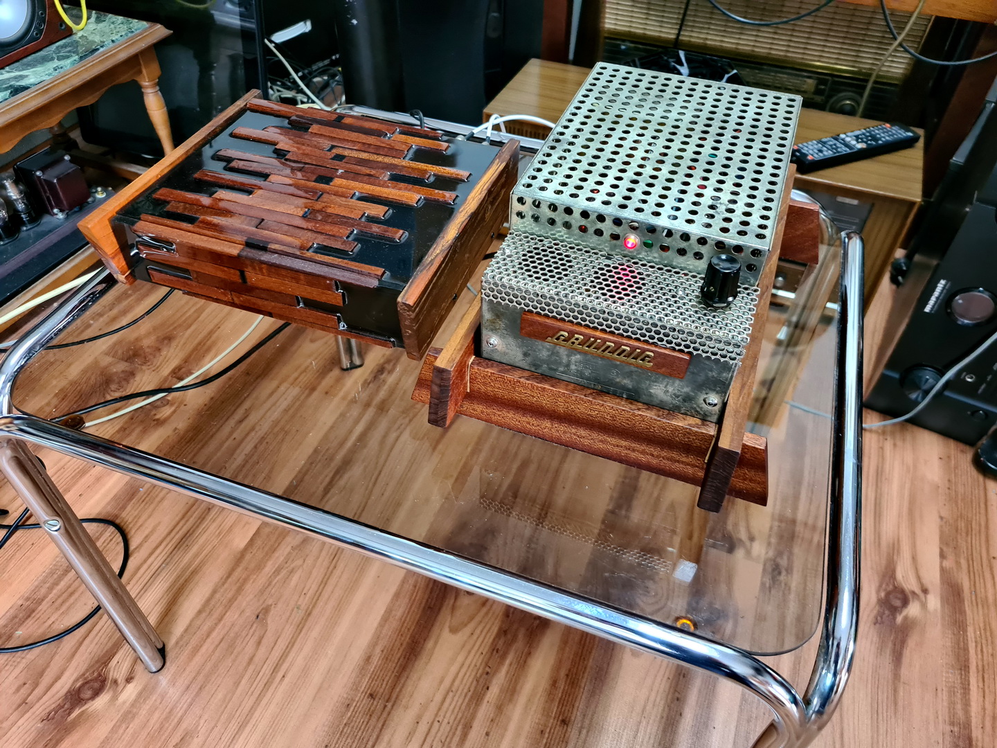

recently got my hands on a Grundig NF1 chassis with valves still inside... changed all the resistors and capacitors, and removed the big can that was so dry it rattles, and had to put small 12V transformer in series with mains transformer primary to lower the voltage to 220V (sadly the mains transformer doesnt have a 230V winding, so this was a solution to avoid big resistors and added heat)... checked the voltages, all OK, got the filament voltage 6.4V , and was surprised to measure 23mA per section on ELL80`s... it sounded so nice that I decided to make a docking station for it, and here it is - over 60 yrs old, and playing ... a Grundig NF1 tribute to, sortof

Just a word of warning, you should replace your rectifier bridge as they have a tendency to break it can then destroy your amplifier. Otherwise, it is a fun concept to use older tube amplifiers like this.
thank you ppl .... and for selenium rectifier - yes, it will be removed in "second wave" , just need to take care of voltage drop... this happened to be a pick from the local ads, and well deserved to play again... it has a very nice and soft sound, not hifi as we all agree on, but nice, very clear mid/high and well defined but not too deep bass... but as a allrounder for playing music in the background, surely make me turn my head toward the speakers every now and then, surprises me with clarity.... and it came with all the tubes, and I must say that two ECC83s were Telefunken so they instantly ended in the secure drawer, and some nice Siemens were put in. ELL80s are Lorenz, with almost full emission (whick also surprised me), I was ready to make a ELL80--> double EL95 adaptor but for now, no need.

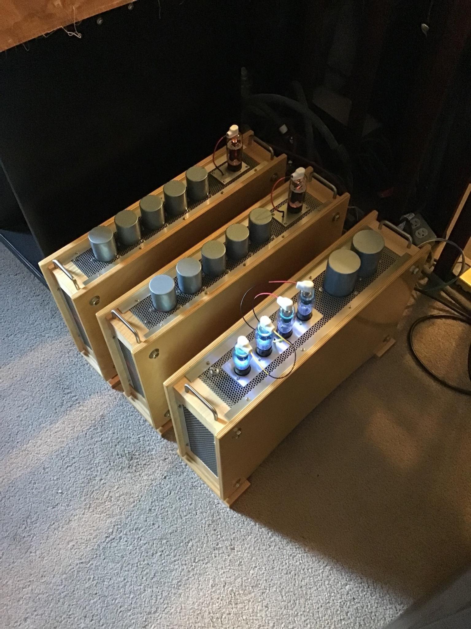

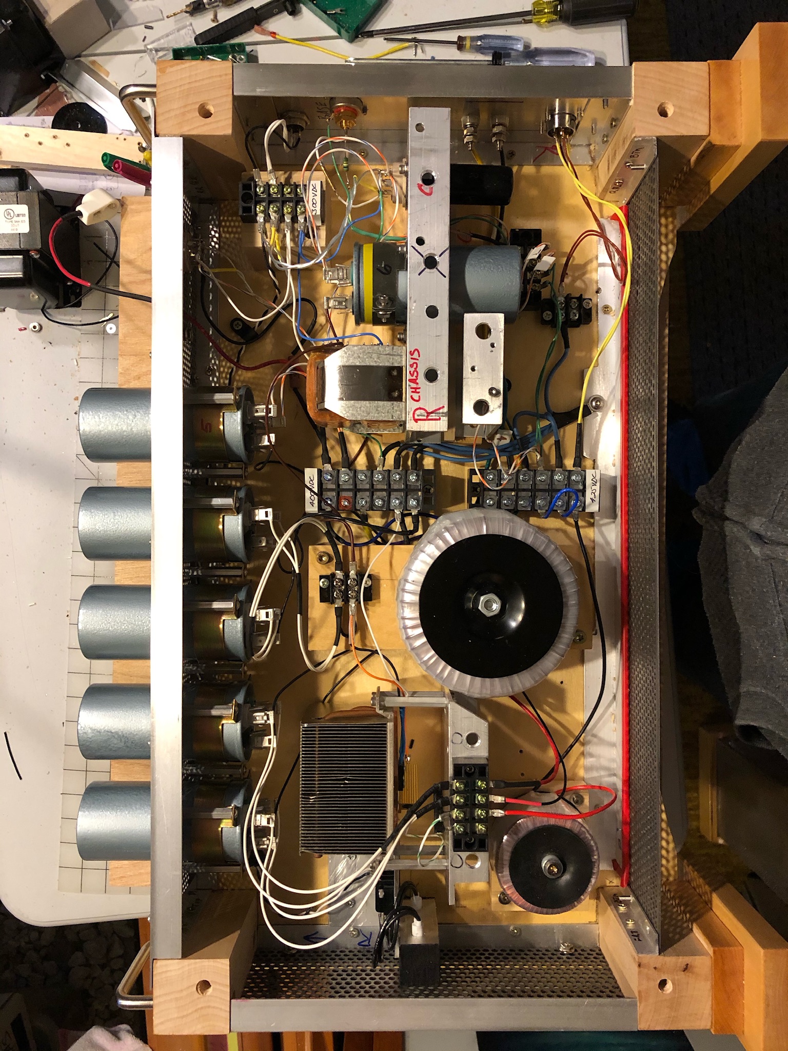

My MA-1 - 12GT5 amp can be push pull at 30W or SE at 3W just by pulling a tube on each channel apparently ** For those tho are watching the "misbalance of toroidal output transformers", my interleave in in play here (two coils under the covers, two more in the chassis underneath) and there's a 60mA misbalance.
Yes the house is dusty. This is dust after 2 weeks. (they are building several new buildings within 50m of here and I have the window open)

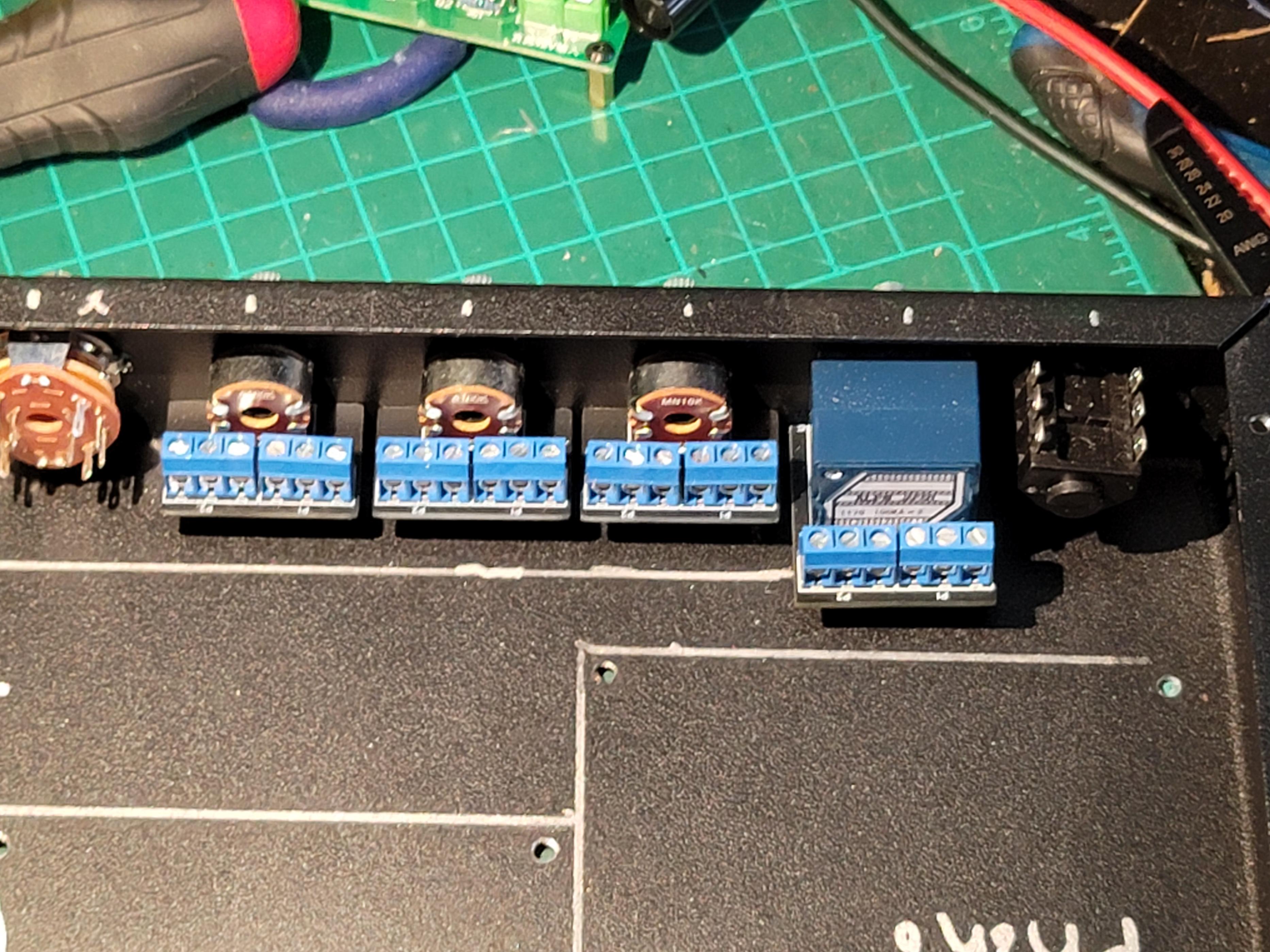

Interesting project for sure! That's a lovely lot of inputs and outputs. Personally I'd ditch the breakout boards or use a different connector on them, because screw terminals can crush these delicate shielded wires breaking the contact.

I don't use delicate shielded wire - I just use RG174 and tin it,,,

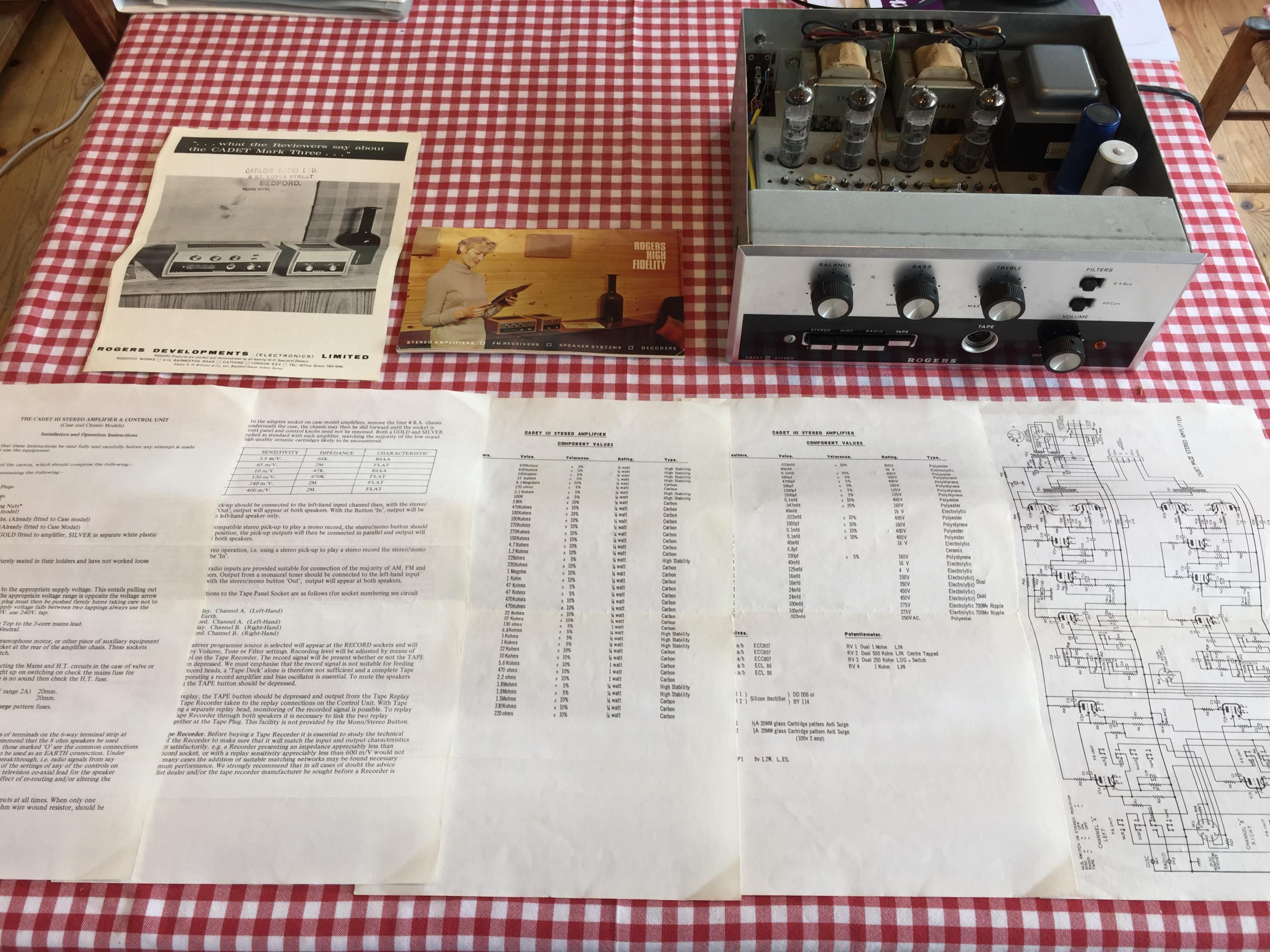

Just found this beautiful, completely original, Rogers Cadet III Integrated Amplifier which is complete with all the original documentation.
It is completely original as supplied by Rogers back in the 1960's.
It is fitted with the gold PU Cartridge.
It had one owner from new who bought it from the local HiFi shop in Bedford, England. I purchased it from them. I have no wooden case (sleeve) as it was integrated into another piece of furniture.
I have all the original Rogers Documentation including Owners Manual, Rogers Brochure, Copies of reviews from 1960's publications. Documentation includes Circuit Diagram and a list of all the components and their values.
