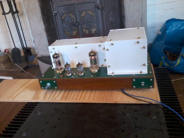

Thanks. Oh, and a few remarks about this amp. This was an excercise in making things simple and relatively cheap, but still maintaining a pleasant listen.
This whole thing got started when an editor in chief of a local audio webzine asked me how simple a tube amp could be made. I provided him with a schematic of a spud I'd made some time ago with just a E55L per channel. When he asked if I could make an article of the design, I declined telling it wasn't a real world amplifier, more of a curiosity and a study on simplicity. But then I couldn't resist going a little bit further, taking things from "as simple as possible" to "as simple as is meaningful". That's where this amp started
But back to the amp itself. Not much to point out, though, it's an EL84 SE-amp on a PCB. The OPT's are Hammond 125DSE, since I wanted to use stuff available from local shops. The front panel markings are etched into the aluminum using the saline sulfate method. The wooden side panels are Khaya mahogany stained red. So, just my signature look...
The circuit itself is really simple. The power supply is a normal CLCRC-thing with solid state rectification, input stage is a common cathode stage with an ECC81, followed by an EL84 output stage triode connected with a 5K anode load and cathode feedback from the OPT secondary. Distortion optimisation is done by distortion cancellation of the input and output stages. Sounds decent, and considering it's the cheapest amp I've made to date, I'm even slightly proud of the sound.
Here's my latest creation. A simple single ended -affair with ECC81 in the input stage and a pair of EL84's as outputs, connected in triode mode. 2W in to 8 ohms, around 2,7W before clipping.
Doesn't sound half bad to be honest. Of course, a pair of high efficiency loudspeakers are a necessity with this fleapower thing. That's why my desktop loudspeakers are made with a pair of 18Sound 8-inch coaxials. And this also easily drives my main loudspeakers with B&C 15-inch coaxes...
Oh, the name "Brachycera"... Just google it...

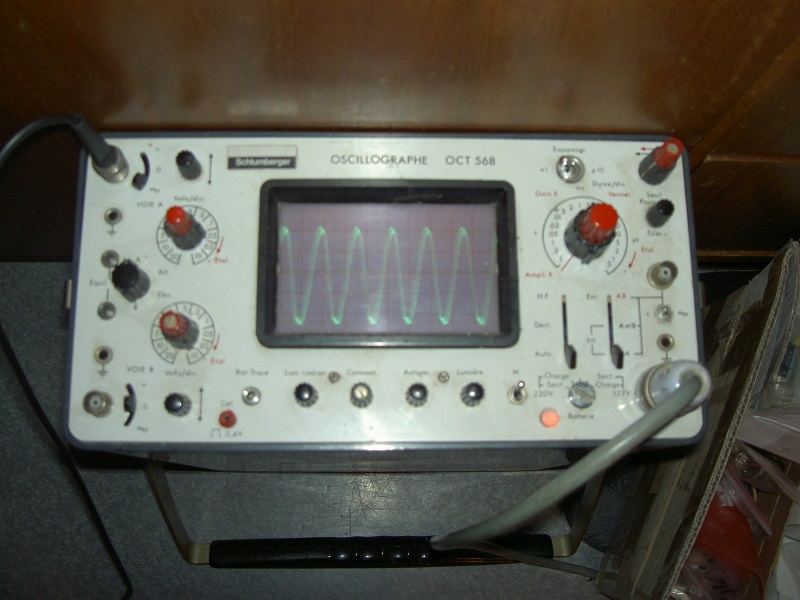

Maybe with a better output transformer you can get better bandwidth, the sinus you show is with which frequency and power? Did you saw with Square wave ?
At the first spot the pic show a good wave.

the power out is +/- 9 W to 1 Khz , and 8 W to 100 hertz +/- up 17 khz +/- , me old proto use mode " Triode " to EL / PL 504 , the idéa islink to very good job :

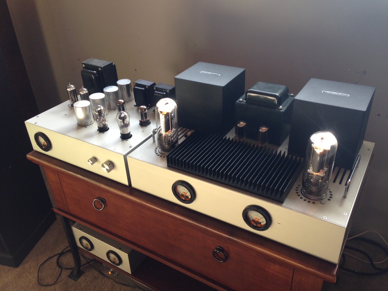

Posted a few pages back with kind of a crappy pic.. Anyways, I finally got my driver stage built properly, so here's another pic.
56 -> 6BL7 driver stage, 845 power stage.
Beautiful. The mismatched knobs are giving me the shakes though

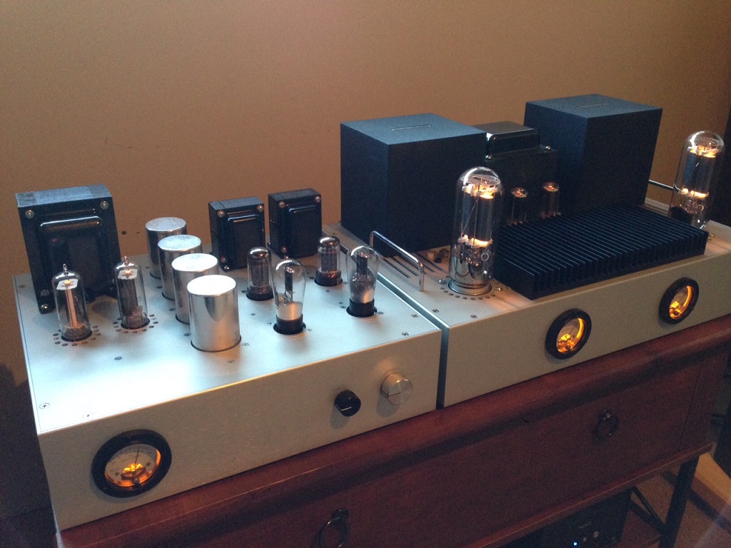

Thanks for the feedback! They're not sitting quite right with me either.. In my head they looked good together.. haha.
I was wondering what other people thought of that.
I've actually got 2 aluminum colored knobs, so I think I'll change to those.
Changed out the knobs..

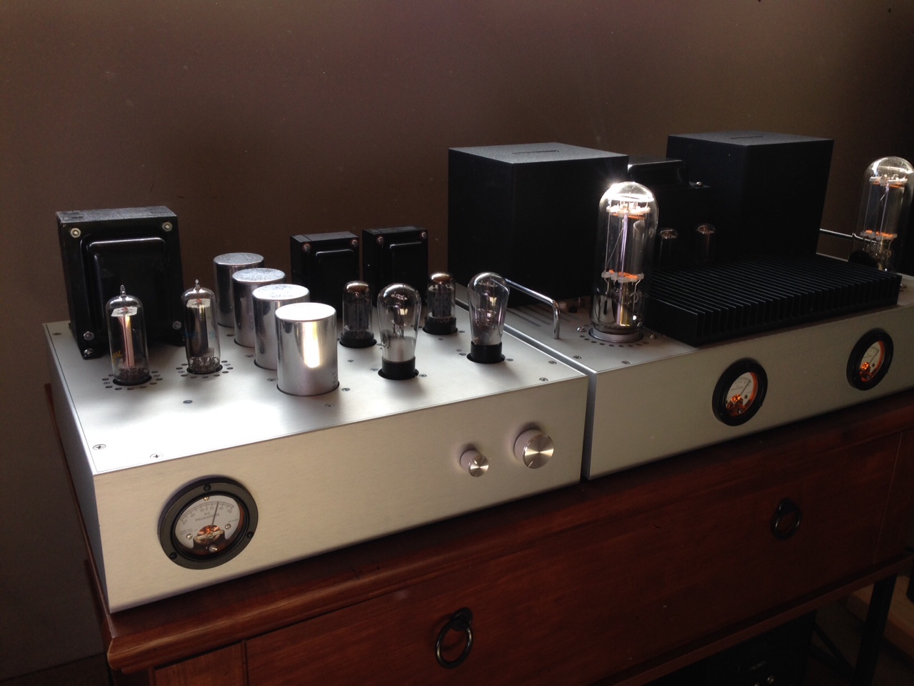

Hmmmm... changing the knobs to match versus mismatch.
I can not decide. Please send amplifier and knobs to me so I can study and judge in person during a long term evaluation.
Fantastic build. If you don't mind telling, where did you buy those meters?
