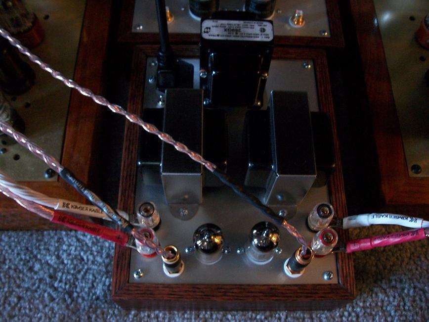

Where do you get the acrylic covers for your amps, or do you make them, if so, could you explain a bit?
Nice, is your first work?

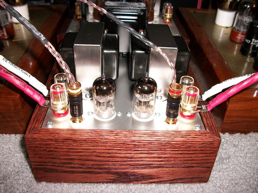

Why use each cathode with separate R/C, If you tie both electrodes together is the same.
Which out transformer use?
Does sound?
the first time I use the twin triodes parallel, yes
I think it is more proper to have two cathode resistors, the bias current might not be exactly the same in each tube.
The output transformers are made by a German guy, Ritter, he can make any transformer to your specs, he does a real good job.
The sound is very nice (not as nice as my 6EM7) and there ia a lot of it too so i can drive some more difficult loudspeakers

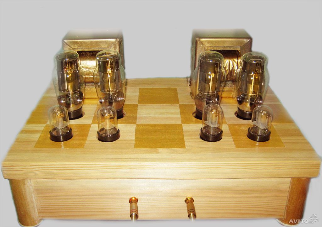

Bridged amplifier (Single End) lack PSU (Power supply is missing)
Power supply is missing. There are only a diode bridge and filter.

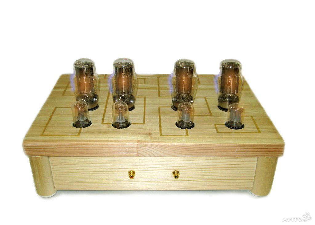

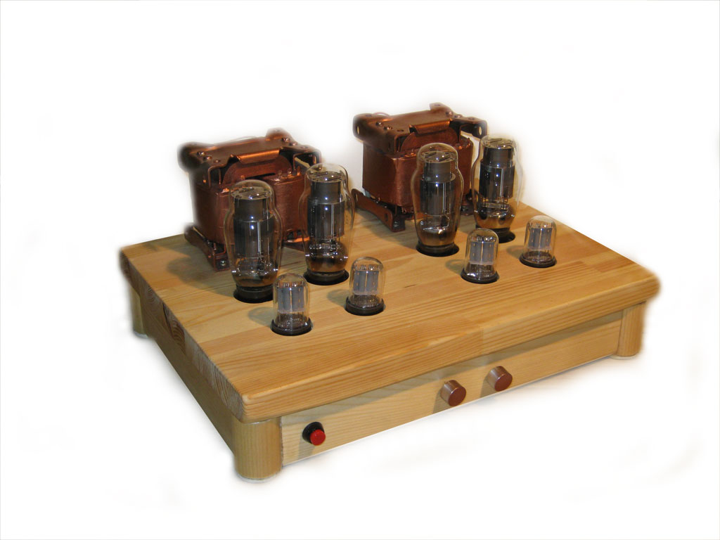

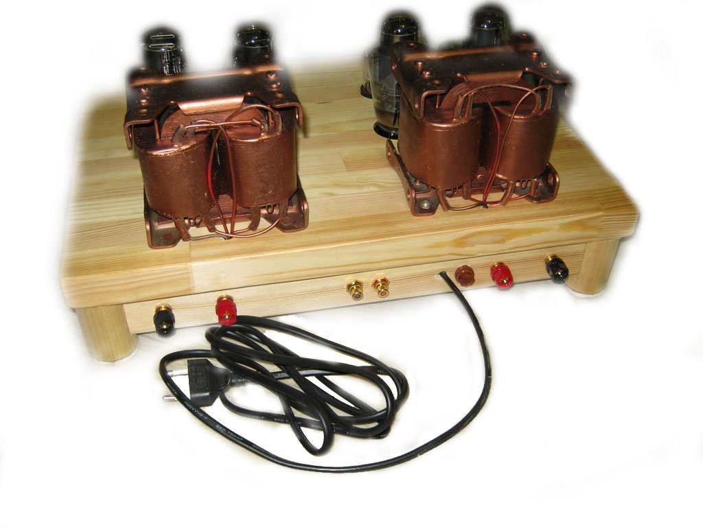

Galvanic isolation input/output. Power up to 8 watts per channel. Full SRPP. Very good sound. Assembled 5 different amplifiers. It is possible to use any output transformer 500/8/4 Ohms. Suitable transformers from Outdoor Sound Column (operating voltage 70/100V)...effective frequency range of 140Hz ~ 14kHz wide

SRPP Bridge, good idea for use with non exotic transformers. Probably you can get more power from it than 8W. I like the 5 x 5 square chess board of the chassis. The transformers you used for this project doesn't looks like PA adaptors.
I like the whole project.
Low output power of the amplifier drawback of this scheme.Or power or sound quality. PA adaptors: Food anodes through a rectifier from the mains-look closely scheme.SRPP Bridge, good idea for use with non exotic transformers. Probably you can get more power from it than 8W. I like the 5 x 5 square chess board of the chassis. The transformers you used for this project doesn't looks like PA adaptors.

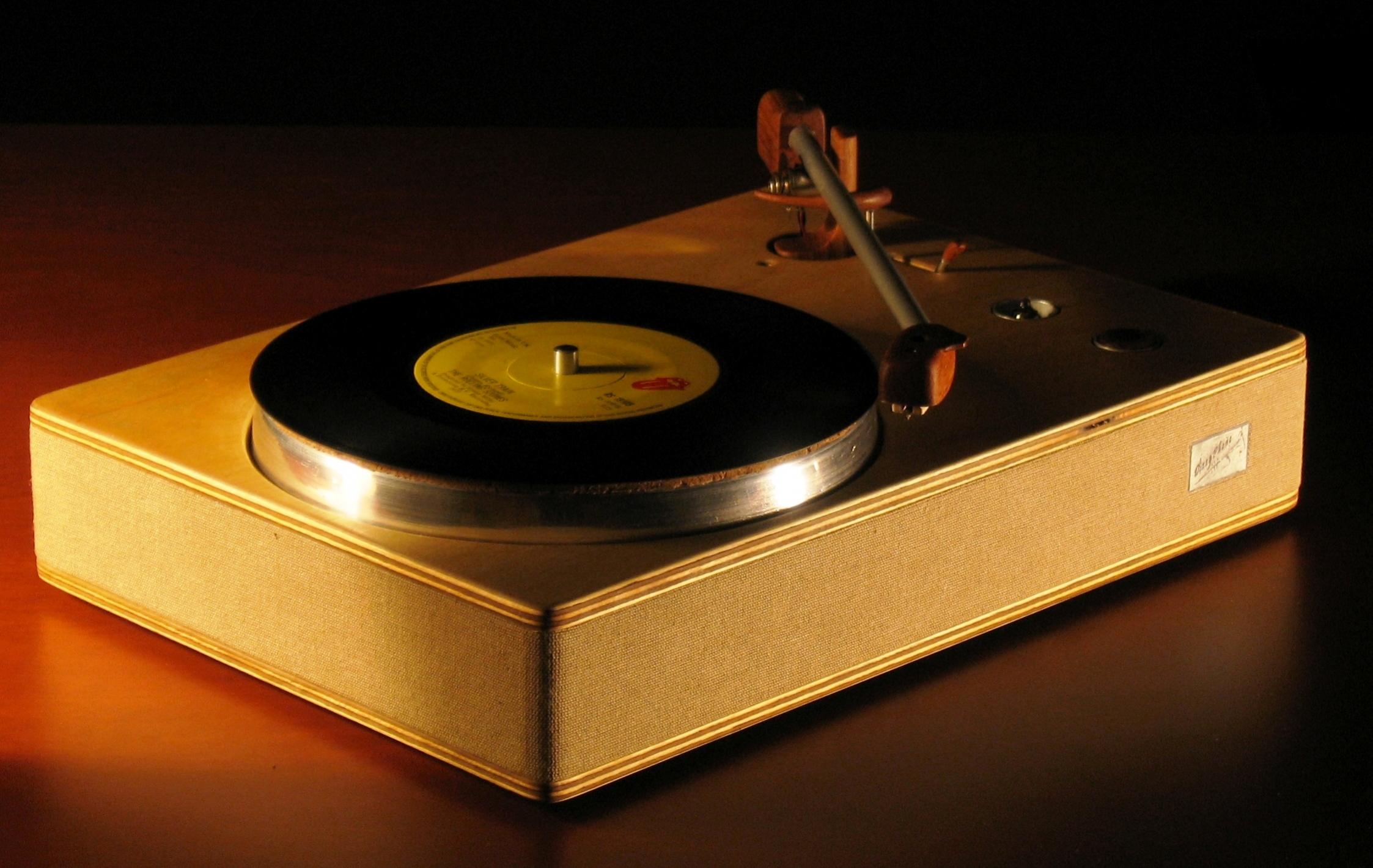

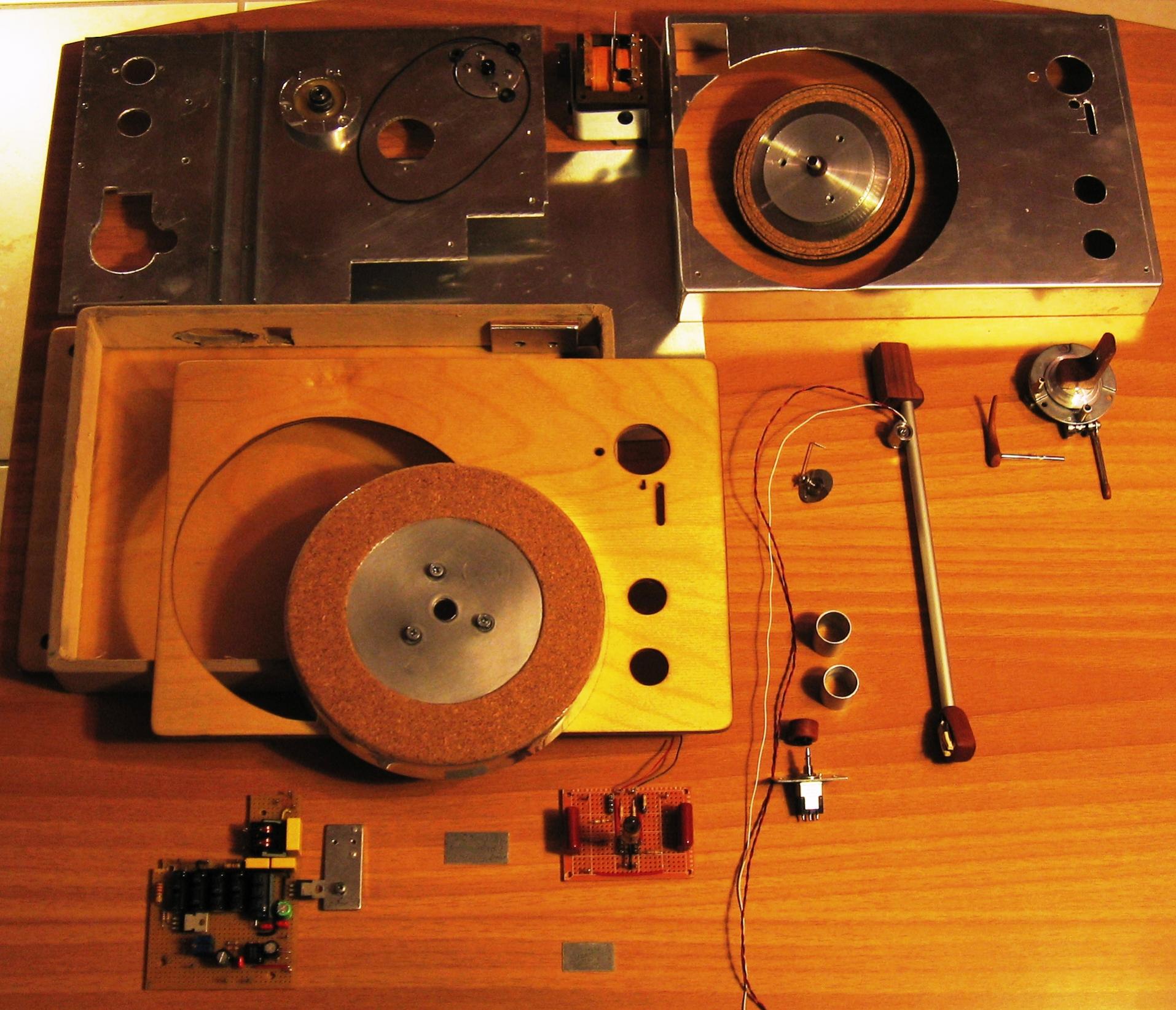

DIY turntable and tonearm with built in tube preamp...
Just for fun an all DIY project from HD parts etc.
Mono ceramic crappy cart ...In the presentation video, the audio is recorded from the original Lp on the DIY turntable.
