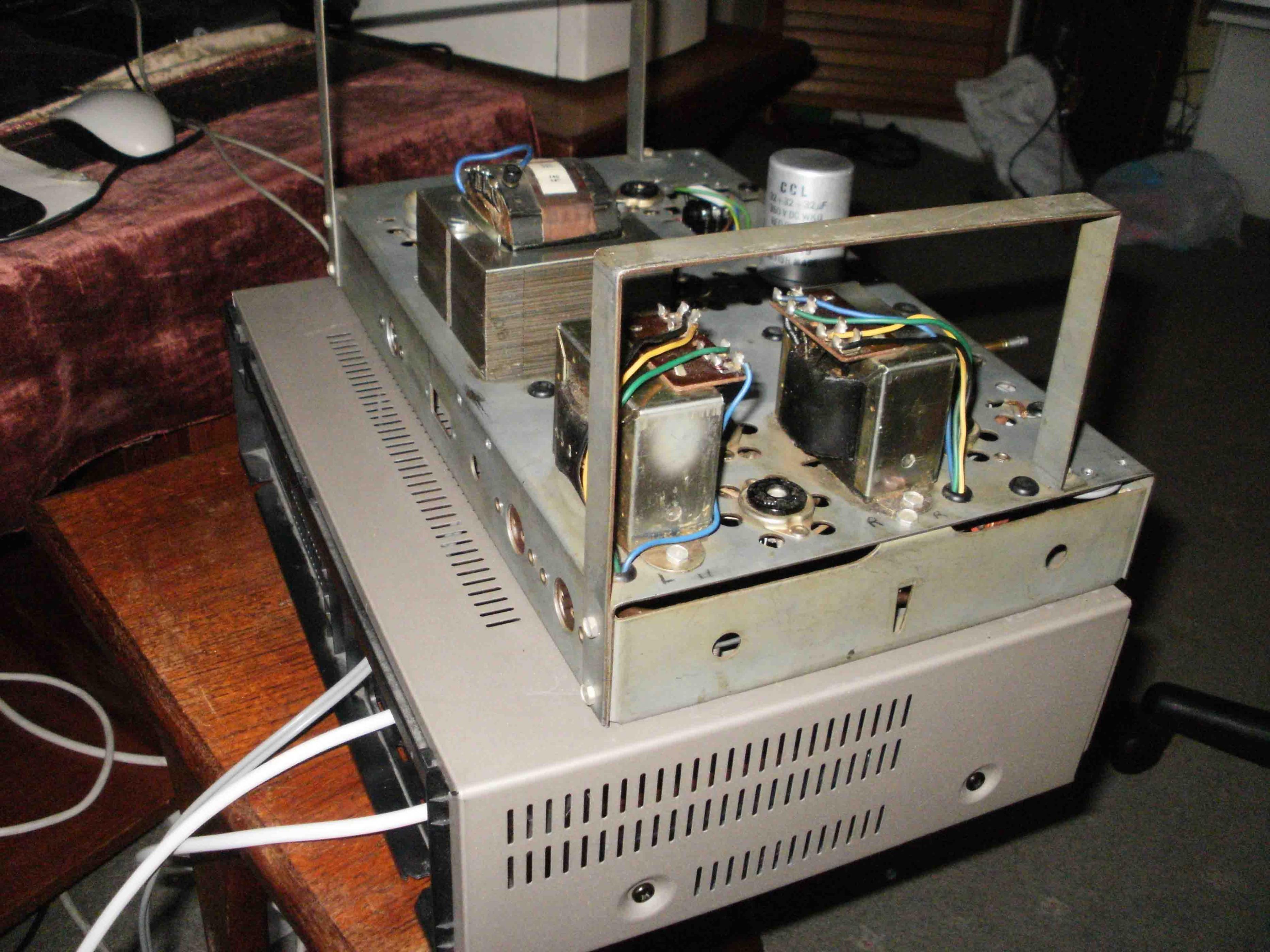

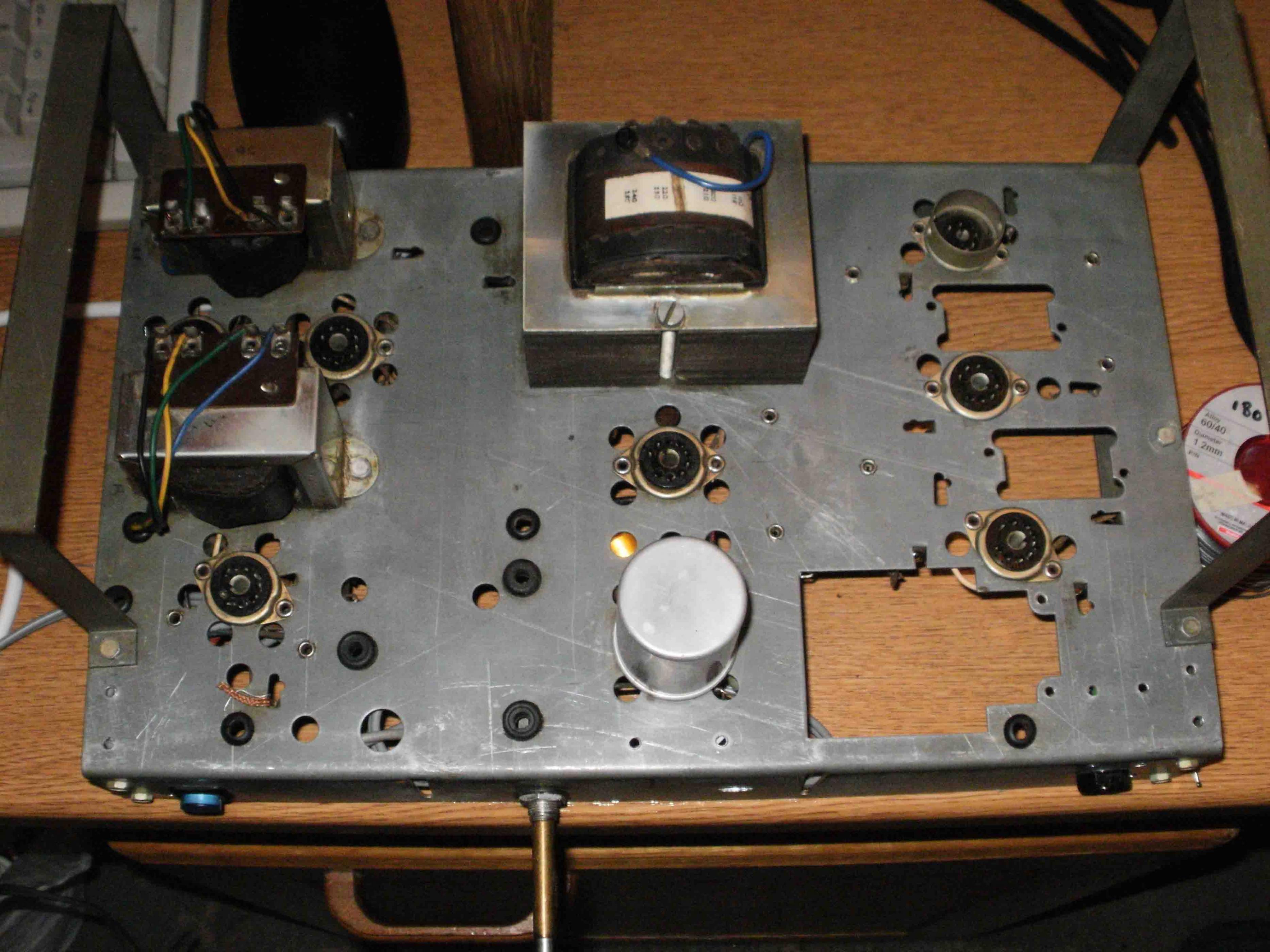

Decca stereo radiogram srg500 manufactured about 1956.
Original mullard valves seem ok. I decided to make a primarily headphone line source amp for rock and roll valve sound.
I cleared the chassis of all radio components and connections.
I had some cutoffs from stainless steel oven hood extractor ducting.
It was very thin and cut with tin snips then glued with superglue. Inside I put polythene insulation.
This made nice safety covers for all the transformers and choke.
The choke was made from an old E frame mains transformer by splitting the laminations and removing the "I" pieces, then reclamping
as open "E"'s.

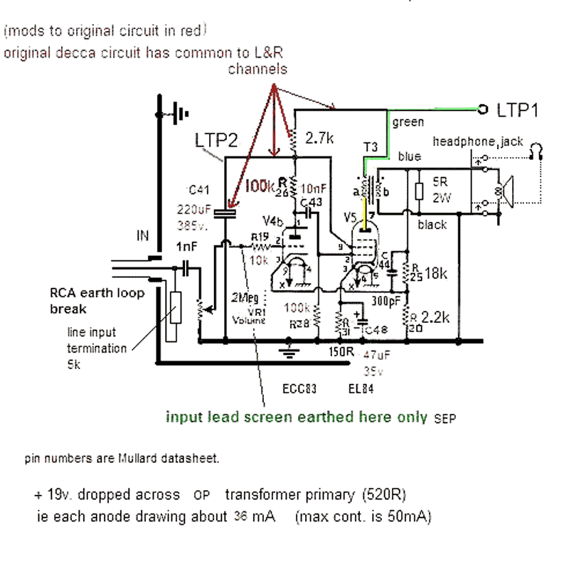

The audio design is ECC83 triode stage to EL84 single ended output. I hope the transformers are good quality, they are certainly heavy.
As sold the chassis was not earthed.
I got the circuit from vintage radio on the internet.
I converted the amp power input to a fused euro power socket, with earth connection to the chassis.
Input panel RCA and loudspeaker and power socket connections were to the rear of the unit.
The mains transformer had a bolt stub very handy for clipping the power and speaker cables to the chassis (see pic).
I discovered one toasty EC83 anode load which was replaced (the other channel value was 50% higher than spec probably due to age)
A preliminary switchon showed horrendous hum. (at switchoff, hum fades before amplification does).
I replaced both with 100k.
I noted the original circuit used single wire parallel ac heater supply, with chassis return. This partly accounts for the hum that was acceptable
at that time.
I decided to retain that topology, but use a well smoothed dc. I also added a separate toroidal mains transformer for the heaters.
This not only took the magnetic stress off the HT transformer, but also allows the heaters to warm up before HT is applied.
I suspect the rectifier valve and/or smoothing electrolytics (possibly the EL84 cathode bypass electrolytics too)

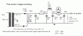

I replaced the caps C35,C41,C49 all 32uF 360v (in can). and the bypass C48 25uF 25v.
the first three were replaced by separate radial electrolytics 220uF, 385v.
HT
The original design used single HT supply for both channels (pretty well universal then). It has supply voltages shared at several points, including
a shared grid bias resistor. Since this was to be a headphone amp, I decided to retain this, as a certain amount of channel blending is headphone friendly.
I replaced the EZ81 rectifier valve with a silicon bridge rectifier (600v. piv, 10amp)
Output volts too high to adjust, so I used two diode 1N4007 in full wave in the equivalent to the valve rectifier and CRCLCR C smoothing.
Placed the choke in the smoothing circuit (stage2)
The final R was a mains 40W tungsten filament bulb (about1.4k). This has a nice retro feel and was mounted on the chassis top on vero board.

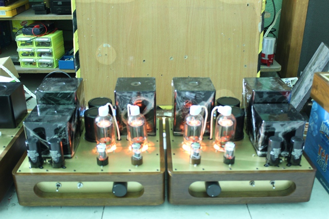

mono 300b lamp SE. the body is made of rosewood
Hi friend, where you got the tranie's cans? Nice aspect at all. How it sound?
BEST REGARDS
BEST REGARDS
the amplifier in the audio path no resistor or capacitor. sound will only wins. the sound is very accurate, fast, does not distorted. covers bought at the store utensils

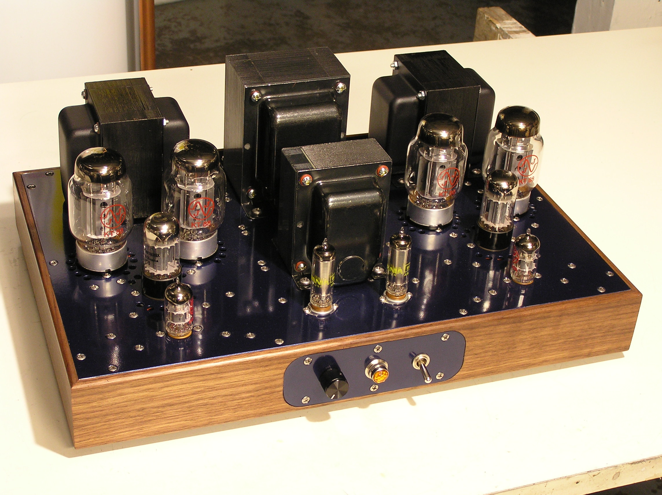

I'm listening to this KT-88 beastie I built a few years ago. Since the picture was taken, I've changed the output tubes to Gold Lion. Not so fond of JJ octals but love their miniatures, esp the 12AX7LPS.
The hybrid splitter works really well. U/L, 20dB feedback. Noise is less than -80 dBV, THD less than 0.1%.
I listen about 4 hrs/day.

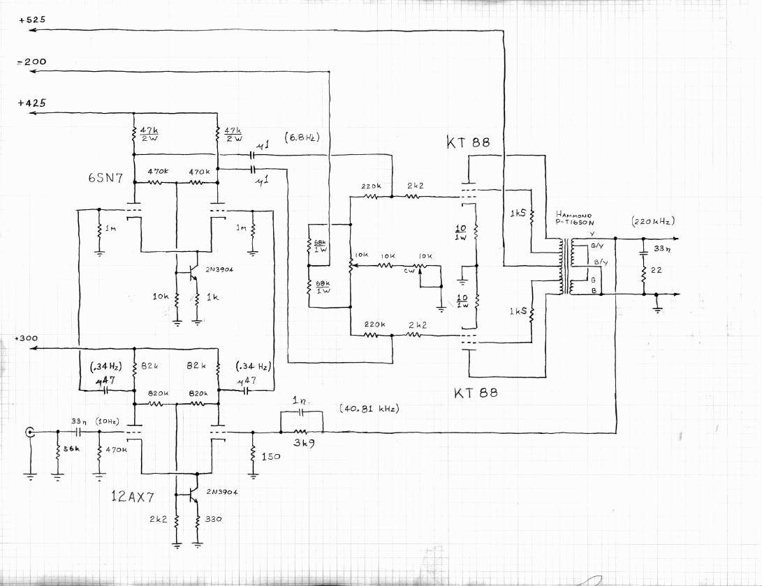

I like that. A nice build. I also like the use of the regulator tubes. Thanks for including the schematics. You just got me thinking about my next but one build....
Thanks!
I'm very pleased with the sound of this design- which I believe is largely due to (1) the hybrid splitter, (2) the choke in the power supply and (3) regulating the supply to the first stage.
If I had it to do over again, I'd be tempted to build it as monoblocks since it's pretty heavy with all that iron -and also the power xfmr is getting large enough to make a little noise - not from loose construction, but simply from the magnetic domains in the iron re-aligning with every half-cycle. In any event, the pwr xfmr is about as big as I'd want to use in a listening environment. A toroid might do better...?
I really like the hybrid splitters- if you've never built one of these, I encourage you to try one!
If you want more pictures or design notes, I'll gladly share.

Thanks for the offer. To be honest, I am happy to build just from the schematics that you've drawn. Very clear.If I had it to do over again, I'd be tempted to build it as monoblocks since it's pretty heavy with all that iron -and also the power xfmr is getting large enough to make a little noise - not from loose construction, but simply from the magnetic domains in the iron re-aligning with every half-cycle. In any event, the pwr xfmr is about as big as I'd want to use in a listening environment. A toroid might do better...?
Regarding the power supply - yes, a toroid might help, but it's not a guaranteed solution. The other way to re-arrange things is to keep a single transformer but to split everything after that for the two channels. So you end up with separate rectifiers, reservoir capacitors, chokes, etc. My everyday amp is a bit like that but without the chokes - http://www.diyaudio.com/forums/tubes-valves/234537-what-your-every-day-amp-3.html#post3463034

Replace EZ81 is not good idea, diodes 4007 is very bad choice. Also use ECC81 or 82 is more better 83.
I agree with diodes. The 81 further is not an audio valve probably better to control it. About 82 Different animal. To Popilin friend is a nice tube. SN7 is better- Did you tried 5751? ECC808?

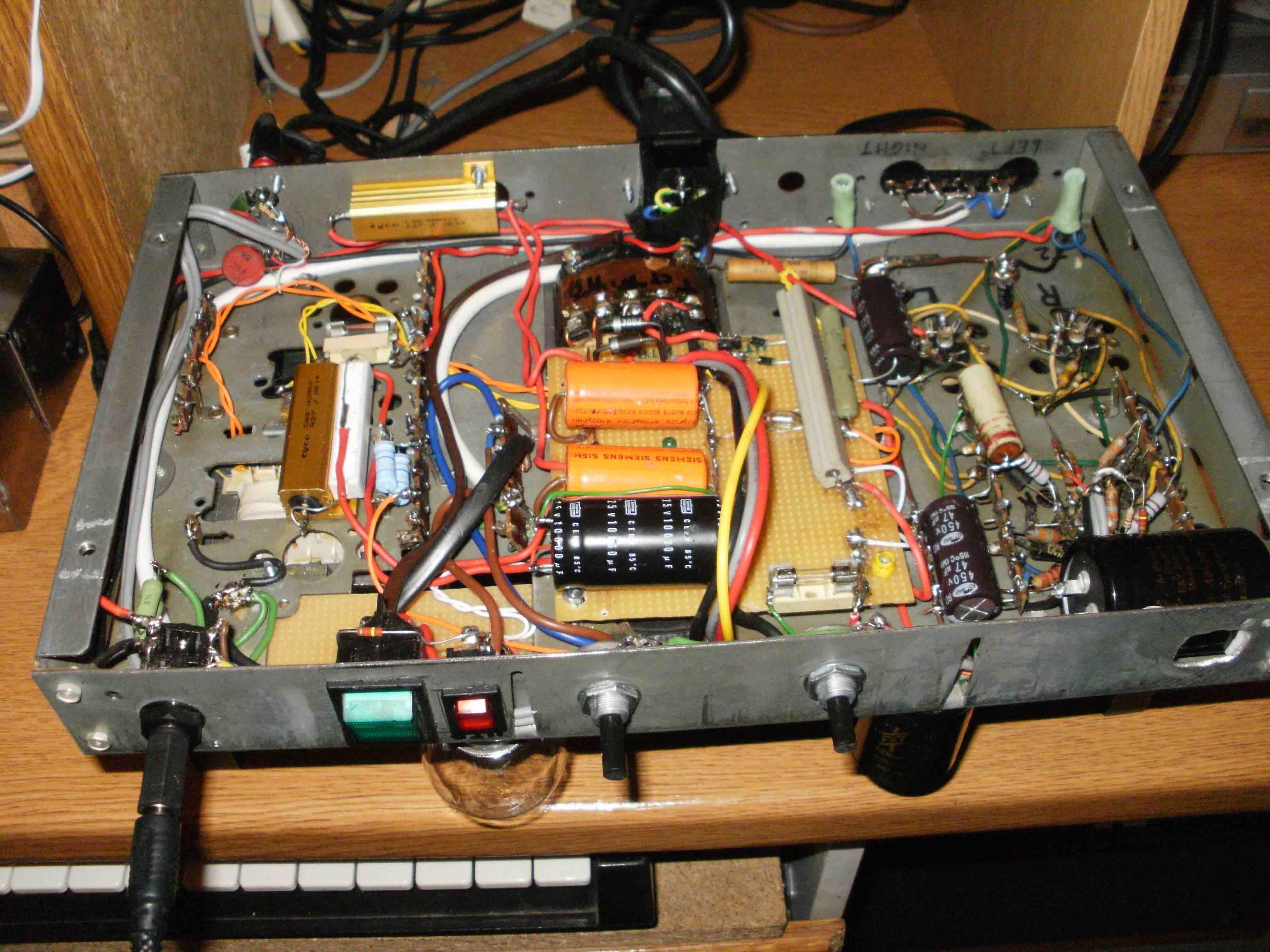

I have a pair of Heathkit EA-3 p-p 6BQ5 amps that I have modified a bit and they sound outstanding. Problem was finding EZ81 (not so EZ). I dislike that tube because not much is as short that might sub for it, even if one switches to an octal socket. No 5 volt rectifier filament winding here so a 5Y3 IMO ideal, isn't a sub even with a socket swap.
The cabinet is so low on that amp that you have to select short 6BQ5's or the tips will stick out through the air vents in the cabinet top.
To be consistent with the 6.3 volt heater, I would have put a 6X5 octal in the place of the 'not so' EZ81.
