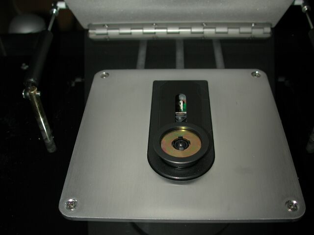

You should try to sand the metal in one direction only creating striaght lines as you go. I notice the finish so far looks like your wobbling all over the place. try using a 220 to 400 grit sanding belt from a belt sander and polish it like you would a good pair of shoes. You will need to hold the tranny steady while you do this. The surface should end up looking somthing like this.

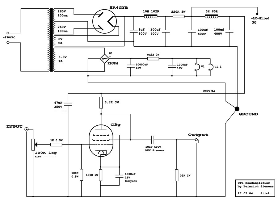

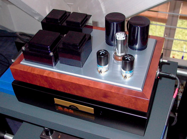

C3G headphone amp
This is my first ever tube project, actually my first ever electronic project ....
A headphone amp based on a design I found on the german site "Jogi's Roehrenbude", which definitely might sound unpronouncable for some...
It uses a tube made for the german post in the 60's (?) and that was used in audio repeater amplifiers for long distance.
The only changes to the original schematic are using a tube rectifier and way more chokes....It worked instantly not frying any parts and I only had some minor grounding issues.
Sound is promising and relaxed, although still a little "boomy", like some emphasis on the middle bass registers. Anyone got suggestions how to improve that?
