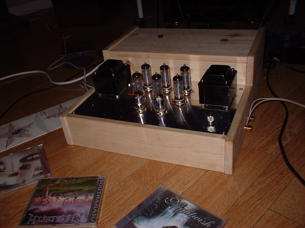

Another use of Lundahl transformer in an solid wood enclosure
This time the LL1674 as a passive outputstage in my CDP
Please follow the complete built tread here if you are interested

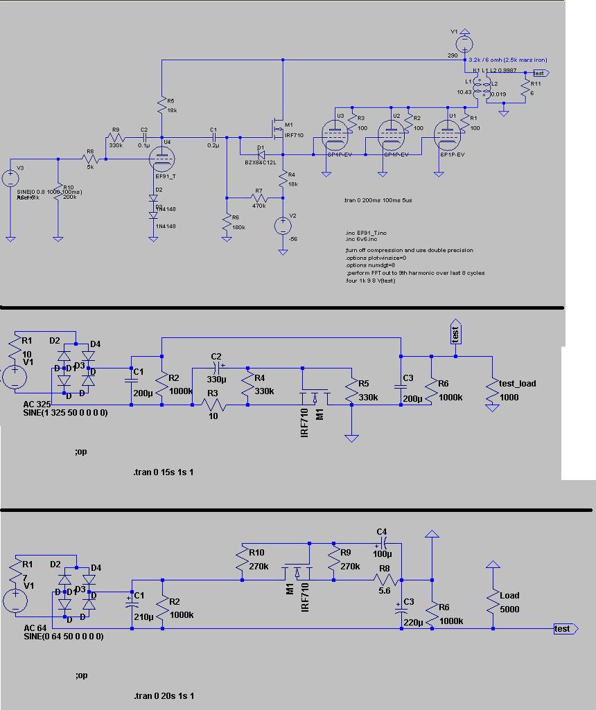

My first amp ever. (Scratch built, because I think kit's are just to boring... :D)
Mixing some ideas of my own with ideas stolen from variuse threads on this forum. (Powerdrive, Baby Huey etc.)
This was built on a budget, as i'm currently more or less unemployed. I spent about 200 euro on it. Very happy with the result, first impression this far is that it sound just fantastic. :cloud9:
Uses triode strapped CV4014 (mil. version of EF91) for drivers.
3 x triode strapped 6P1P-EV (parallelled) for finals.
IRF710 n-ch mosfet in various places.
HT: 120VA 1:1 isolation toroid (I simply added a 50v winding my self on top for the -57v supply).
OTP: Cheap china iron (Mars I think).
Topplate is 3mm 4106/5005 aluminum.
And everything point to point wired.:yes:

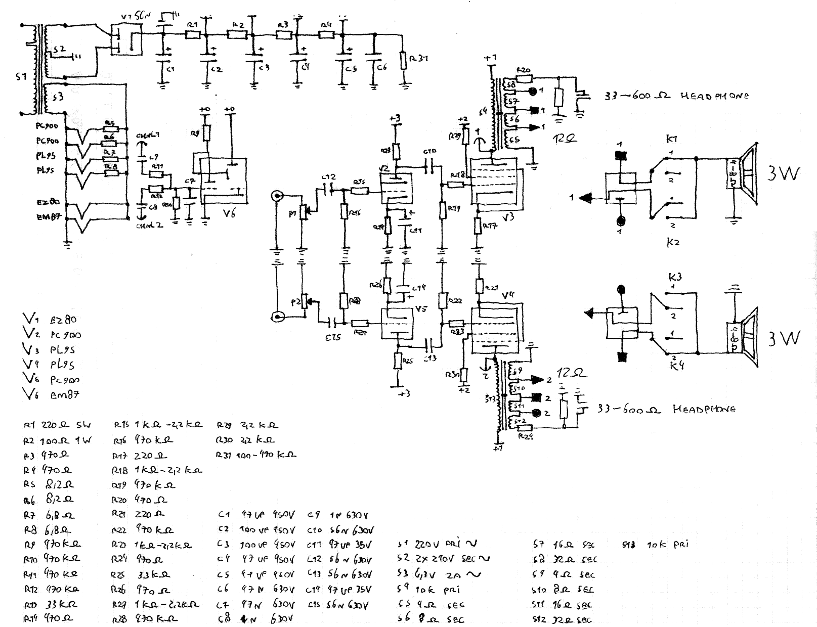

Circuit
Thanks everybody,
It took me alot of time to find the old hand drawn schematic (somewhere very deep in a file cabinet, and scan it into my computer and resize it.
But i found it so enjoy
Hope everybody can read it or else i will post the picture as a file to download

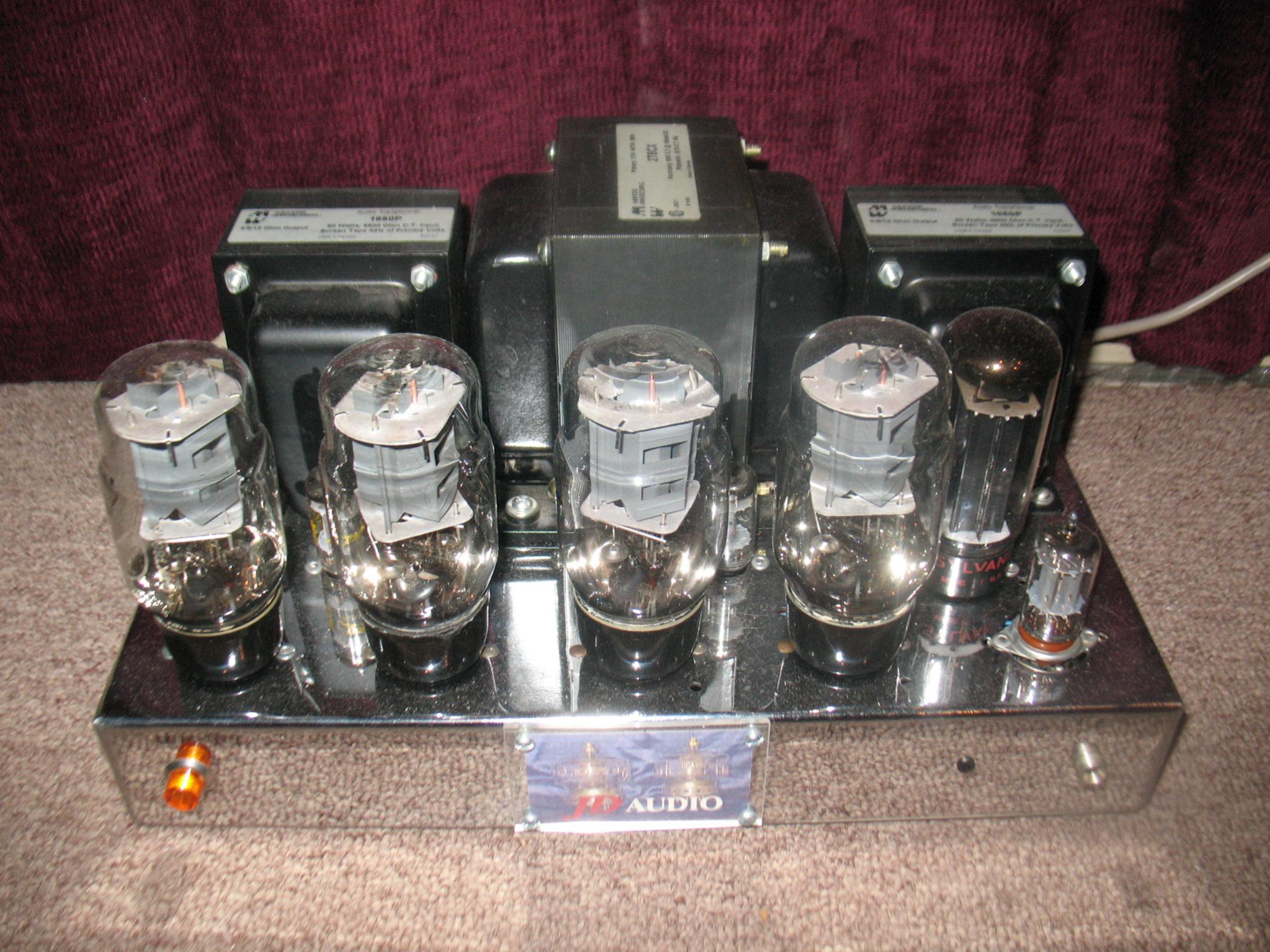

Hello fellow tube enthusiasts...
I see some of these pictures and alot of these amps are so cool and gives me the motivation to build some more amps....love the warm sound and glow.
Been a tube guy for 3 decades now, transformed alot of transistor guys and made alot of amps for them.
I like to share one of my best amps, many of audiophiles and newbies tried to buy, borrow and steal this amp from me. Has hammond iron, 1% metal film resistors and polyester signal caps, (orange drops), LCR caps. Tube recification, fixed bias and fixed screen supplies, could go UL but regulation follows plates and sound losses punch and accuracy. Uses 4 Shuguang kt66, 6c4 phase splitters and 12ax7 as gain stage. I could use the 12au7 for the phase splitter but like the 6c4 for its isolation of its desired channel plus no cross talk or signal injection that occurs with dual triodes. There isn't much more to this, this is the simplist amp with the least amout of components and in my opinion the best sounding amp i heard in my 40 years of this hobby...Im new with attahing pictures so I hope this works, if not anyone intrested, shoot me a email and i can send you picture and schematic and you can build your own. Soundude@GMail.com
Fellow audiophiles, if i post a amp and or schematic, its proven and built and I have in operation for over a year, i believe in completeing and sharing not trial and error.
