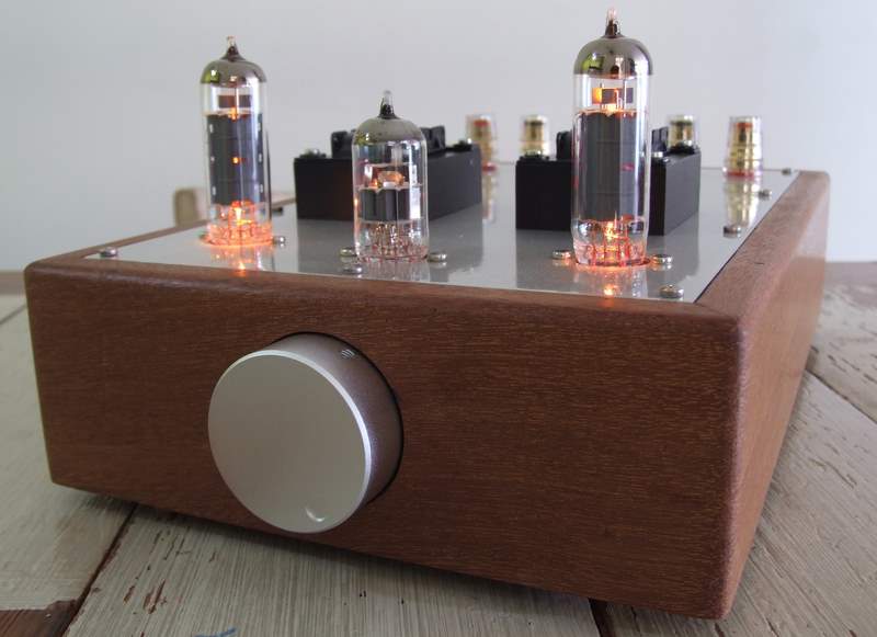

mcgaag said:My first diy tube amp sounds so good, i decided to built a proper housing for it because it probably will be in my living room for a long time. (at least until the next one is ready )
Very Nice!
Very nice indeed !

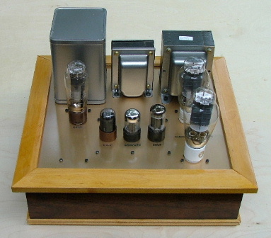

This is a picture of the inside of the amplifier during test and in a pine chassis. The lead dress is much better in the finished amplifier, but you can get a good idea of the "guts" from this picture.
On the right side are the low voltage transformers for the bias and JFET input stage, and the large Solen capacitor is the CLC output capacitor. The high voltage regualtor board is in the center of the picture and provides a regulated B+ for the tube amplifier and drive stages. The bottom left are the 5 Volt 300B filament transformers and above them is the input stage and constant current sources. Top left is the rectifier tube and the first filter capacitor.
This amplifer uses cathode feedback on the output stage and has a tube compliment of a 6SL7, 6SN7, 6BL7, GZ37 (or 5V4G) and a pair of 300B's.
