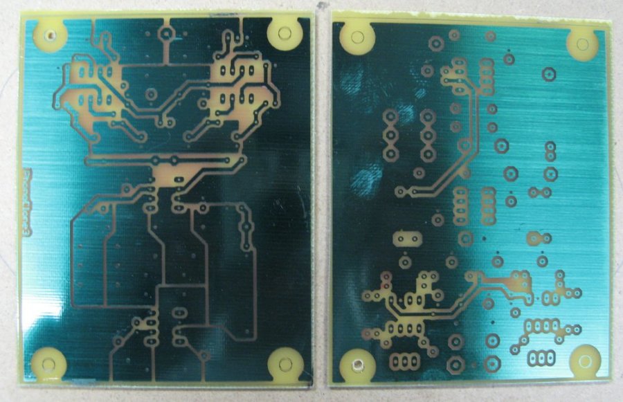

rhysh,
Just a couple of tiny rearrangements for 31n, the final Phonoclone 3 layout, it's essentially 31j, the one uploaded to the PCB web page.
It doesn't have "31n final" designation on the filename as I haven't run the olimexallsilk.udp script, which I'd normally do as the last step before sending the files to Olimex, but the 10mils.dru check passes successfully, so it's otherwise all ready to go.
Richard

Okay, i will get the files sent off to the board house for a final quote. Looks promising!

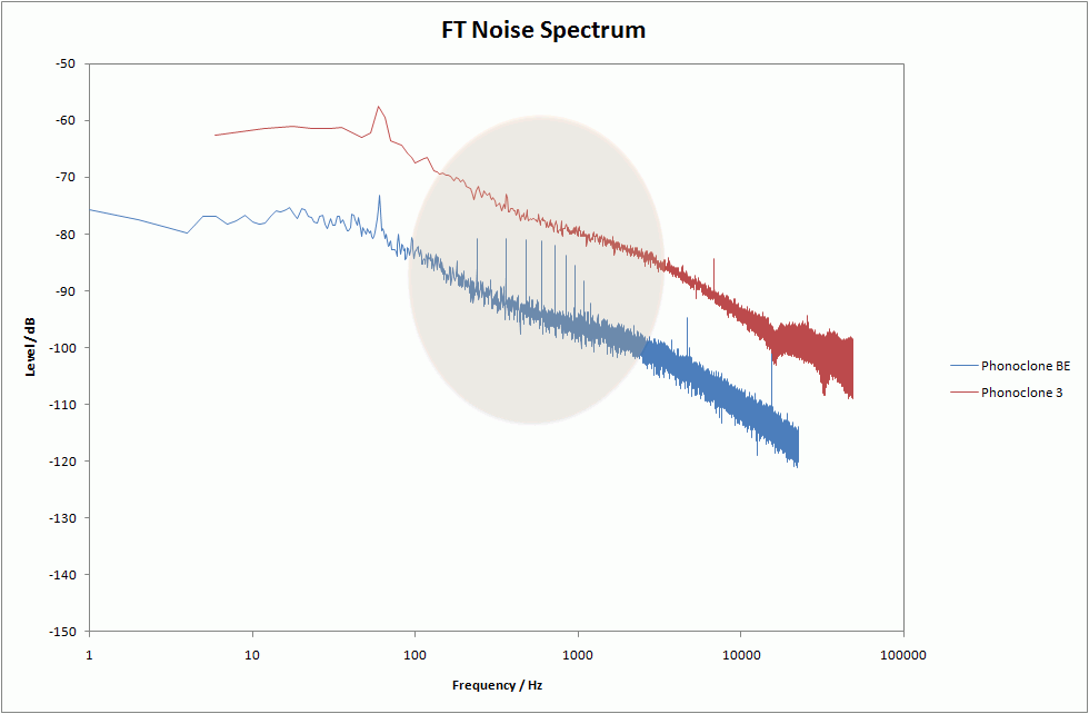

Comparison of output noise of the BE and P3 versions. We can see the harmonics of the 120 Hz power supply ripple are completely absent from the P3 output, whereas a smattering remains in the BE. I don't want to make too much of this**, but it is a nice result all the same.
The P3 was measured with the DL103 in place, turntable powered up but stopped.
The data is not normalized and not comparable in absolute terms! The P3 trace is higher overall mainly because of the arbitrary gain setting of the soundcard line input, and to a lesser extent because the phonoclone gain was set differently. I have verified previously that the output noise you measure is - apart from the noise spikes - essentially just the noise from IC1 filtered by the RIAA eq of the second stage. The datasheet limit, if you will.
**it's not very difficult to remove these spikes, the Phonoclone RC manages it with just a 10 ohm resistor and a 100uF cap. The Xreg, however, removes the noise and maintains a low output impedance. And anyway, at the end of the day it's about the sound - that's why I value Fran's assessment above more than any of these measurements.
