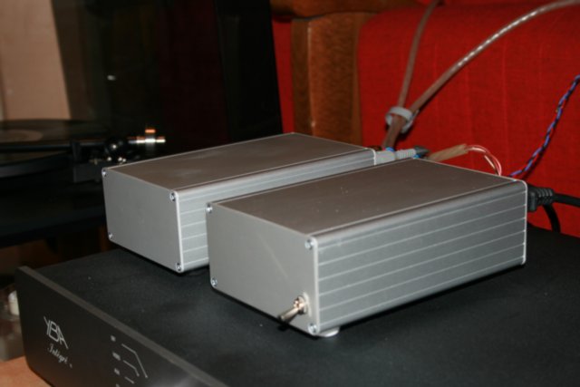

I am also waiting for the kit, but I already built the VSPS phono pre for MM cartridges.
In the picture you see the pre with separate PSU I built. The cases are from
hammond .
These cases are well suited for the phonoclone because the inner dimension is the standard eurocard used by rjm for his pcbs.
I think the look is also quite professional; I have seen pictures of commercial phono pres using the same case (although with a thicker front panel).
But I also have a question: I would like to use metal spikes as feet but the ones I found until now are all too big. It would be nice a big spike in front and two smaller ones in the back.

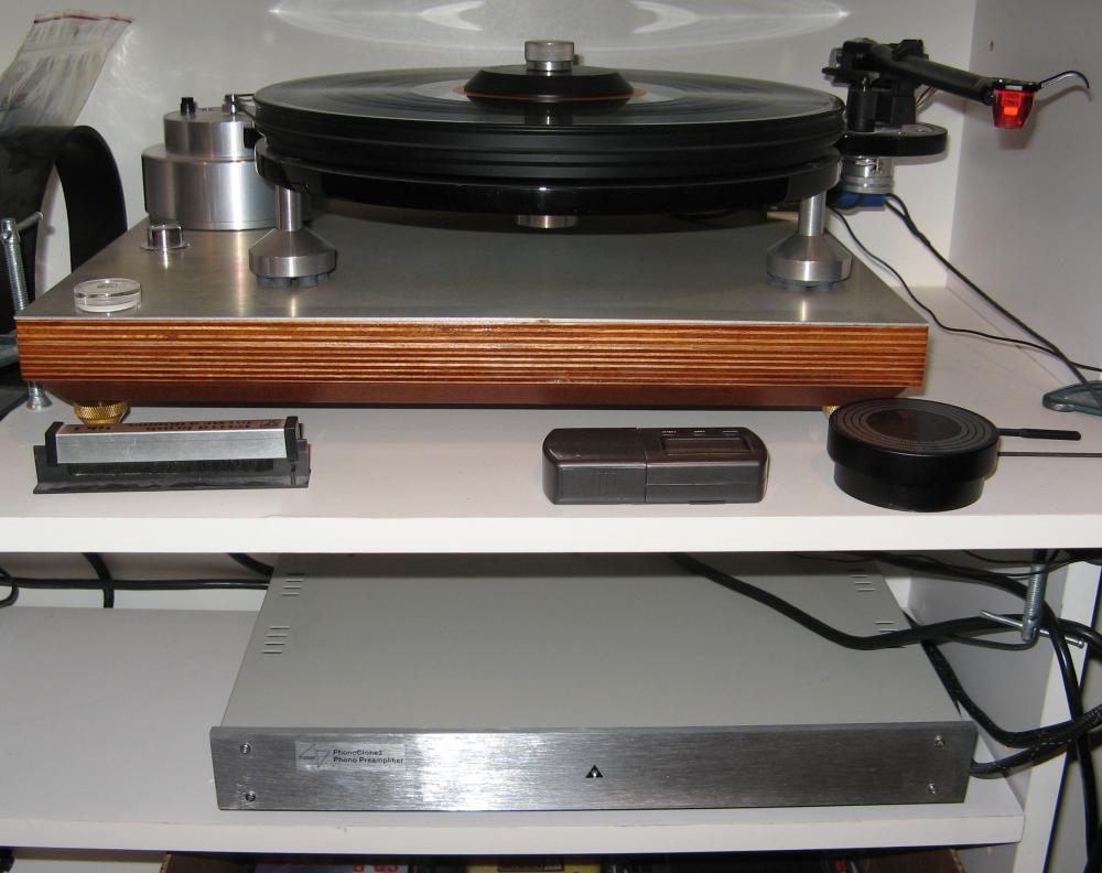

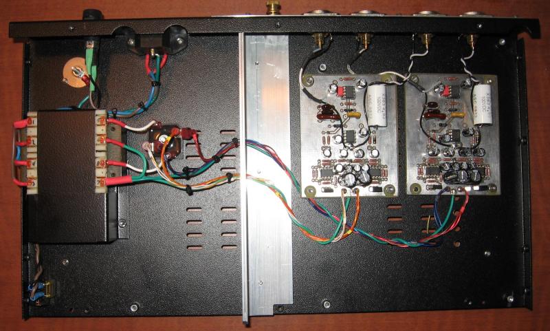

Finally, I was able to close the cover on my PhonoClone 3 and to try it.
To make a short story:
-No hum, no noise, dead silence right from the start.
-Simple grounding connection, In/Out cables directly to the PCB, coax (shielded input connectors), twisted pair Kimber wire for the output.
AC inlet GND to the case, preamp GND lug connected to the case. Separate supply GND for both channels, up to the common rectifier.
-For the record (right choice of word , I have the supply mounted in the same enclosure as the preamp without any ill effect.
Now the sound. Well, I'm almost ashamed to say that it is sound as good as my very expensive Audio Research PH5. It is as good as that. I'm very please with the result. It is very resolving, bad records sound bad. Very good ones are plain vanilla, sparkles, right timing, just great sound. Again, if you build just one phono preamp, try this one.
northernsky, just to tell you that I'm using 20mm birch plywood disc as footer, with a small layer of foam (from a mouse pad) with very good result.

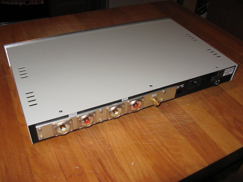

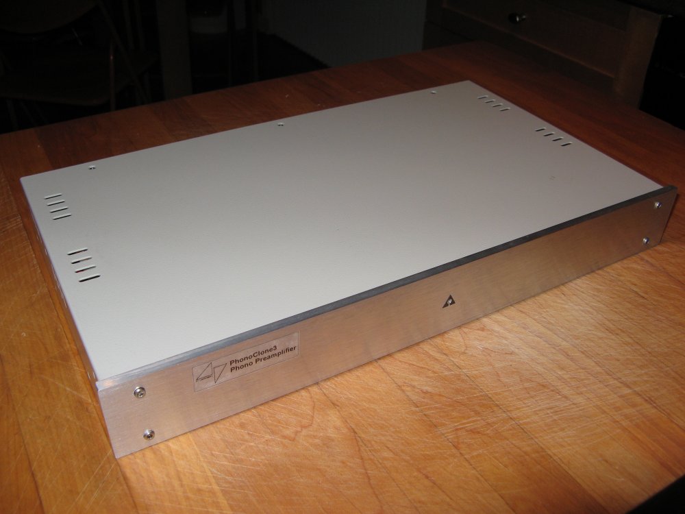

The case was recycled. I still got 5 others for some more projects.
They are made of steel, tough powder paint, very rigid and rather nice.
I made a complete new front panel using 1/4'' aluminum plate, brushed using 80 metal paper and soaped water.
Here the front view.
On the back, I had to cover the existing holes, so I installed a new aluminum plate. Neutrik RCA connectors installed horizontally matched nicely the case height. For the GND lug, I used my classic mix of brass bolt, nuts, flat washers and finally thumbscrew (all from Home Depot). All hardware is stainless steel. That gives a very professional and functional look. Not bad
Inside view. Supply and preamp in separate section, divided by a piece of 1/4'' angle aluminum.
For the supply wiring, I'm using an home-brew cable made of multistrand cooper wires, separately insulated and twisted. The supply GND wire is a heavier gauge been share by the +/- supplies.
A little trick, the main AC power switch is hidden under the case, near the front panel, left corner.
