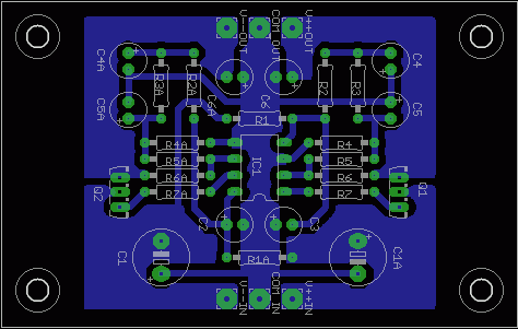

Schematic and layout files for the Xreg standalone board updated to rev. 13e. The TIP41/42 transistors were replaced with BD135,136 types.
That's the last bit of housekeeping I had left. An amusing project for someone might be to come up with a miniature version using a NE5532 dual opamp, ideally using a single-sided PCB.

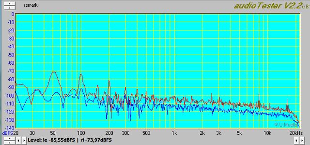

GerardA said:Might be possible, even with a dummy input resistor there still is some 50 Hz left, although 20 - 30dB lower.
If the dummy resistor is the same value as the cartridge impedance, then that is indicating that the problem is noise pickup into the cartridge and/or input leads.

OK, found the problem, now the solution.
As you can see in the picture the blue line looks very good, this is with an input resistor, the red line is the turntable connected.
The scale is compared with Hifinews testrecord: 0dB of the record is minus 18 dB on the graphic. So noise is down about 100 dB and hum about 85 dB. That's perfect for me.
What happened?
Yesterday I put my 300B amp closer to the recordplayer and when I made the pictures for you I had not put on the amp, when I turned it on the hum went 20 dB or so up!
So put the amp back in it's original place was better, turning the power of of all the closeby powerlines even better and moving the phonoclone mains away gives this result. Now only the pc and monitor are left for the measurements, maybe they give the remaining noise...
So a perfect phonoclone but still work to do!
Question: will screening and or twisting the powerlines help?

Thanks for the graphic.
Certainly you want to put as much distance between the 300B power amp and the cartridge/turntable/phonoclone as you can. Tube amps usually have EI transformers (bad) placed unshielded on top of the case (worse).
Your data seems comparable to mine, in the worse case the hum is 10 dB higher... reasonable considering environmental differences. With the cart. plugged in there is some spikes at 4,8, 16kHz, and a bit more of a "comb" pattern of power line stuff, but the worst of it is at least 70 dB down. I would not expect that your phonoclone should audibly "hum", even with the volume control turned up.
The remaining low level noise signals are of a magnitude that cable routing, shielding and general tidiness could well make a difference to the measured result, yes. It should not make a difference in what you hear though.

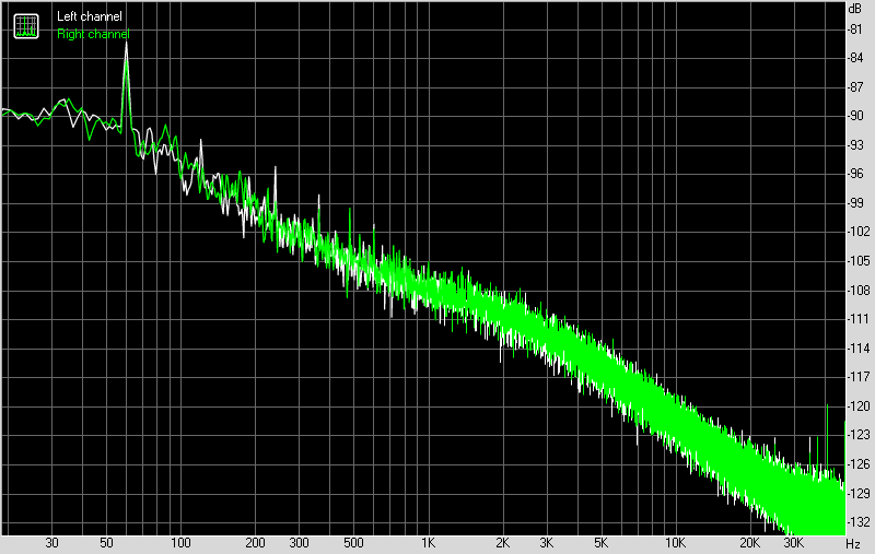

I redid the Fourier spectrum of the phonoclone noise, using more data points (64k) so the 60 Hz harmonics show up better.
The .wav file is the same as I posted earlier, phonoclone_noise_2496_new_54.wav
Phonoclone Gain 58 dB.
Recording Gain 0 dB.
Plot scaled to 0 dB = 1 V rms.
DL-103 connected, turntable powered off.
Onkyo SE-200PCI
Rightmark Audio Analyzer 6.2.1
note: a recording gain of 0 dB (unity) is about 6 dB higher than I would normally set it when copying an LP to the hard drive.
self-check : if the plot is calibrated to 0 dB = 1 vrms the measured noise in dB at 1 kHz on the spectrum, plus the phonoclone gain, plus the recording gain, should total within spitting distance of -167 dB. I tend to get in the region of -160~-165 dB depending on the parameters used to make the FT.
