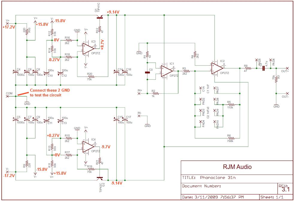

The output voltage of the xreg is higher after you replace the capacitors, since the leakage dragged the divider voltage down before.
With the 22k resistors for R11-14 the output voltage is actually a fraction too high, I think somewhere in the region 25-33k would be better, whatever is convenient and depending on what voltage people what to run the phonoclone circuit at.
Personally I think it sounds pretty good at 9V, where R11-14 are 33k. Using 25k will give you a more traditional 12V.

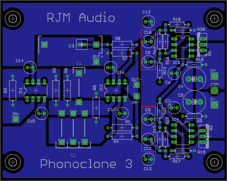

rjm said:You are of course correct. Ouch. That explains the break-in issues: the capacitor electrodes were reforming under reverse voltage. The working voltages were low enough that they didn't blow up. I can't believe I missed that. Sorry everyone.
Hi RJM,
Sorry for your time, I've a Phonoclone rev. 30n PCB, can you please take a look the C10-C13 capacitor polarity okay or not.
I'm a bit confused since C8 and C9 location moved in rev. 32a.

Another update, changing the value of R11,12,13 and 14 from 22k to 33k to lower the xreg output voltage to 9V. (or 25k for 12V)
The xreg demo board has the correct capacitor orientation but I haven't (as of this post) got around to changing the resistor values.

rjm said:Sure, the traces are fine, it was just the silk screen layer that had the outline reversed. Further updates are just to the parts values and cosmetics of the schematic.

A word about output voltage:
I think the circuit sounds (a lot) better when the output voltage from the xreg is lowered to about 9 V rather than 12 V or more. It's not clear whether this is because the phonoclone prefers low voltages, or whether the xreg likes a large Vin-Vout differential. I rather suspect a bit of both.
For Algar-emi and others with working circuits, I suggest increasing R11,12 or R11-14 in order to lower the xreg output voltage. As a guide the total value of R11+R13 (and R12+R14) should be about 60 k ohms. Either go with 33k in both positions as I have suggested in the latest eagle files, or leave R13,14 at 22k and increase R11,12 to ~40k for example.

rjm said:I suggest increasing R11,12 or R11-14 in order to lower the xreg output voltage. As a guide the total value of R11+R13 (and R12+R14) should be about 60 k ohms.**
Just to clarify that's for the most recent set of parts values, 220R/22k/2k2/75k. The beta version originally had all those values halved, 100R/15k/1k/33k. Ironically those original values should give about the right voltage without further modification.
Just to weigh in here with my own personal experience. When I first built the PC3 I used the standard figures and ended up with ~13.5V feed to the opamps. I was happy with that. Then after some questions from algar-emi and RJM about the voltages and those caps being in backwards, I started to check out the voltages. My feed voltage was stable at 13.5-14 but just within regulation. So on RJMs advice I dropped the voltage a bit - initially to ~10.5V (I think that was 22k-28k) and right enough the sound did improve. What were the changes? Well its hard to describe exactly but the sound was a little less "etched", I think a little more relaxed but I can't see that I've lost any detail or resolution. I think if I was to put a notion on it, I would say it sounded a little more valve like.
So then I went to go a bit further and replaced the 22K-28K with 2 x 33K and that brought the voltage down to about 9.2V or thereabouts. I couldn't hear any much difference between the 10.5 and 9.2V feeds but definitely a fairly big difference from 13.5 down to 10.
So to cut a long story short, if I was selecting parts I would go faor maybe 2 x 30K (rather than 33K) only because if someones raw DC is a little lower then the feed voltage to the opamps will also be lower. That should keep everyones voltage in the region of 8.5-10V which it would seem is the sweet spot here. This is all assuming that we are all working off a 12v AC primary, giving a raw DC in the 16-18V (unloaded) range. If someone is really fussy you could fit a 30K to one position and then rig in a 50k pot to the other one to allow for ultimate adjustability.

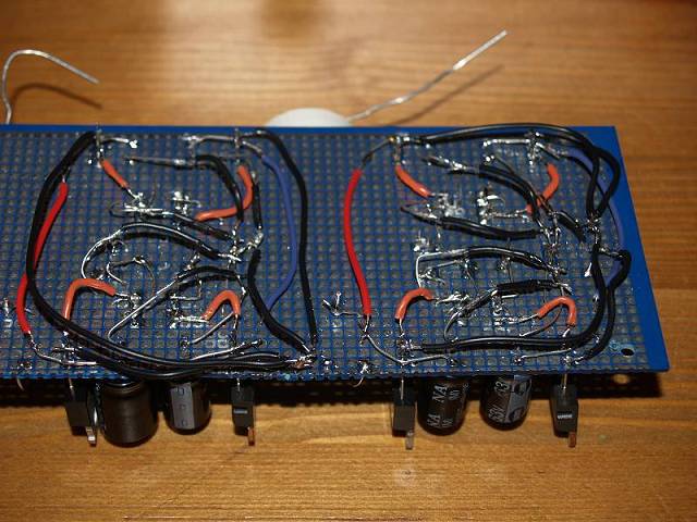

And another picture.
It is the first version of the phonoclone,
I had the parts but never made the jump.
In fact point to point is not so difficult if you like to puzzle a bit.
It worked right from the start, including hum and mobile phone noise.
I got the 50 Hz down to -70dB and 100 Hz down to 60-70 dB.

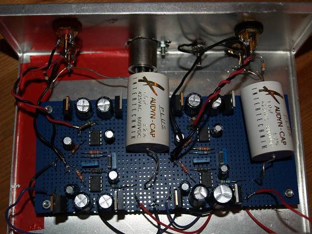

So I boought the parts for the X-reg yesterday!
Things I did for the hum:
Lower the amplification to 54 dB, hum is lower but so is the output.
Renewed the connectors for the turntable earth wires.
Twisted the input wires inside.
Connected the caseconnector to the left input-mass instead of the input-com of the powersupply. This made a real difference!
A real good help for this is a FFT on your computer like the audiotester program (audiotester.de)
And how does it sound? Incredible!
I never heard such a strong and natural bass in my house.
It is very detailed and a lot of space. When the music gets really loud everything stays comfortable and no change in character.
