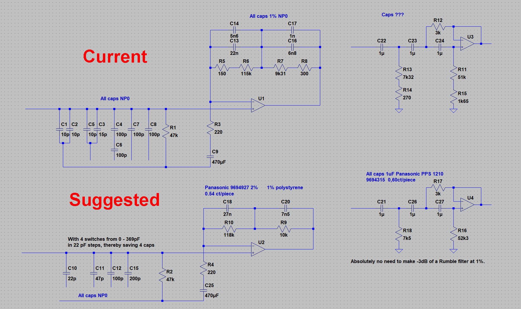

I knew I'd mess up somewhere with this... I double checked the schematic against the simulation in TinaTI and hit the order button with pcbway. Then when ordering the components realised I'd specced 1uF 0805 SMDs in the sub-sonic filter :h_ache:. As far as I can tell these don't exist as C0G NP0 types so I'm trying to work out an alternative.
I'm resigned to the fact I need to correct the design for a permanent solution but in the mean time is there a capacitor (even a leaded type) that I could use to test? Ideally lowest thd and minimum tolerance in that order of importance.
Any ideas would be great.
There are many Ceramic multilayer 1 uF 0805 caps available, at least when looking at Farnells website.
They may not be what you had in mind, but they will do the job without a doubt.
Hans
MKS0B041000F00KSSD -
Film Capacitor, 1 µF, 50 V, PET (Polyester), ± 10%, MKS0 Series
Thanks, that looks like a good option... I'd been looking at some monster polypropylene caps - they were going to look a bit precarious on those 0805 pads.
You can stack 2 or 3 smaller value caps of the same footprint easily enough.
That's an interesting idea... I can get NP0 C0G up to 470n and 5%, a pair of those will get me close. I'll try to adjust the resistor values to make that work.
Thanks for the ideas.
Stacking SMT parts works very well, and I've done it many times.
Solder one end at a time, and allow to cool before soldering the other end.
The COG/NPO types are excellent, much better than mylar/polyester types.
I think I had a brain fart when I specced the ceramics, looks like I'll be using the stacking technique sooner than I thought. The 6n8 is now a stack of 4n7, 1n8 & 300p and the 5n6 is a stack of 2*2n2 and a 1n2.
The parts bill is a shocker - £265 and I had a few of the parts in the spares bin. Mostly down to the NP0 ceramics and minimum order quantities.
I think a bit of cost optimisation before version two!
If you can send me a BOM with prices, I can suggest where cost reductions can be made.
Hans
Thanks, I'll send you what I have... I don't mind spending the money, the spare components will get used sooner or later. But if I can reduce the cost that would be useful.
Perhaps a different SMT size will be more available and cheaper, though NPO/COG types are
always more expensive. The 1206 is easier to mount, also.
I didn't consider cost when designing, it's a good lesson. I'll have a look at the other options with the next design.
Looking at this again a lot of the cost was in the minimum order quantity of components (10x / 25x) so future iterations shouldn't cost as much. The other major cost is stacking up NP0/C0G to make the 100n caps in the servo I'm not sure how critical the values are or how much they contribute to thd/noise as they'll have little voltage across them in the audio FR. If I can use 5% X7R or similar for these I'll be saving myself £40 straight off - perhaps I'll try that first and change them later.
I guess I'll treat this one as a learning exercise.
Also I've just discovered how to build components in Eagle using one footprint and multiple schematic symbols... that should help me simplify things.
Image below shows what I suggest, including some Farnell part numbers.
On top of that, you have used Omron relays the G6SK series.
From TE Connectivity there is the IM series. Their footprint is much smaller, cost is almost 50% lower and they are very reliable.
Hans

Thanks for the suggestions Hans, I had more or less completed a re-design so I've gone with some of the original values. The reason I was looking for NP0 for the Servo was because I made a mistake and made them 0805 on the layout. I've now decided to get the boards re-made rather than botch the job.
I decided to go with polypropylene for the larger caps in the end. They're a bit big but don't impact the layout too much.

I could only find latching relays in the TE range with a single coil - which would have meant quite a few H-bridges. I think the main impact on component cost was trying to use larger value NP0s.

BOM is now a bit more reasonable, I need to spend £130 to get the parts (because of minimum quantities), which works out as £82 including VAT per board.
Also I spotted a couple of errors in the schematic, I forgot the 68k across the output and the RIAA has a 31k which should be 9.31k.
