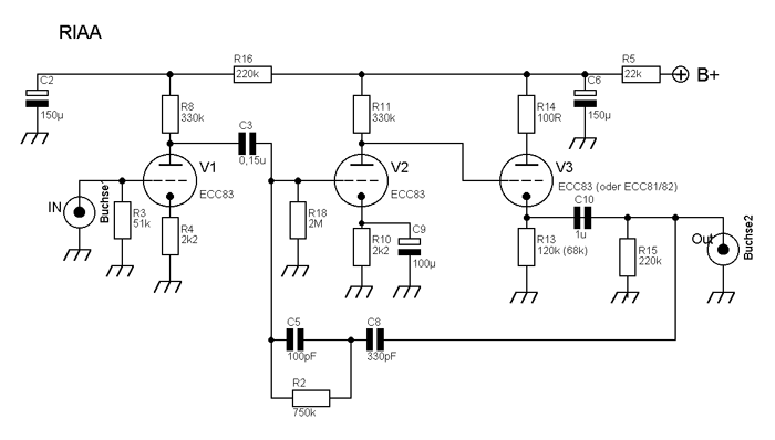

I put the circuit into LTSpice and ran a sim to check the RIAA error. I my limited experience it looks quite good. Not up to my HPA5.1 standard but I have seen much worse -
