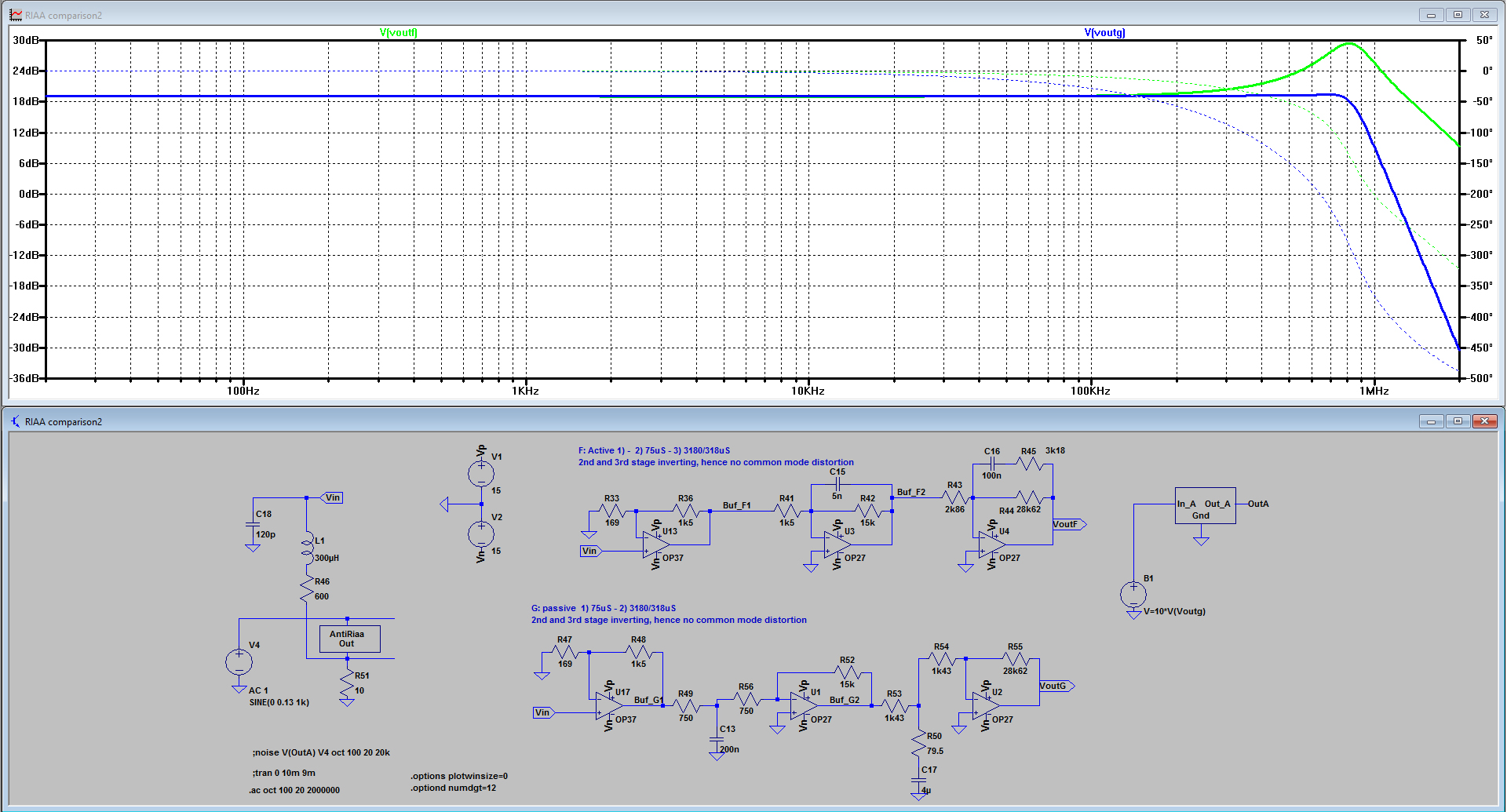

When taking the circuits F and G from posting #23, but adjusted in such a way that both have the same feedback resistors over the opamps, but with unaltered gain, headroom from 20Hz to 20 Khz is exactly the same 25dB for both versions.
The A weighted noise measured with LTSpice with a Cart connected (600 Ohm, 300 mH and 120 pF for cable plus input cap) is 86 dBA for the active version and 85 dBA for the passive one, when measured from 20Hz - 20Khz ref 5mV@1Khz.
Since these opamps have input current cancellation, one should correct these figures with -2dB resulting in 84dBA and 83dBA resp.
Given the fact that 65 dBA is about the point where noise from the Phono Amp first starts to becomes noticeable at normal listening levels, but only with your ears on the speaker grill, 84 dBA and 83 dBA are ridiculously good and way beyond the point that still makes sense.
To conclude, yes there is 1 dB more noise, but at a level far beyond what is needed, and headroom is exactly the same for both.
When simulating the frequency response for the two circuits however, one can see a nasty 10dB peak around 1Mhz for the active version, with a much slower roll off as for the passive version, that does not show this peak at all.
Two 100pF caps on C1 and C2 will make things quite bit better, but it becomes not as smooth as the passive version.
It is obvious that this is far in the supersonic region, but the circuit seems to be more susceptible to HF oscillations and for RF signals entering the Phono Preamp.
So you might have to be more careful when designing an active filter Phono preamp.
In the passive version, Cap values needed for the RIAA are much larger, which makes C17 very large with 4uF in this very case.
When going to 1uF for C17 and making the surrounding timing resistors 4 times as large, you will lose 2 dB SNR, bringing the A weighted noise with Cart connected to 81 dBA, which is still more than excellent and way beyond what is practically needed.
Hans
is there 300µH in the schematic ?
...... (not 300mH )
In my posting I mentioned a 300mH Cart coil, but in the Simulation I used a 300uH coil, which is of course wrong.
I did this in the middle of the night, which turns out to be a mistake.
Headroom won't change, but I will recalculate the SNR,
Sorry for this silly error.
Hans

Not only did I insert a 300uH Cart coil, I also forgot the 47K Cart loading.
I should have stayed in bed instead of simulating in the middle of the night.
So forget the silly graph in my previous posting, it does not show the correct behaviour.
With the right values now, 600Ohm, 300mH , 47K and 65pf cable/input capacitance I recalculated the SNR.
I also replace the OP37 with the 5534, so I don't have to correct for the input current cancellation that the OP37 has.
For the active version with Cart connected, A weighted SNR is now 81.8dBA.
For the passive version with 4uF for C17, SNR is 81.1dBA, only 0.7dB lower as it's active brother, all measured from 20Hz to 20Khz, ref 5mv@1Khz.
The Headroom for both circuits is the same 25dB over the whole audio range from 20Hz to 20Khz.
And when using the same resistor values for both versions, noise is only 0.7dB worse.
So to say that you lose on headroom and noise with a passive filter, has to be taken with a large grain of salt.

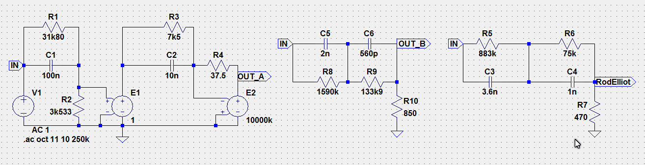

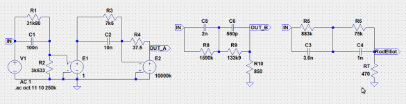

To Jose and Hans
There are quite a few RIAA encoders out there.
The one I used in msg #23 - well I don't recall where I found it, but you say, Jose, that the response is different from Rod Elliot's, so I divised a comparison between the 2 (see attachment). I've also included an encoder, which IMHO is accurate to within +/- 0db (!).
When running them, it's apparent that they only differ for (very) high frq, where my encoder keeps rising with 6dB/octave as it should - in theory.
This is mathematically the most accurate way to produce Riaa and Anti_Riaa curves.
In the frequency domain the results are perfect, but in the time domain they produce strange phase and amplitude errors and shouldn't be used.
View attachment Riaa-Inverse_Riaa.asc
Hans
