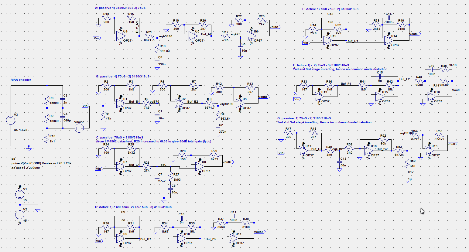

Let use this opportunity to update my collection of RIAA amplifiers. I have added two more, the active version with two inverting amplifiers, and version with passive eq AND two inverting buffers. The latter is particular appropiate for OP amps with common mode distortion issues, i.e. "cheap" audio OP amps. Again, I have chosen the impedance level high enough to such that virtually all OP amps may be used - even TL072
Advice:
I have not taken neither input offset voltage nor input bias current into account. For some OP amps you might find it necessary to include a capacitor after either the first or the second OP amp. Eg. if the first OP amp has a 3mV input offset voltage, that will be amplified to 3V at output of the last OP amp.
Or if the input bias current of the first OP amp is 500nA, the output will be 500nA*47k*1000 = 2.4V.

FWIW, if you go with an input buffer, you can lower the feedback resistors far more than most people realize or are comfortable with. The signals are small enough that current isn't a problem. Keeps the noise low.
Are you talking about shunt RIAA feedback? With series feedback the impedance of the RIAA network can be as low as you can drive with the opamp/s of choice, and this has no effect on the input impedance at the non-inv input, so no noisy buffer required.
I had an overwhelming desire to have the RIAA stage inverting.
But why?
No justifiable reason, just a feeling that high gain circuits are often less troublesome if inverting, and maybe an old Jim Williams statement, "when in doubt, invert!"
Well you have no common-mode distortion, but with 5 mV signals that's not an issue anyway. But you have added another stage with its noise & distortion. To me that's troublesome.
if you want to use OpAmps, go active. Here is a good example:
The VinylZone: Analogue Addicts Phono Pre
If you want to go passive, I'd use an open loop discrete circuit. Two gain stages (each about 30-40 dB max) and a buffer for output. Provide for enough headroom.
But it is more difficult and expensive to do. Gain adjustment (MM/MC) can be made in first gain stage, increasing / decreasing degeneration. That will get you about constant headroom, and the noise penalty for higher output cartridges is not critical.

I have yet to hear a plausible reason (audibility being the least) to not use an LM3886 for low power amps. Yet there are tons of discrete schematics and amps, books and threads about this around.I have yet to hear an even faintly plausible reason to use passive RIAA. You will lose on noise and/or headroom.
When designing with Op Amps you have boundaries that are difficult to overcome with passive EQ, and I would not do it. Thus I wrote he should use active EQ.
When going fully discrete and open loop, passive EQ is a nobrainer regarding headroom and noise.
No buffer between the two voltage gain stages, using the high impedance nodes to place the RIAA network.
Much more fun than just using an Opamp and hook some caps and resistors around it.
And it sounds better, to my ears. But thats my statement, and no, I will not enter in such discussions.
