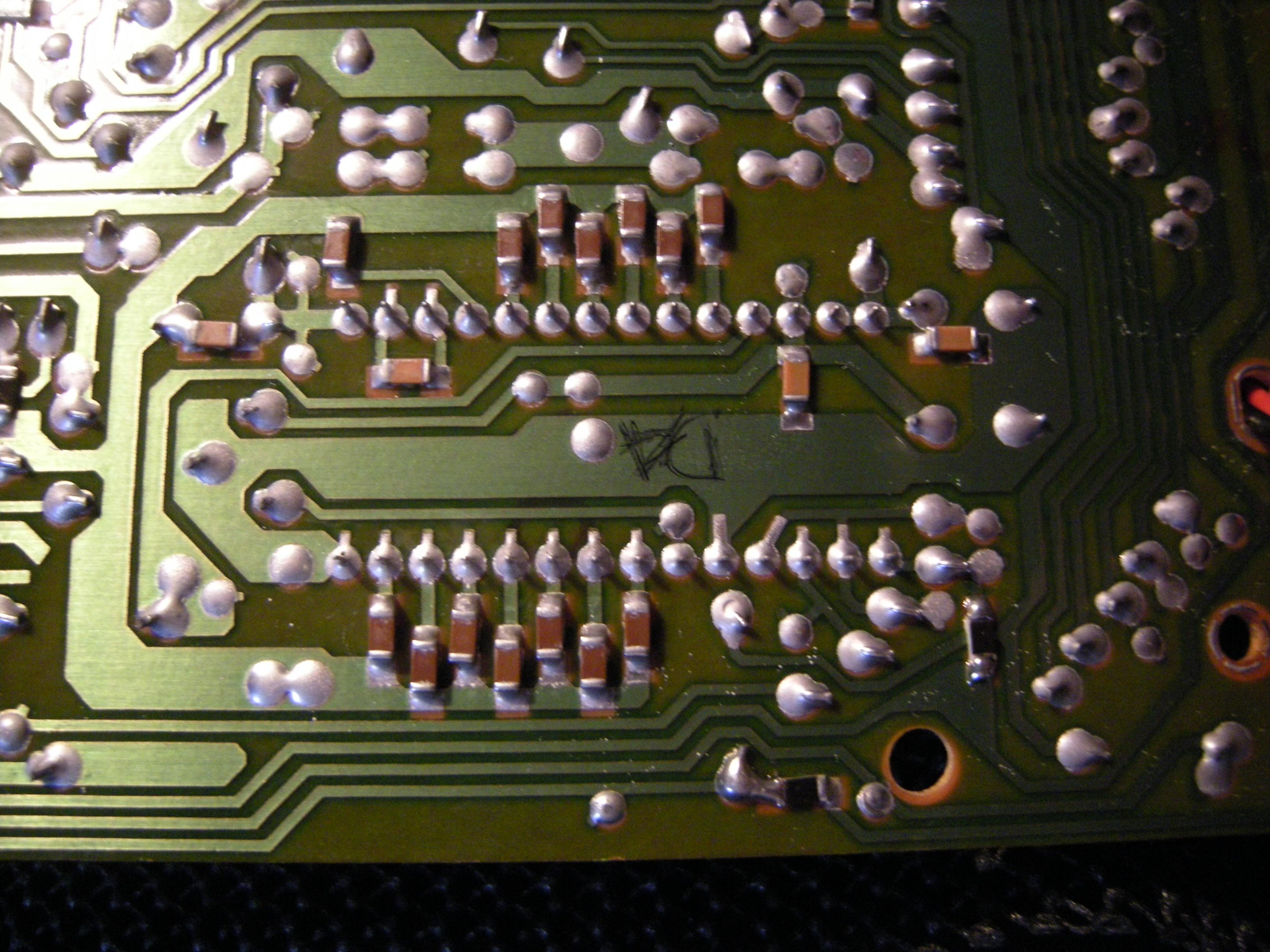

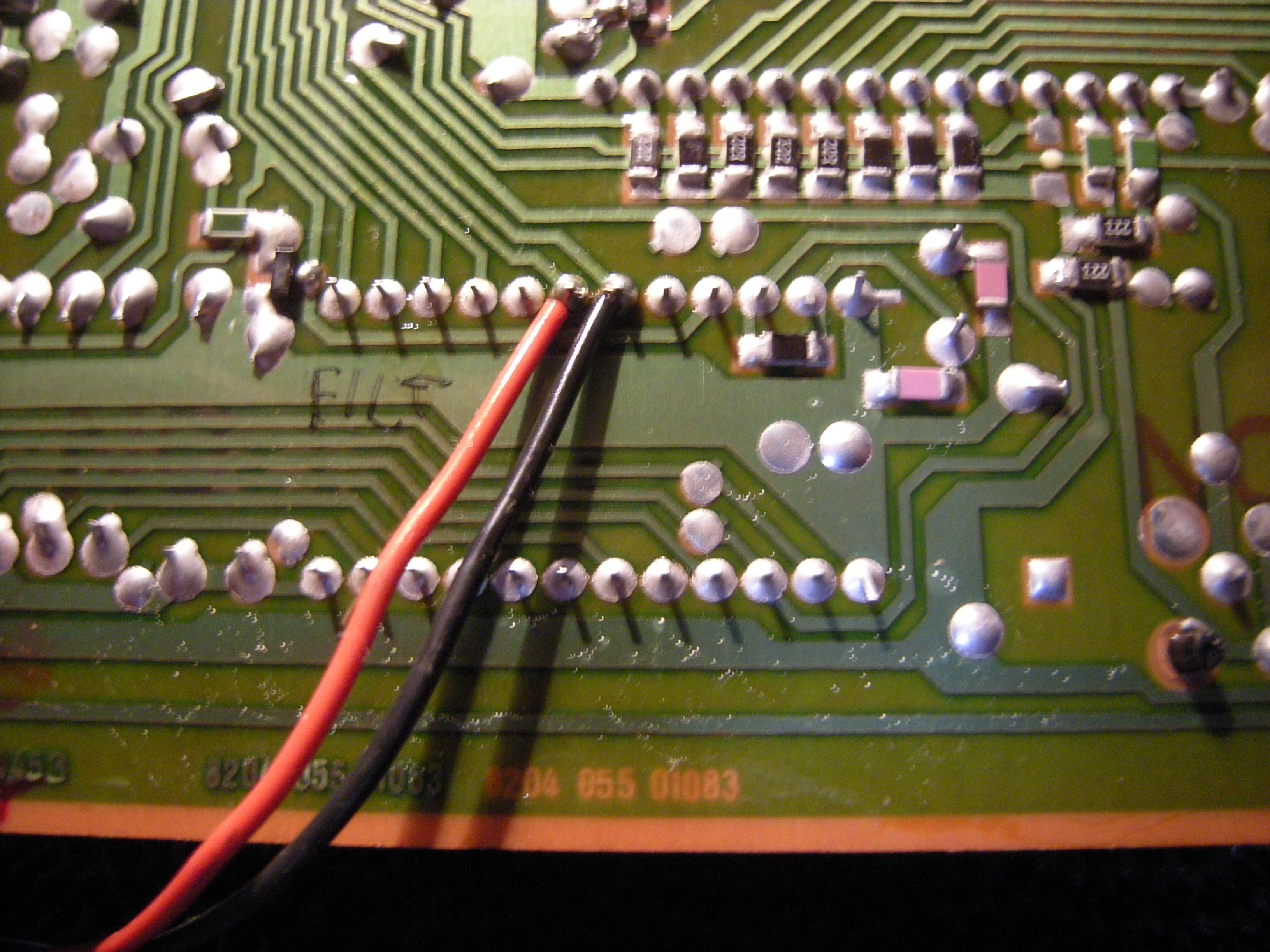

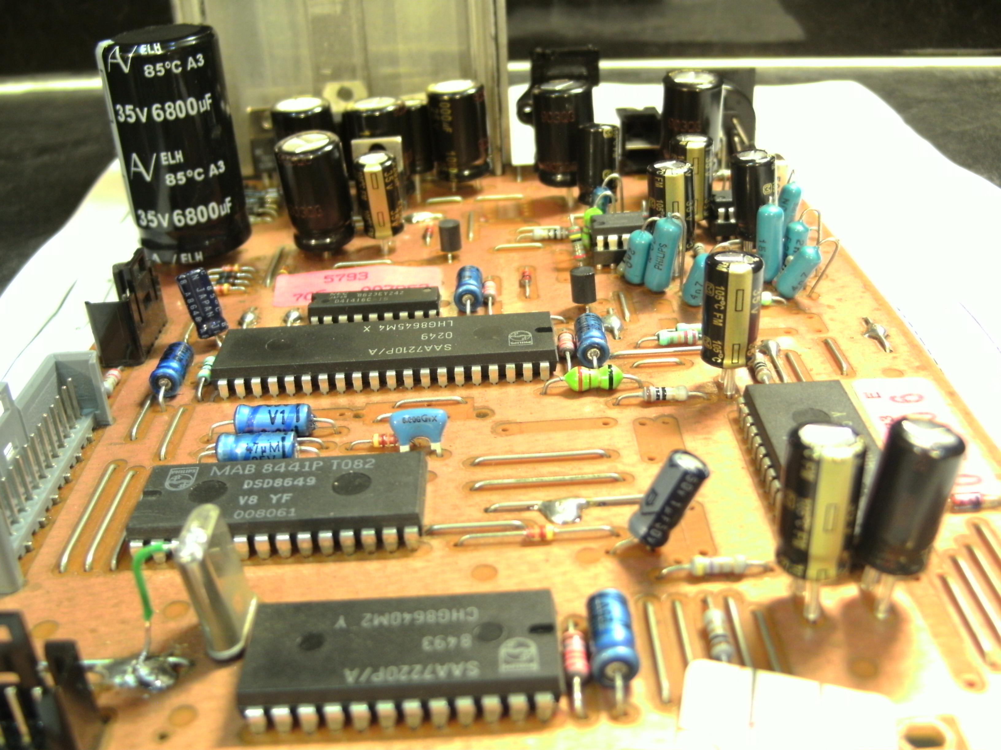

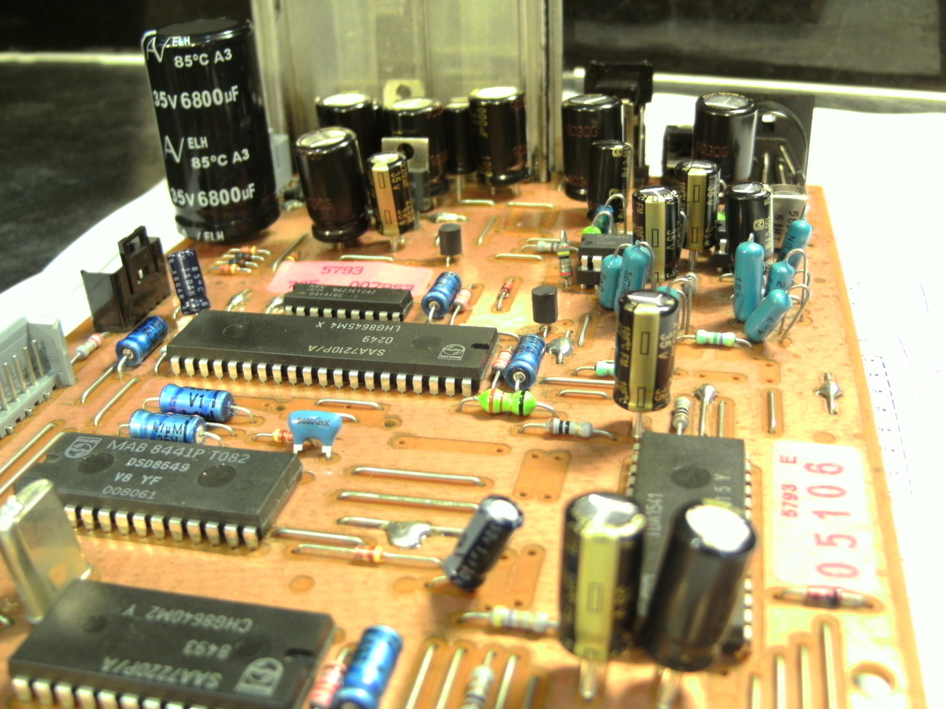

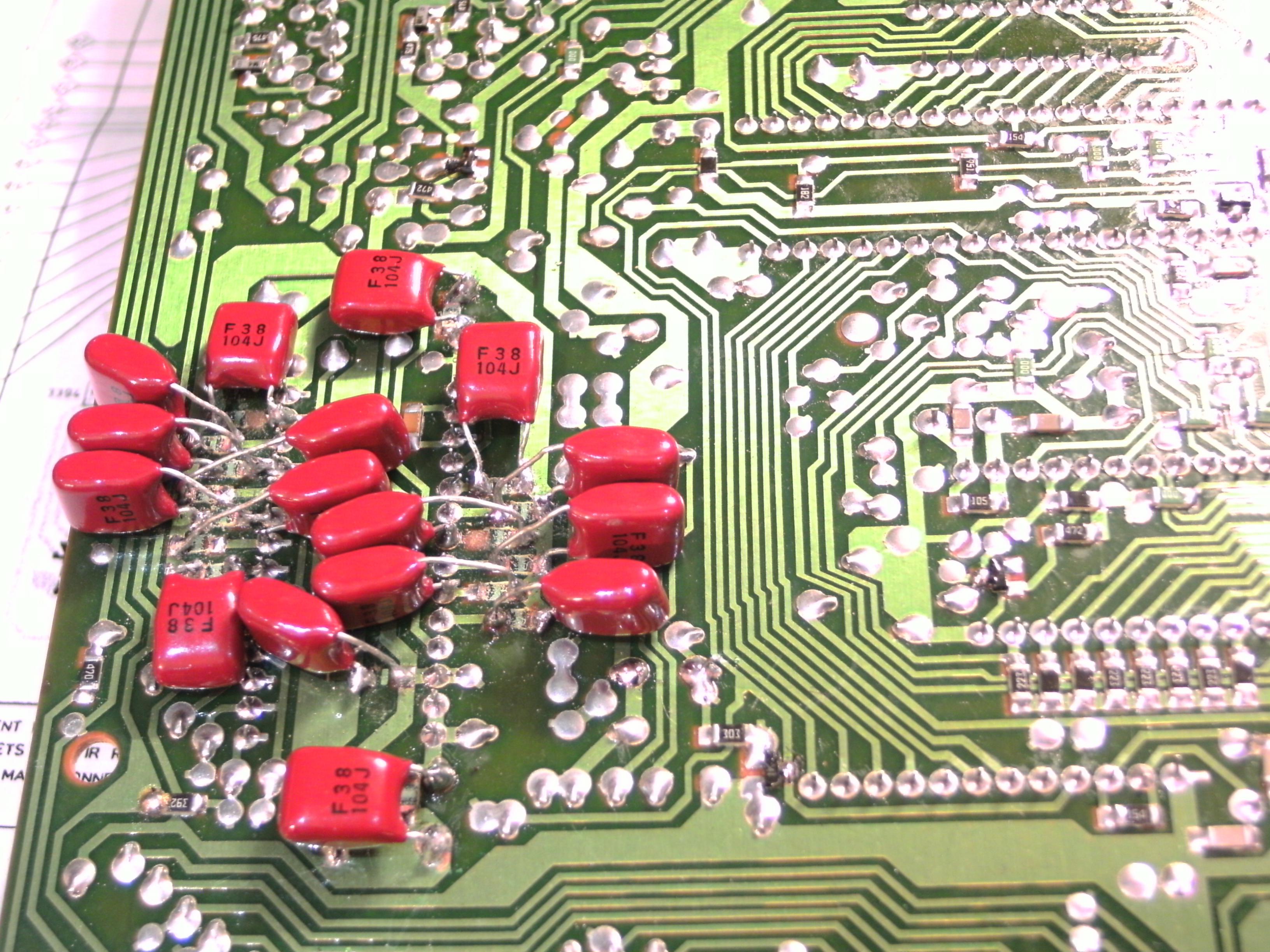

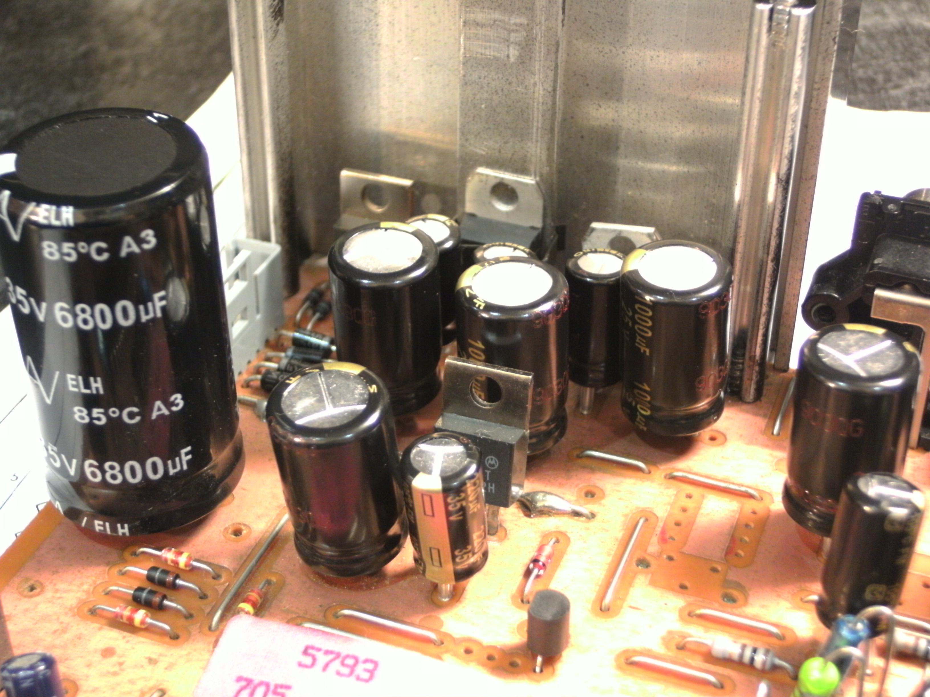

some piccies of work so far :) going to give it a good blasting for a while and then onto power supplies
thanks everyone for your input and any and all suggestions welcome and will put more up when i do it

nos mod done tonite :) got some transformers on order and some rectifiers to chuck in power supplies, struggled soldering wires for some reason and i used cat5 cable for nos job but i think outer wiring was contaminating the so;der joint !!!! gonna strip it back a lot more and redo joints as they just look dodgy and put silicon sheives on after or is there a better cable to try
anthony
Looking good! You're braver than me attempting the decoupling caps - have you listened to it since that mod? I find a little flux really helps with those thin cat5 cables btw, you don't have to apply the heat for as long so you don't strip the insulation.

the first mod i done was the decoupling caps and i really struggled getting them in so it ended up a little untidy !!! perhaps some smaller caps would of helped and i ended up moving a couple so i could get the board in :) if i done the same again i would of put some silicon tube on legs which iv bought now, this really did seem to open the player up and seem less harsh ( like in a copied cd from a 60's recording harsh) i could certainly put up with listening to it if that makes sense and my only comparision is my cd67 marantz which was still a heap load better at that point, putting an earth on and grounding the clock seemed to improve things after that listening test, strangely changing the caps and diodes didnt appear to do any more but when i done the nos mod it really does appeal now and id say i like it above the standard cd67 i use and you can hear a really nice soundstage and other things my marantz doesnt put across as luckily i can have them rigged on the same setup at same time so comparision is easy !!!!
i would certainly do the caps on next player as there was a noticable difference and iv also fitted some 8 dil precision turned chip holders in and put some new opamps in and i do play the same cds after every mod and looks like the old marantz will be next in line for surgery but i really do like this old player now at quite high volumes :)
i redone my cables as to your advice josh and you can clearly see they are soldered properly now and that worked a treat and i only used plumbers flux !!! it worked :) my decoupling caps would certainly be put in better after all this soldering practice
ordered some 250v 3.3uf decouling caps and some other bits today and have really enjoyed the challenge !!! just dreading that it dont work moment which is sure to happen mucking around this much so baby steps and keep running and tseting after every move !!!

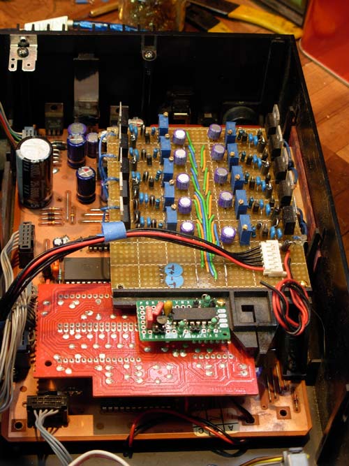

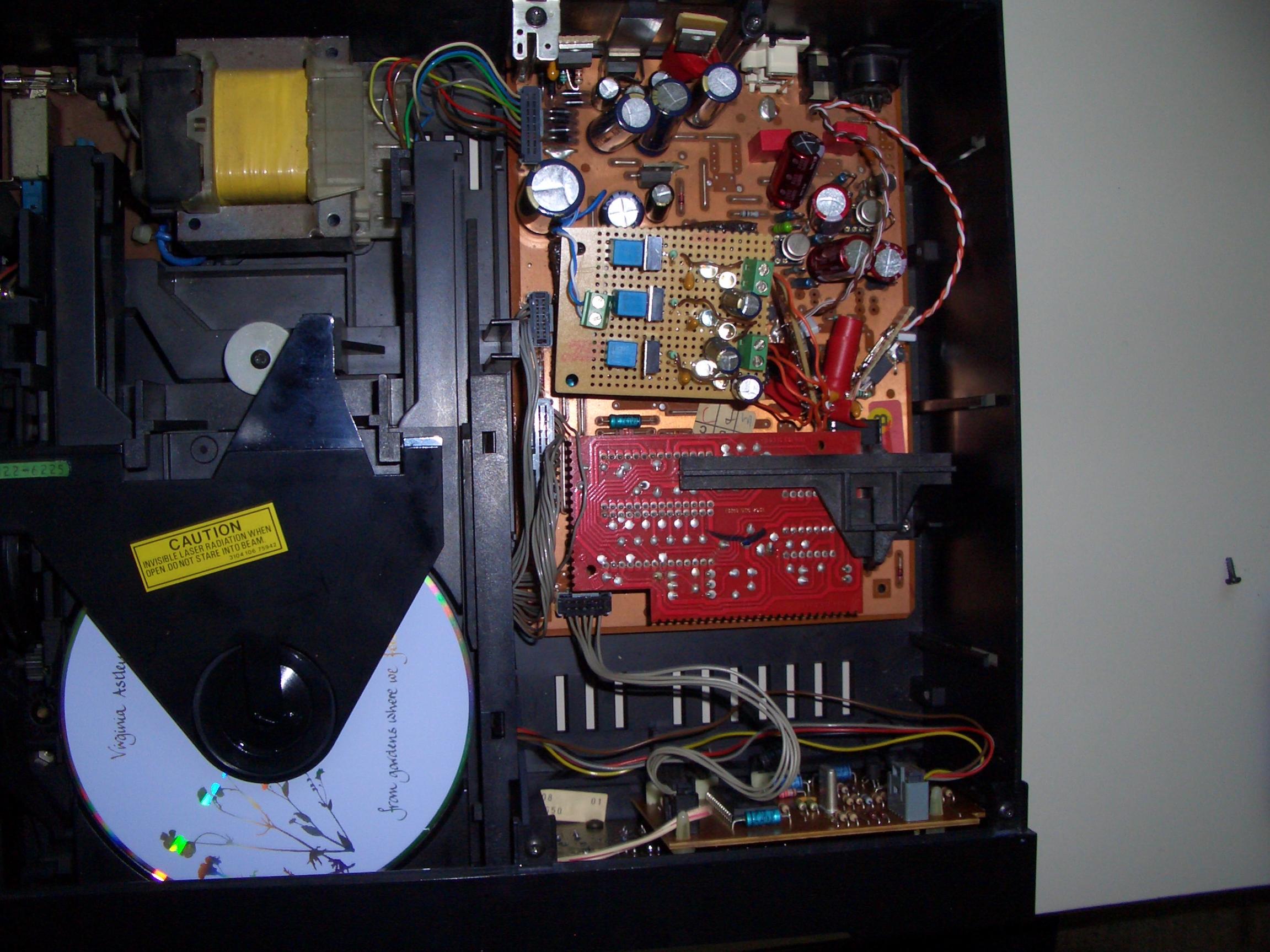

Here's another one.
Stage one of the modifications included fresh capacitors, new schottky diodes for the 23 volt and 11 volt rectifiers, 4.7uF metallized polypropylene output coupling caps and replacing the LM833 op amps with LME49860.
Stage two included adding ten new choke isolated, low ripple regulated power supplies based on LM317 and LM337 regulators to supply the DAC, the 7220 filter, the 7210 decoder and the RAM chip. The op amps also got their own individual supplies and are running at +/- 17V. AC is supplied by the original transformer. I also replaced 15 of the local bypass caps downstream of the regulators with higher capacitance Oscon SP solid aluminum caps.
Stage three will include wiring in the reclock module shown in the photo and replacing the DAC decoupling caps with 220nF polyester but won't be undertaken until I've had a good listen to stage two and done an A/B comparison with the other CD160 I have that has so far had stage one mods only.
