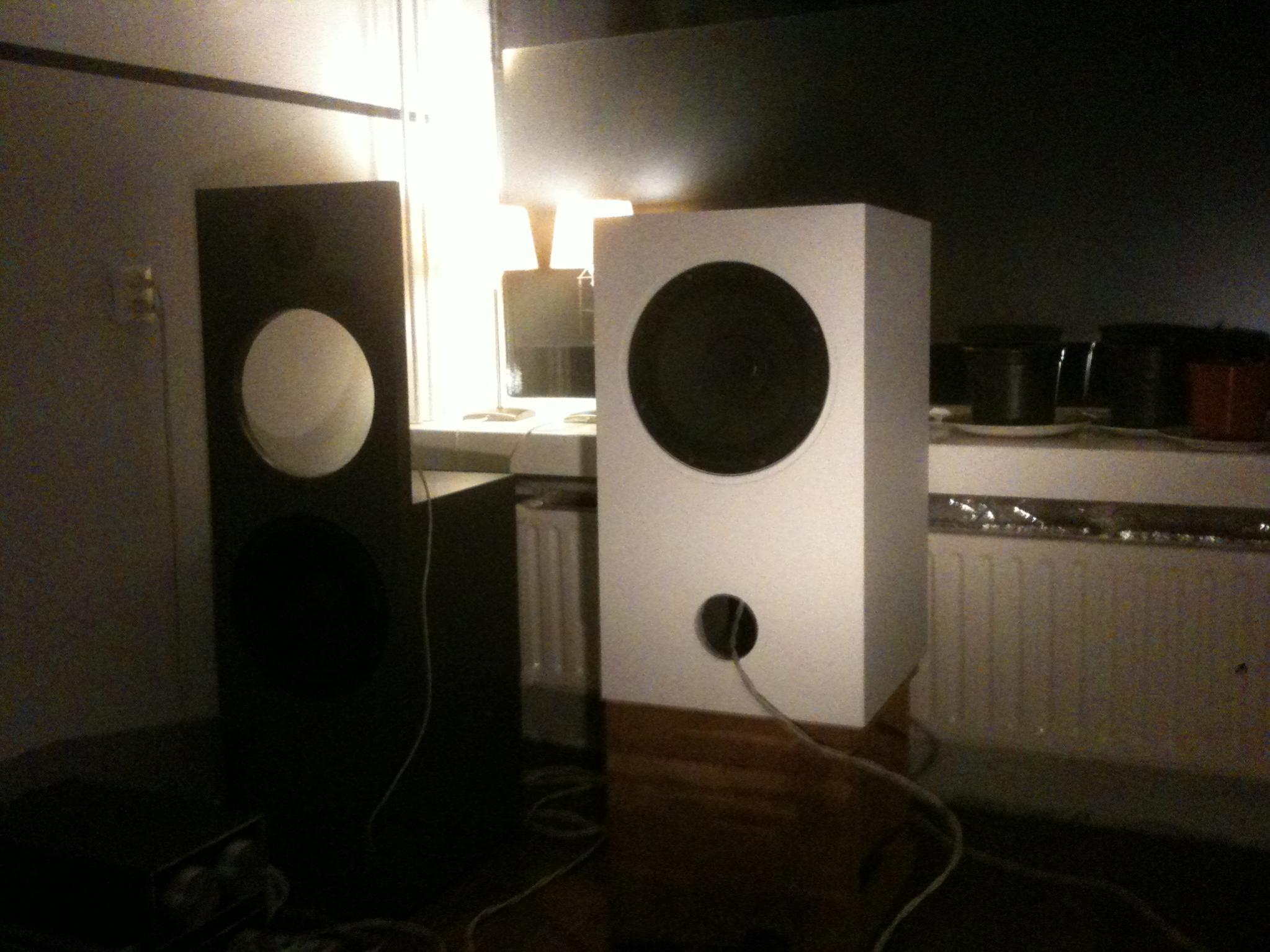

First, sorry for the very bad photo..
But Today I finally could press "Play" on my No knowledge an No budget build and listen....
So we have a very simple box, a 15.5 cm long +/-11 cm diameter port and a minimum of damping material (felt) No filter.
OH! My etc.... First I used an AD12200W Subwoofer to assist the AD12202 in the open baffle... well I don't need that anymore... It sound wonderfully! Yes there is another "Live" feelling compared to the open baffle and yes there is just a small "sweetspot" and there is some efficiency lost...but who cares!! it sounds great!!
I think (am sure) it could be tweaked to get even better, but for now the Bach Cello suites and the Live recording of Trentemoller etc... sound great...

Problems.....
It has been a while but I thought to let you all know where the project is right now...
To be honest there are problems...and I need help..
I wrote (a bit over enthusiastic) about the good listening results. And yes there where some things missing but I could only get better...well it didn't.
One off my precious AD12202M died...please don't ask why. Also don't ask why my pair off Philips AD12200W died in the same week... In the meanwhile I tidied up the cabinets and place them on beautiful Oak feet. After hours of sanding I am very much in love with the looks.
I quickly found a new pair once they sat in the cabinet it was very clear that they didn't sound the same as my old drivers. The cabinets now sit much lower on there stands as in the first listening test.
Conclusion it sounds bad....very bad to bright, missing bits and peaces etc.
Now I remember my now doubts mentioned in this thread but I also recall that the cabinets are big enough to try other drivers and other pieces of advice.
I am hoping on your advice again. So what to do? I myself have come up with a few options:
1. go for another 12" full range speaker (with or without helping tweeter)
Eminence Beta 12LTA+tweeter?
2. go for a 12" woofer and add a big tweeter
Eminence Beta 12A +Selenium D220Ti?
3. go for a 12" woofer and add midrange and tweeter
Philips AD12200W + PhilipsAD5060SQ8 + Philips AD0160
The last option is near to my weakness for Philips drivers but I am open for options...
