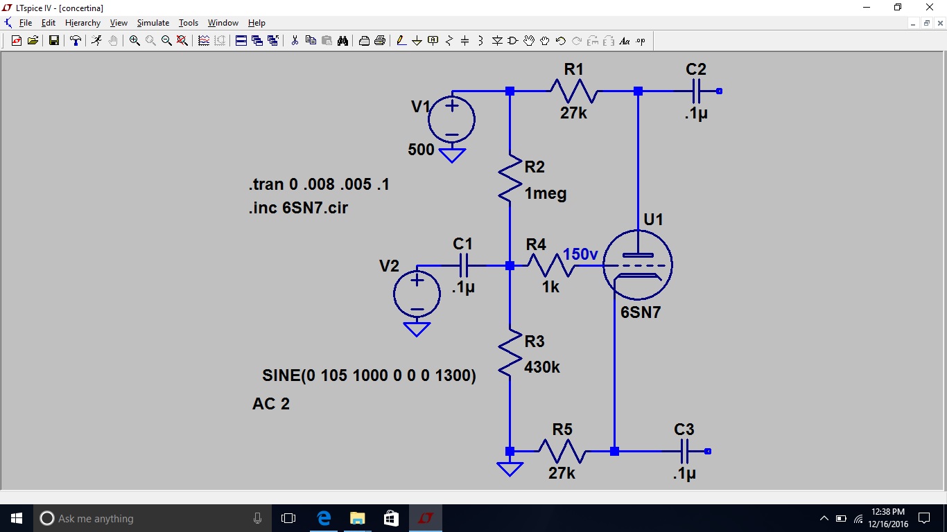

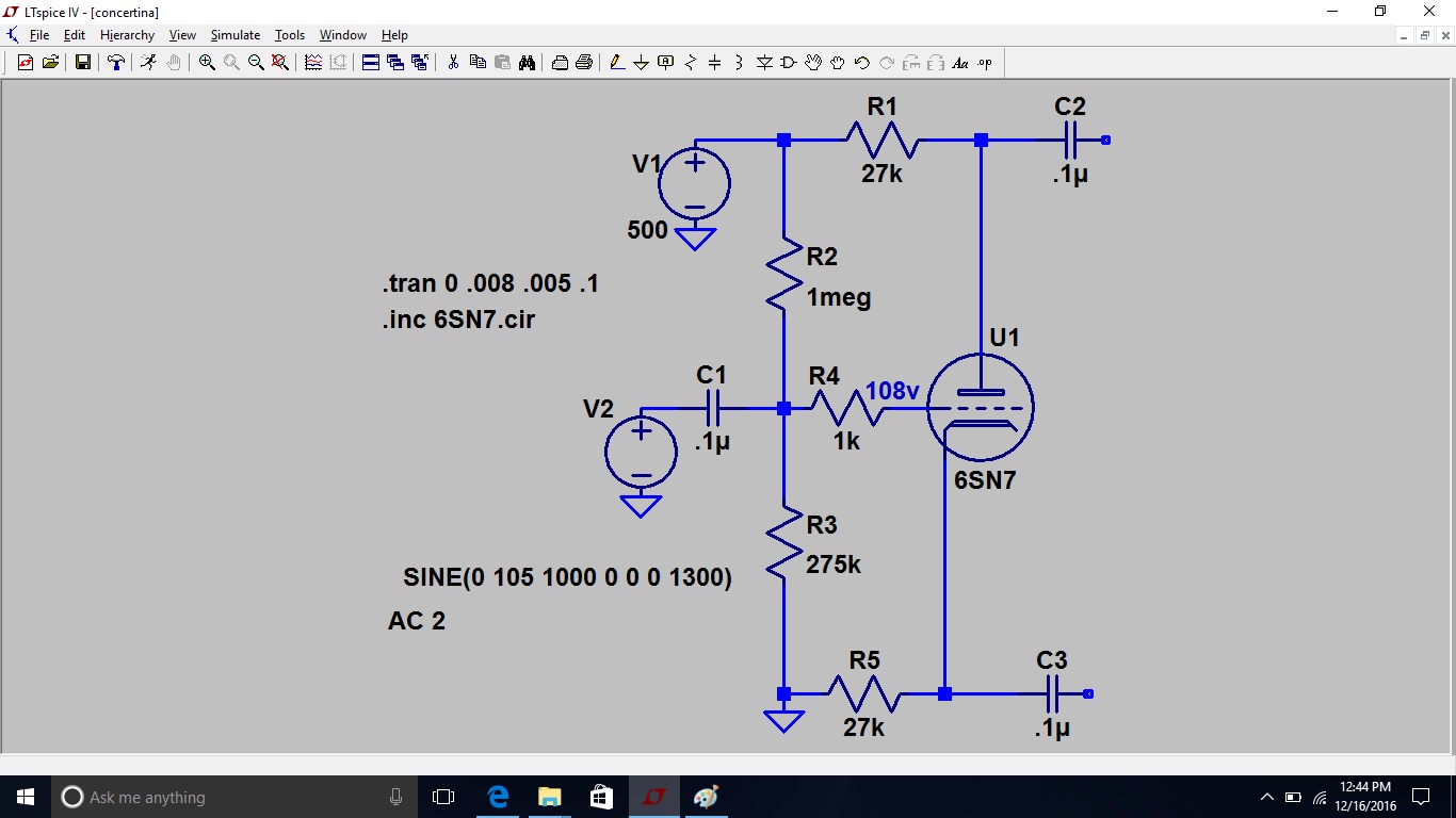

I decided to show what the theoretical capability of the cathodyne is, (pictures are worth a thousand words).
Here's the sim circuit biased at approx 1/4 rail voltage and 90v peak to peak output across each load (180 volts across both loads:

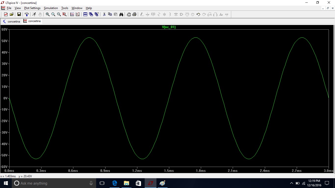

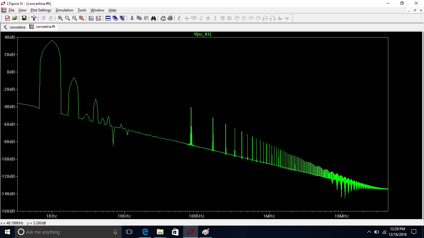

Here's the output waveform and the FFT of it at that level. Pretty good.
Notice that the first odd harmonic is over 80 db down. Most of the evens will cancel in the final stage.
Here is the waveform and the FFT for the same circuit driven at 50 P-P output:
The FFT shows virtually distortionless phase splitting. You definitely won't be worrying about distortion in this stage. It's output is pristine. In all these waveform so far the waveforms look and act outstanding. The FFT almost would seem to not be needed because the correlation seems so good.

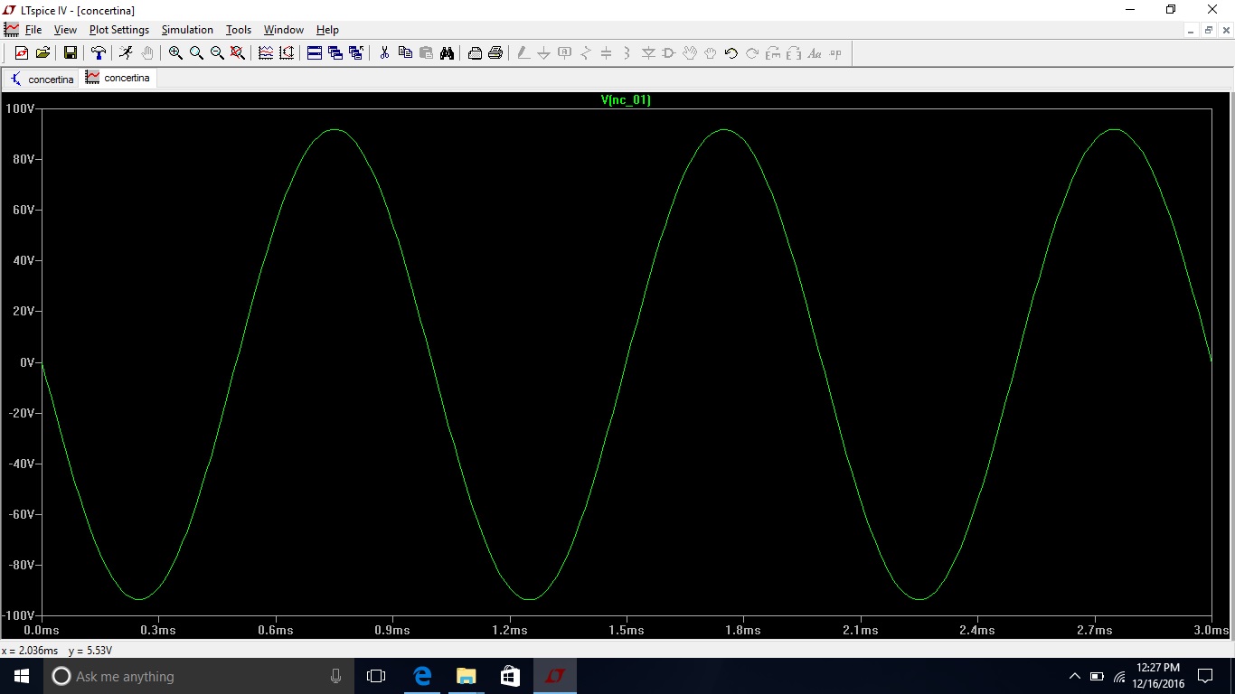

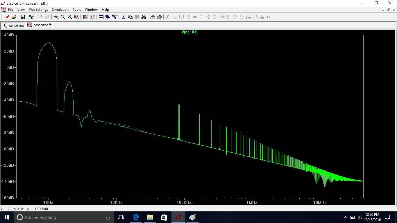

Here's the same circuit biased at approx 1/3 rail voltage, instead of 1/4:

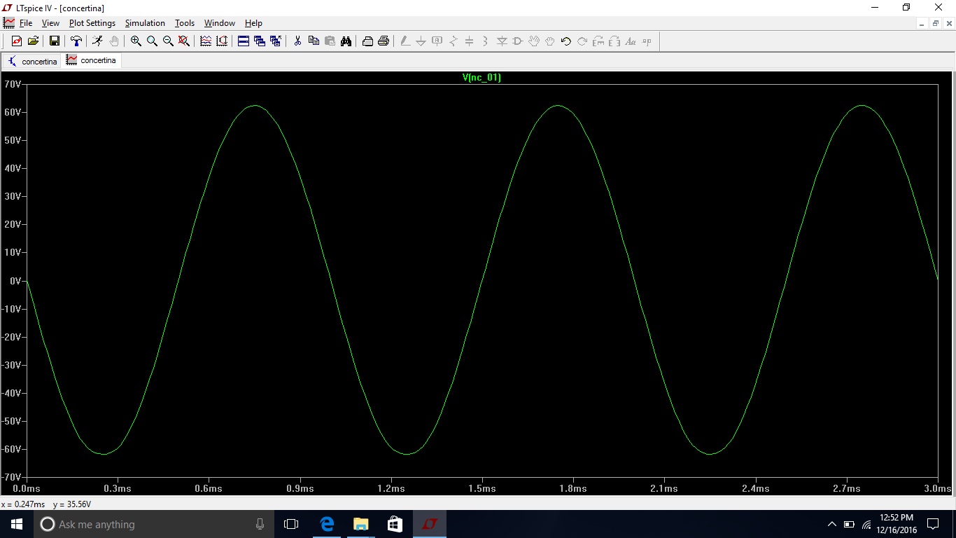

Here's the waveform and FFT for a 60 volt output.
Visually the signal out looks pretty good until you look at the FFT for it. It's pretty horrible. The reason is because the higher odd harmonics are much more objectionable as you go higher. (Don't worry about the 100khz spikes in all of the FFT plots. I think they are just a spurious anomaly.) Also I couldn't get close to 90 the volt P-P output without flat topping so I just left it out. Even with the decreased drive it doesn't look close to the 50 volt PP when the cathodyne is biased at 1/4 rail voltage.
Oops, should be 180v peak to peak and 360 v peak to peak differential across both upper and lower loads.

… ⅓ rail … Visually the signal out looks pretty good until you look at the FFT for it. It's pretty horrible. The reason is because the higher odd harmonics are much more objectionable as you go higher. (Don't worry about the 100khz spikes in all of the FFT plots. I think they are just a spurious anomaly.) Also I couldn't get close to 90 the volt P-P output without flat topping so I just left it out. Even with the decreased drive it doesn't look close to the 50 volt PP when the cathodyne is biased at ¼ rail voltage.
Seriously … just don't drive it at AC 105V … drive at 77V instead, and its FFT goes to a nice –80 dB (just like the ¼ rail case)
Or as the saying goes, “Changing 1 thing almost always requires rescaling other things…”
