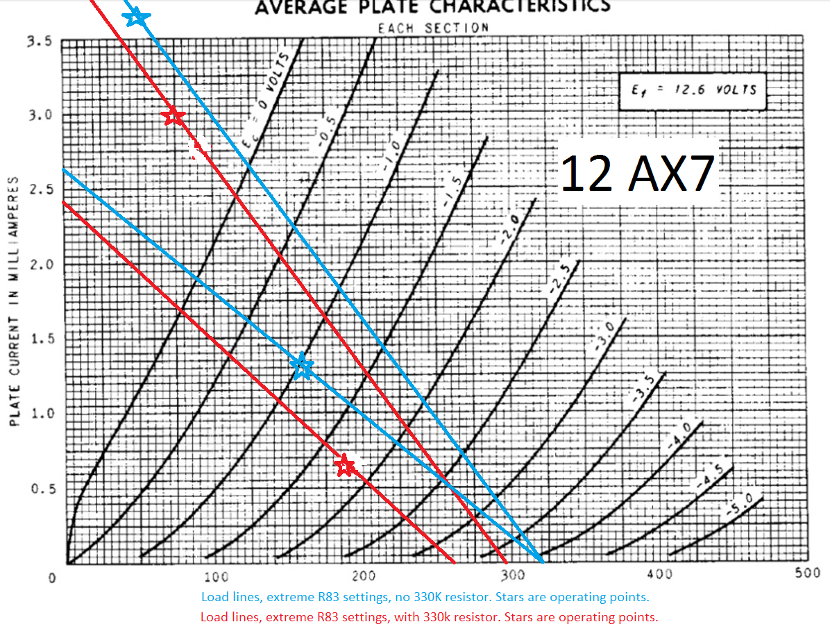

I finally drew some load lines and confirmed that the reason for the 330k resistor is to create a good operating point for the cathodyne. Operating point does not look good (too close to Vg=0 line) at more than 2mA (what it would be without the 330k resistor). Dropping the operating point by ~2/3 of a mA (which the 330k resistor does) makes things much better. The 330k is meant as a fix to create a good DC operating point, not as something to inject ripple for cancellation in the output stage (which it wouldn't be very good at anyway, due to its large value).
This has me wondering how my amp that has this resistor removed works as well as it does (it sounds just fine). I assume it must be swinging the cathodyne grid somewhat positive. Maybe I should put that 330k resistor back in.
Doesn't the setting of R83 overwhelm the effect of the 330k resistor?
Sort of. Conditions are such that there is no way to get AC balance and a good operating point without the 330k resistor, given the supply rail and DC grid voltage imposed by the previous stage on the cathodyne.
The 330k resistor is a Band-Aid fix to make the DC conditions work out. Draw some load lines and it will all make sense. Actually, you don't even have to draw the lines, just plot the DC operating points with and without the 330k resistor.

That pot setting is the difference between drawing 1.3 and 3.7mA, assuming a cathode voltage of 100V as shown on the schematic. I'll take your word that the value of the 330k is apparent if you draw some load lines, but I find that surprising considering the effects of the pot.
Sure, you can crank the pot to get to a workable operating point (one that doesn't require positive grid voltages) but it won't give you good AC balance at the same time. The 330k resistor makes it possible to get both with 100V on the grid.
Well, now I feel a bit silly because it just occurred to me that you could easily just increase the resistance of both the anode and cathode resistors and accomplish the very same thing. So now I am back to not seeing any good reason for the 330k resistor again.
Here's what I get for the load lines with and without the 330K resistor and the operating points at the extreme settings of R83. Unless I miscalculated, a good portion of the pot range will lead to grid current being drawn. And in comparison to the pot settings, the effects of the 330k resistor seem small.
In my opinion, it should have been designed to preclude the possibility of grid current being drawn.
