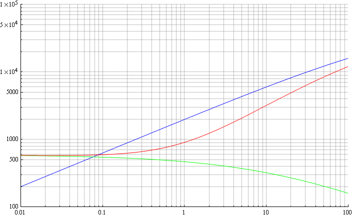

CPaul noted a problem with my graph. Looking again I see that I was using 20k/200R as the limits of the load resistances, not 10k/100R.
Altogether I made a bit of a mess of it, didn't I! OK, Here is the corrected corrected version. I also added the 'effective' output impedances to show how they converge when Ra = Rk.

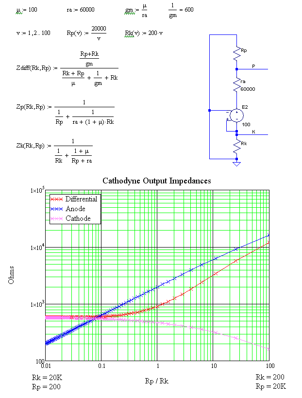

Now when Ra=Rk, Ra and Rk are 2000 ohms each; is this correct?
Is either the Anode output Z, or the effective Anode output Z equal to the plate to ground impedance?
I have shown the driving point impedance to anode and cathode on my plot as the blue and green curves. These are the impedances taken one at a time from anode or cathode to ground.

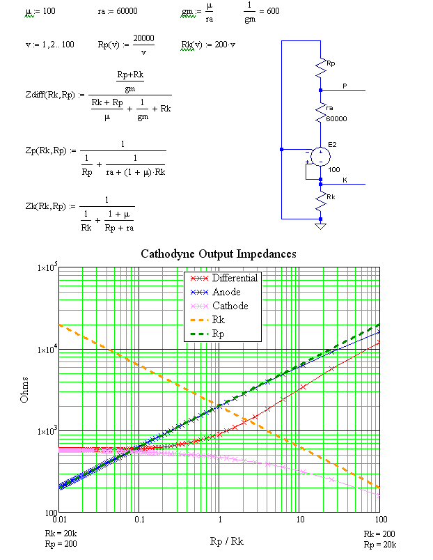

With the value of Ra and Rk each being 2000 ohms when Ra/Rk=1, I get a slightly different graph:
My results track those of The Electrician exactly. I show the equations I used and the calculations performed by MathCad in the attachment.
I am particularly suspicious of the value Merlin shows for anode output impedance when Rk = Rp = 2K. How can the impedance across a 2K resistor be about 10K? There are also much smaller deviations between Merlin's and our results for differential and cathode impedances in the range where Rp/Rk goes from 1 to 10.
I would appreciate it if Merlin would post the equations for and discuss what he calls 'effective' impedance. I'm not familiar with that term.
Ah! I see what happened. We chose different sets of Rk and Rp points ro graph, although our endpoints were the same. That explains things.
I've updated my graph to show the values of Rp and Rk that The Electrician and I used, with Rp = Rk = 1k at the center point. Merlin's selection of values had Rk = Rp =10K in the center.

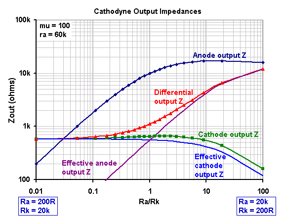

Merlin, could you post an updated version of your graph which shows the values of Rp and Rk that you selected? No doubt your results are good for your values, but it's a little unclear, at least to me, what they are.
Also, could you please explain and post equations for "effective" impedances?
Thanks.
Graph updated. I set the limits at 10k this time since it's probably easier to think in tens, and it plots nicer too.
Zdiff = ra(Ra+ Rk) / [ra + Ra + Rk(mu+1)]
Za = 1 / [ 1/Ra + 1 / (ra + Rk(mu+1)) ]
Zk = 1 / [ 1/Rk + (mu+1)/(ra+Ra) ]
The 'effective' output impedances are simply the differential output impedance divided in the same ratio as the two load resistances.
Za(effective) = Ra.Zdiff / (Ra+Rk)
Zk(effective) = Rk.Zdiff / (Ra+Rk)
Thanks, Merlin. I don't know if it's my browser or what, but if you updated post 879, I still can't open that graph. Maybe SY can help again?
I see how you calculated the 'effective' output impedances. Is there some way to measure them directly? Do they have some practical value?

Where was your graph with the Rp and Rk values posted?
Post #879. If you can't see an image you should still see a link?
Would you kindly answer my questions about effective impedances?
They're not REALLY useful. You can use them to find the bandwidth, but only if the capacitive loads are in the same ratio as the resistive loads (e.g., post #786), which is unlikely except for the usual balanced condition.
