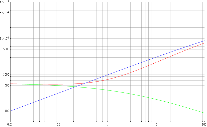

I thought it might be interesting for any lurkers to see what happens to the differential output impedance (Zak) as you gradually unbalance the cathodyne. This graph shows an example for an ECC83 / 12AX7 as the anode load (Ra) is varied from 20k down to 100ohms, while the cathode load (Rk) is simultaneously varied from 100ohms up to 20k.
Starting inthe middle where the loads are equal (Ra/Rk=1), the differential output impedance is roughly equal to the cathode output impedance.
Reducing Ra has only a small effect on the differential output impedance, whereas reducing Rk causes a large increase in Zak.
In the limits Zak becomes equal to Za or Zk.

You're right, that should be 10k and 100ohms. The 20k bit goes off the end of the graph!Also, I'm a little confused by the x axis. If Ra/Rk = 100, I don't think Ra could be 20K while Rk is 100ohms.

When you post a graph like this it would be a great help to those who would like to duplicate your result if you would state explicitly the values you used for rp, u and any other relevant parameters, rather than just saying "This graph shows an example for an ECC83 / 12AX7".

They were written on the first graph, but I forgot to add them to the corrected version. They were:What values did you use for the relevant parameters?
mu = 100
ra = 60k
I get a substantially different result. When Ra/Rk = 1, Ra=1000 and Rk=1000. When Ra=1000 ohms, how can the anode output Z be as great as 10000 ohms?
Even though, as you say, "The equations are the usual ones- they've been posted plenty of times already.", it might help track down the source of the difference between my result and yours if you would post the equations you used to generate your plot.
I didn't use derived equations, but rather just solved the admittance matrix for the Cathodyne numerically.

CPaul noted a problem with my graph. Looking again I see that I was using 20k/200R as the limits of the load resistances, not 10k/100R.
Altogether I made a bit of a mess of it, didn't I! OK, Here is the corrected corrected version. I also added the 'effective' output impedances to show how they converge when Ra = Rk.
