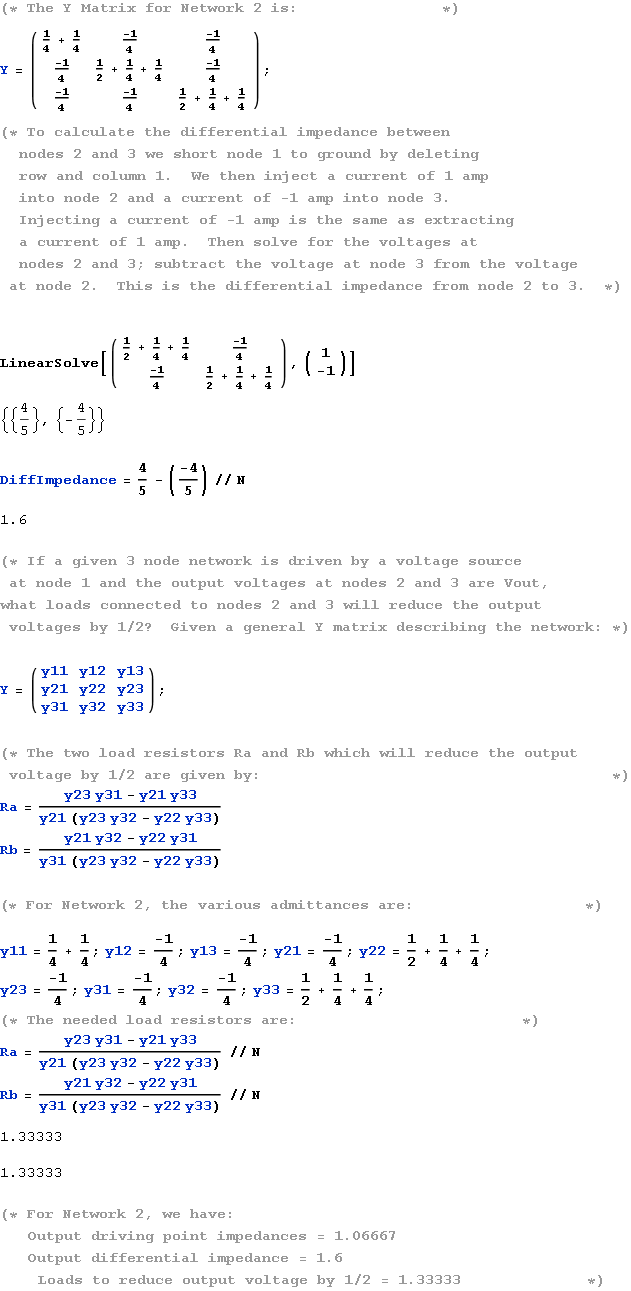

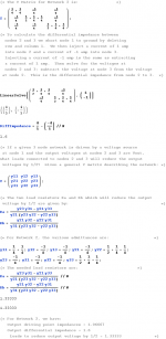

It's the same as the first one except for the additional 4 ohm resistor between nodes 2 and 3.
The output (driving point) resistance at nodes 2 and 3 separately is 1.066666667 ohms. Don't forget to ground node 1 when making this calculation.
The voltage gain from node 1 to nodes 2 and 3 is .3333333333. This is to be expected since the additional 4 ohm resistor is connected between two nodes that have the same voltage when a source is driving node 1; it draws no current and has no effect on the output voltage.
What additional loads applied to nodes 2 and 3 will cause the gain to those nodes to be 1/2 of its previous value? One might think that it would simply be resistors equal to the output resistance. Let's try it. Add a 1.06666667 ohm resistor from node 2 and node 3 to ground, and calculate the gain to those nodes. The result is a gain of .148148148. But we expected a gain of .166666667; what went wrong?
The problem is that there is coupling between nodes 2 and 3 due to the 4 ohm resistor we added. If we go back to Network 1 and imagine injecting some current into node 2 and measuring the voltage produced at node 3 (remember, node 1 must be grounded for these measurements), we can easily see that there will be none. In other words, the transfer impedance is zero; there is no coupling between nodes 2 and 3.
Do the same with Network 2; ground node 1, inject 1 amp into node 2 and calculate the voltage produced at node 3. The result is .266666667 volts, and since 1 amp was injected, the transfer resistance is .266666667 ohms. Does this help us find the load which will reduce the voltage gain by 1/2? Yes. The required load is the sum of the driving point impedance and the transfer impedance. So, connect a 1.3333333 ohm resistor from nodes 2 and 3 to ground and calculate the voltage gains to nodes 2 and 3. The result is a gain of .166666667, which is half the gain without the additional load.
One could have noticed that because of the extreme symmetry of the circuit, the additional 4 ohm resistor doesn't affect the gains. But it does change the output (driving point) resistance at nodes 2 and 3 (as determined separately), so from one point of view it's clear that the same load resistance that we used with Network 1 will also work with Network 2. But, we also have been told that load resistors equal to the output resistance should reduce the gain by half, which is not true for this network. Using the transfer resistance leads us back to the correct loads.
A differential output resistance of Network 1 could be measured by connecting an ohmmeter between nodes 2 and 3. If this is done, the ohmmeter will inject a current I into one of nodes 2 or 3, extract a current I from the other node and measure the voltage between the nodes(extracting a current I from a node is the same as injecting a current -I into that node). The voltage between the nodes divided by the current I gives the differential resistance.
It's easy to see that the differential output resistance of Network 1 is 2.66666667 ohms, and of Network 2 is 1.6 ohms. Adding the extra (differentially connected) 4 ohm resistor in Network 2 changed the differential output resistance, changed the driving point output resistances, but did NOT change the load resistances necessary to multiply the voltage gains to nodes 2 and 3 by 1/2.
We calculated output (driving point) resistances of 1.06666667 ohms for Network 2; why did we need loads of 1.3333333 ohms to reduce the gain by half? With Network 1, the required load was equal to the calculated output (driving point) resistance but not with Network 2. Does this mean that the output resistance of Network 2 changes to 1.33333333 ohms when we add two loads instead of just one?
No. The problem is that the classical voltage divider formula only works for one output at a time. In fact, if you add a 1.066666667 ohm resistor from node 2 to ground in Network 2 (but not from node 3 at the same time) and calculate the gain to node 2, it will be .166666667, half the previous value. The 1.33333333 ohm value is not an output impedance; it is the sum (it would be the difference if one of the gains had a negative sign) of the output impedance and the transfer impedance. It is a number which will give you the voltage gain when used where you shouldn't use it, in the voltage divider formula (applied to 2 nodes at a time), which is only guaranteed valid for one output at a time. We can see that the voltage divider formula, using the actual output impedance, is not ALWAYS valid when used for more than one output at a time. It is invalid when the network has non-zero transfer impedances connecting the nodes in question. In that case we can derive a another number (which is not the output impedance) which will work in the voltage divider formula for two outputs at a time (when I say it will "work" I mean that it will reduce the voltage to a node by 1/2 when applied as a load). But this does not mean that the number is the output impedance of the network. Some might be tempted to call it an "apparent" output impedance. And, of course, the only time one such number will work for two outputs simultaneously is when the network has a high degree of symmetry, like Network 2.
Network theory teaches that passive networks like these are completely characterized by their driving point impedances (this is what would normally be meant by the term output impedance) and their transfer impedances.
Unfortunately, I think, even though this procedure is not mathematically valid for networks that have a non-zero transfer impedance between two nodes under scrutiny, it nonetheless works for the Cathodyne, which does have non-zero transfer impedances between plate and cathode. I will demonstrate this happenstance in further posts.

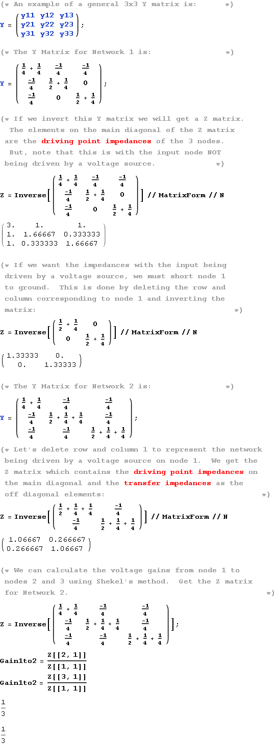

Starting with Feldtkeller, network analysis has been systematized by the use of matrix algebra. Two common methods of network analysis are the nodal method and the loop method. The nodal method leads to a matrix of admittances, the Y matrix. The loop method leads to a matrix of impedances, the Z matrix.
A general Y matrix is often shown like this:
[ y11 y12 y13 ]
[ y21 y22 y23 ]
[ y31 y32 y33 ]
The number of rows and columns in a Y matrix correspond to the total number of nodes-1 in a network. One of the network nodes is taken to be the reference node, usually circuit ground, so a 3x3 matrix will represent a network with 4 nodes, one of which is ground. It is customary to assume ground is the reference node, so it isn't counted when we say that a 3x3 matrix represents a 3 node network; the reference node is assumed and not mentioned.
I'll mainly be using a 3x3 matrix because the simple Cathodyne circuit has 3 nodes, as did the two networks I discussed in the previous post.
Modern mathematical programs, such as Mathematica and Maple can solve matrix equations, even with symbolic rather than numerical elements. This removes most of the drudgery from analysis of even rather complicated networks. There are also free programs such as Scilab and Maxima that can do the job. Even some modern hand held calculators can do symbolic matrix algebra, such as the HP50G and TI89.
In November of 1952, Jacob Shekel published a paper in the Proceedings of the IRE describing how to use matrix methods to analyze transistor circuits; the same methods apply to vacuum tubes as well. I'll be using some of his techniques. I explain the methods starting at post #43 of this thread:
Two stage BJT amplifier with feedback - All About Circuits Forum
The two attached images show how to form the Y (admittance) matrix for Network 1 and Network 2 from the previous post. Then several properties of the networks are derived using matrix algebra and Shekel's method with Mathematica.
The attached images are .png files and are rather tall. They can be conveniently viewed with Firefox. Position the cursor over the image and you should see a tiny magnifying glass. Left click and you'll see the full size image and you can scroll up and down.

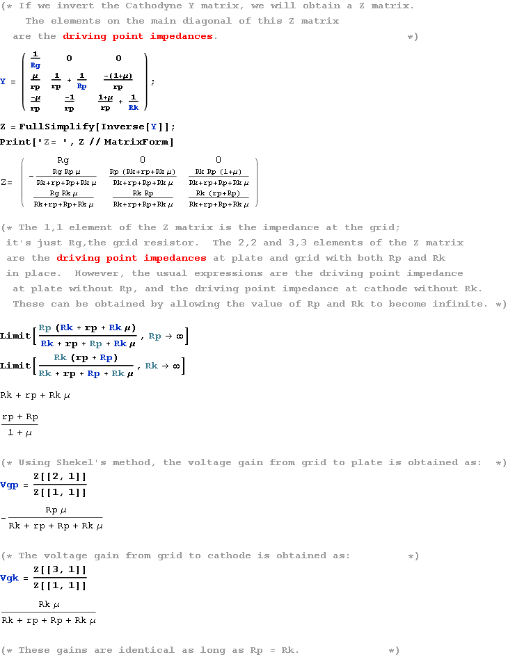

The attached images show the Y matrix for the Cathodyne and the results of manipulating it with matrix algebra in Mathematica.
This technique allows one to derive any property of the circuit rather easily. The drudgery of substantial symbolic algebra is taken care of by the computer.
To find the driving point impedances at the plate and cathode one need only invert the admittance matrix.
The impedance for balanced loads is the differential impedance which is also easily derived as shown.
This method of analysis automatically takes care of the case where the loads are not perfectly balanced. Whatever the loads are equal or not, slightly unbalanced or greatly unbalanced, the analysis will be correct. There's no need to resort to "apparent" impedances, or the like.
I show a somewhat complicated expression for load resistors (Ra and Rb in the images) that will reduce the voltage gain by 1/2, and I show that this gives exactly the same result as the calculation of the differential impedance. This is only true for a circuit whose Y matrix has substantial symmetry is the lower right 2x2 submatrix, which the Cathodyne does.
I'll show the effects of unbalance due to stray capacitance in later posts.

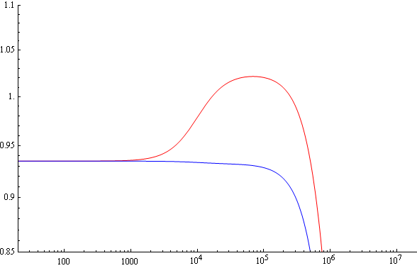

The attached image shows the voltage gain vs. frequency for the Cathodyne in SY's article in Linear Audio with 1000 pF shunted to ground from the plate and 1100 pF shunted to ground from the cathode.
This is the difference in response caused by a 10% unbalance in capacitance loading. I used relatively large capacitance to get the lowest corner frequency just into the audio band.
The red curve is the response at the plate and the blue curve is the cathode response.
This result was obtained with Shekel's method and the Y matrix for the Cathodyne from the previous post.
