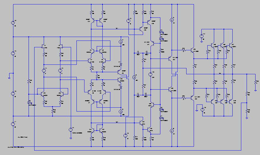

Hi Bob,
First, thank you for your kind and thoughtful comments.
Regarding bootstrapping, it is not the VAS that is bootstrapped, rather the +/-24V power supply of the input stage that is tracking the input voltage. Please have a look at the schematics: http://home.tiscali.nl/audio/FrontEndSch.html and: http://home.tiscali.nl/audio/MPSUSch.html
In doing so the Early effect (which is hard to simulate btw) has no chance at all to spoil the amp, as all Vce's of the trannies in the input stage are held at a constant level. Don't worry about HF instabilities, as this kind of bootstrapping is quite harmless. To be on the safe side, we shunted HF signals by means of C35 (390pF).
Also the NDFL stage is bootstrapped, this time by means of simple resistive dividers (R32,33,37,38).

Bob Cordell said:Hi Edmond, you are most welcome for the appreciative words, and your effort here is very deserving of it.
I must admit, I was confused enough about the bootstrapping that it was not a typo, but it was also not backed up by a lot of thought. Is it the VAS that is bootstrapped to the output signal?
Two things usually cause me to exercise caution when bootstrapping. I do use it, by the way, in some cases. The first thing that worries me is the possible appearance of some unwanted feedback, maybe even positive, at high frequencies. The second is that the circuit may behave in unanticipated ways under clipping or fault conditions.
Regarding the d.c. servo, I always seem to have +/- 15 V lying around, so that is not a problem. Audio-grade op amps should be used in servo circuits, but it is a misconception that when properly used in a servo circuit they need to be as good as the signal path. In a poorly designed servo, where the output of the op amp was only minimally attenuated before being applied to the amplifier input, one would have to have an exceptionally good one. If, on the other hand, its output is attenuated by 100:1 or even 1000:1, depending on amount of correction needed, it need not be as good (i.e., not garbage, but good audio grade, at least as good as an OPA604, for example).
Although there are some pretty good electrolytics out there, there is enough anecdotal information on capacitors so as to avoid electrolytics. The dc servo integrating capacitor should be decent, such as a polypropylene or better. My view is that if you believe that capacitors in the signal path can make a difference, then you virtually never put an electrolytic in the signal path. Of course, some people mistakenly think that a shunt capacitor in the feedback path is not in the signal path .

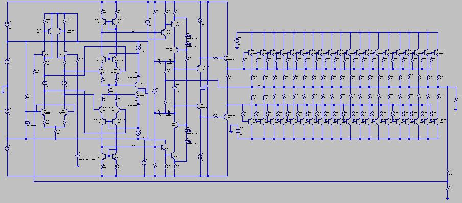

Hey Edmond.
Sorry if a bit off topic, but you can tell me off if so. Here is a preview of the schematic that I promised to send you of my 300W TMC EC amp (based on the 12W one).
LTP loads are 3k, fancy duals used for the LTP’s and I mirrors and 0.1% matched resistors for accurately defined currents, thus no VAS fighting problems. Close to 40dB gain per LTP.
This is a simplified schematic for initial simulation purposes – no EC yet and only 3 output pairs biased at 3A for 150W class A into 8 ohms (final circuit will have 20 pairs and 6.25A bias).
I also haven’t included the clipping VAS voltage swing / current limiting clamps yet.
Still a crude OPS and I have only used ordinary bjts for most of the small signal trannies and I haven’t added the EC to the output stage yet, but the circuit is simulating 5ppm THD-20 at 150W rms into 8 ohms.
I've added a dual Jfet buffer (U404) to the front end, so no need for big caps or a servo. Offset null trimpot will be put in the emitters of the bjt CCS pair biasing the jfets.
Glen

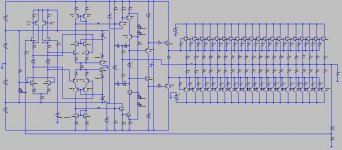

OK, here is the MKII sim version. The jfet input buffer was adding a ppm or so to the closed loop THD, so I fixed that by using a MAT03 PNP dual to make a pair of CFP's with the U404. The MAT03 is a nice low noise device with high Cob, which effectively miller compensates each CFP and makes them unconditionally stable.
Still no EC and the TMC is a bit over-compensated at fT=~1MHz, but have added the rest of the 20 output pairs and cranked the bias up to 6.25A.
THD-20 at 300W RMS into 4 ohms sims 5.38ppm
Glen

As everybody knows, paralleling different voltage sources mean trouble, also in this case. As a result, high common mode currents will circulate, which compromise the performance.
BTW, this is the reason why Bob and his buddy Brian shy fully complementary topologies.
I really don't see this as as having to be much of a problem at all. In my design the LTP gains are rather accurately defined/matched by the emitter degeneration and the resistive loads which also serve the purpose of biasing the VAS buffer emitter followers. The VAS gains are accurately matched by virtue of the 100R emitter degeneration resistors and each VAS sees an identical collector load as the collectors are essentially connected together anyway – no gain tracking problems there.
The miller compensation capacitors corner with the resistive load, so the HF roll off of each VAS is accurately defined. So long as the miller compensation caps are matched to 1% or so the HF roll off of each VAS will track quite nicely too.
Not sure that the circulating currents due to gain missmatch will be very high either. A miller compensated VAS can have a very low output impedance at 1MHz and look quite like a voltage source, but what is it at 20kHz? Several k in my design.
Edmond Stuart said:
I have to leave now, but later on I've a look at your design.
Whadda ya think of my CPF Jfet input buffer? for symetrical BJT LTP inputs?
Consider the merits:
1) Very Low THD
2) Low noise
3) No input resistor bootstrapping required for high input impedance, so no funny LF behaviour.
4) No capacitors (inc big electrolytics) required.
5) No servo required.
6) High Zin
Glen
Re: Re: Re: Re: Your amplifier
Hi Edmond,
Thanks for these answers. I will indeed have to spend more time looking at the schematic.
Regarding the matter of the shunt capacitor in the feeback path, that comment was in no way directed at you. When I take the time to raise issues on this forum, I am usually trying to adrress in an educational way all of the readers. What I said is, unfortunately a true statement, but it was not directed at you.
While I agree that in many cases people can get away without a coil on amplifiers that are designed to use one, it is likely not a wise idea. I would not be the least surprized if there are amplifiers out there without coils that experience an occasional spurious oscillation, maybe on a signal peak or edge, that influences the sound. It is also not always the case that a large capacitance is the worst case for such amplifiers. I would never, ever ship an amplifier that could not tolerate at least 100pF to 0.01 uF right across its terminals (bare, bare, minimum criteria, and not what I refer to as unconditionally stable). Anyway, I don't want to rekindle that coil discussion, so we may just have to agree to disagree on this one.
Bob
Edmond Stuart said:
Regarding the electrolytic cap, we still have the option to add a servo and put this one on the PCB of the differential to single ended line receiver (one of our next projects). Whether it's really necessary depends on distortion measurements at very low frequencies, which will be done ASAP.
Please Bob, do you really think I'm that stupid?
Regarding amp A and B, I'm guessing that everybody would choose A, because in most cases there is no need to use a coil at all and they can simply bypass or remove that evil thing. Remember that the wiring from amp to speaker also represents a inductance of the same order, but funny enough some people (actually only two, no names) can only hear the presence of a inductance when it sits inside the amp, not outside or in a loud speaker
Cheers, Edmond.
Hi Edmond,
Bob
