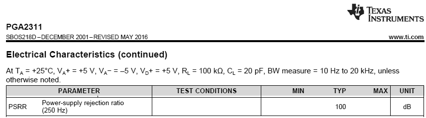

...PGA2310 i cannot see PSRR data in the chip datasheet ...
May be similar to PGA2311, below.
Are you planning to feed it bad power?
