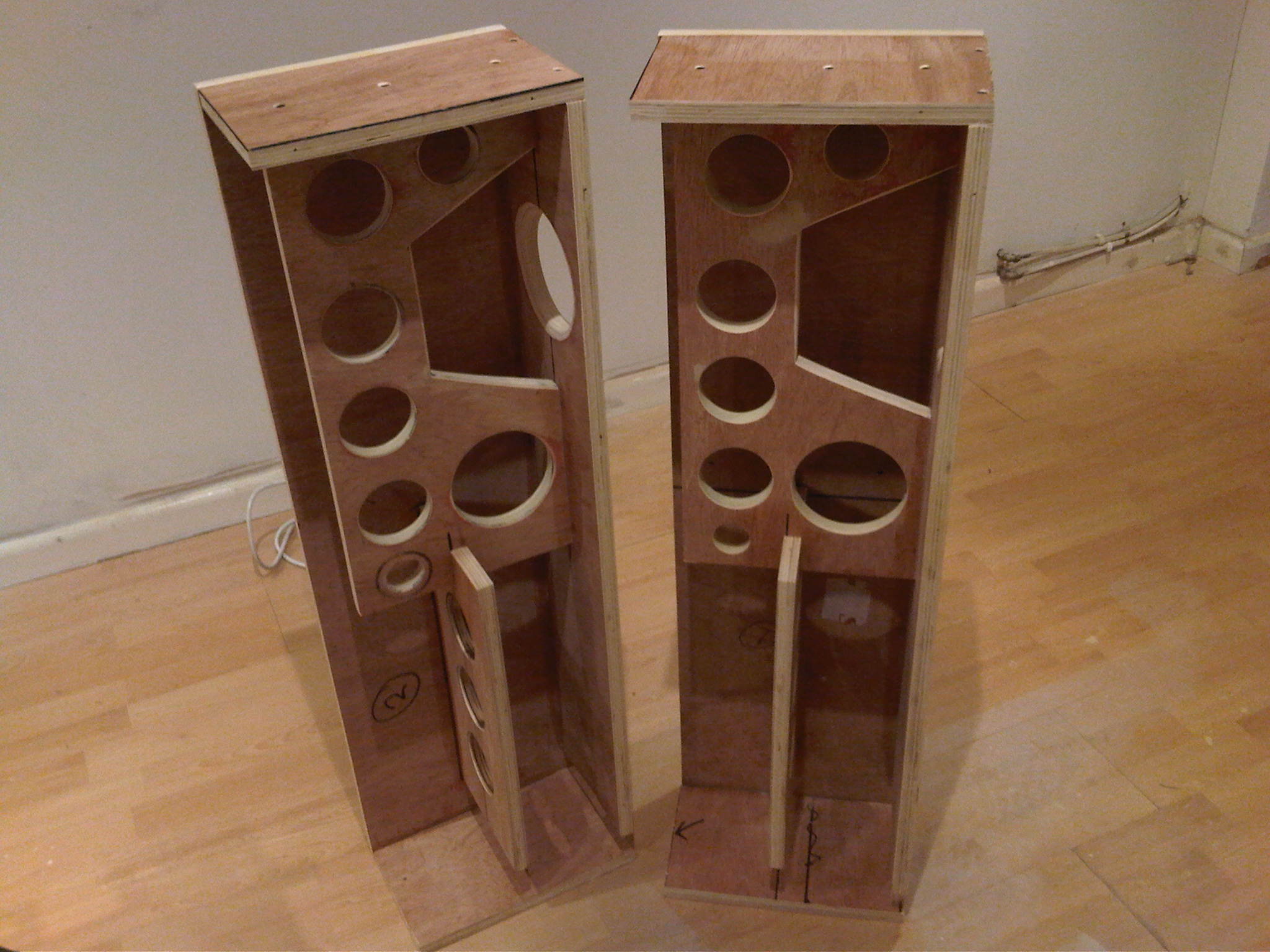

More pics below of my build . . .
Stuffing pic from inside - room 3.5 x 7 mtrs.

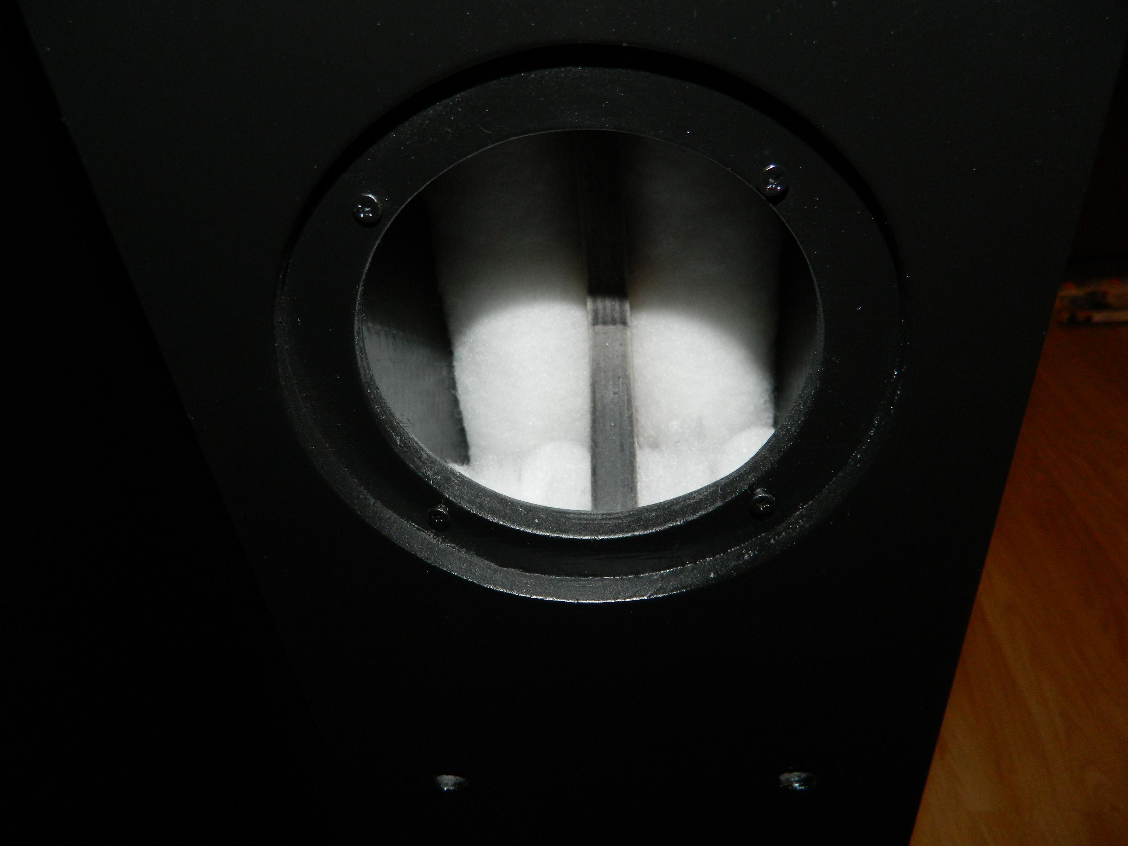

Hi all,
Just ripped out most of the wadding fitted at the back of the cabinets
held in place by the brace.
Night and day difference. Before ( with a very sensitive tinitus - suffering left ear ) the sound was very shrill - vocals were shouty, soudstage was lacking. All that remains are some 12" pieces of dacron fitted to the front and about 2" down from the bottom of the Alpairs.
Absolutely incredible difference, massive improvement.

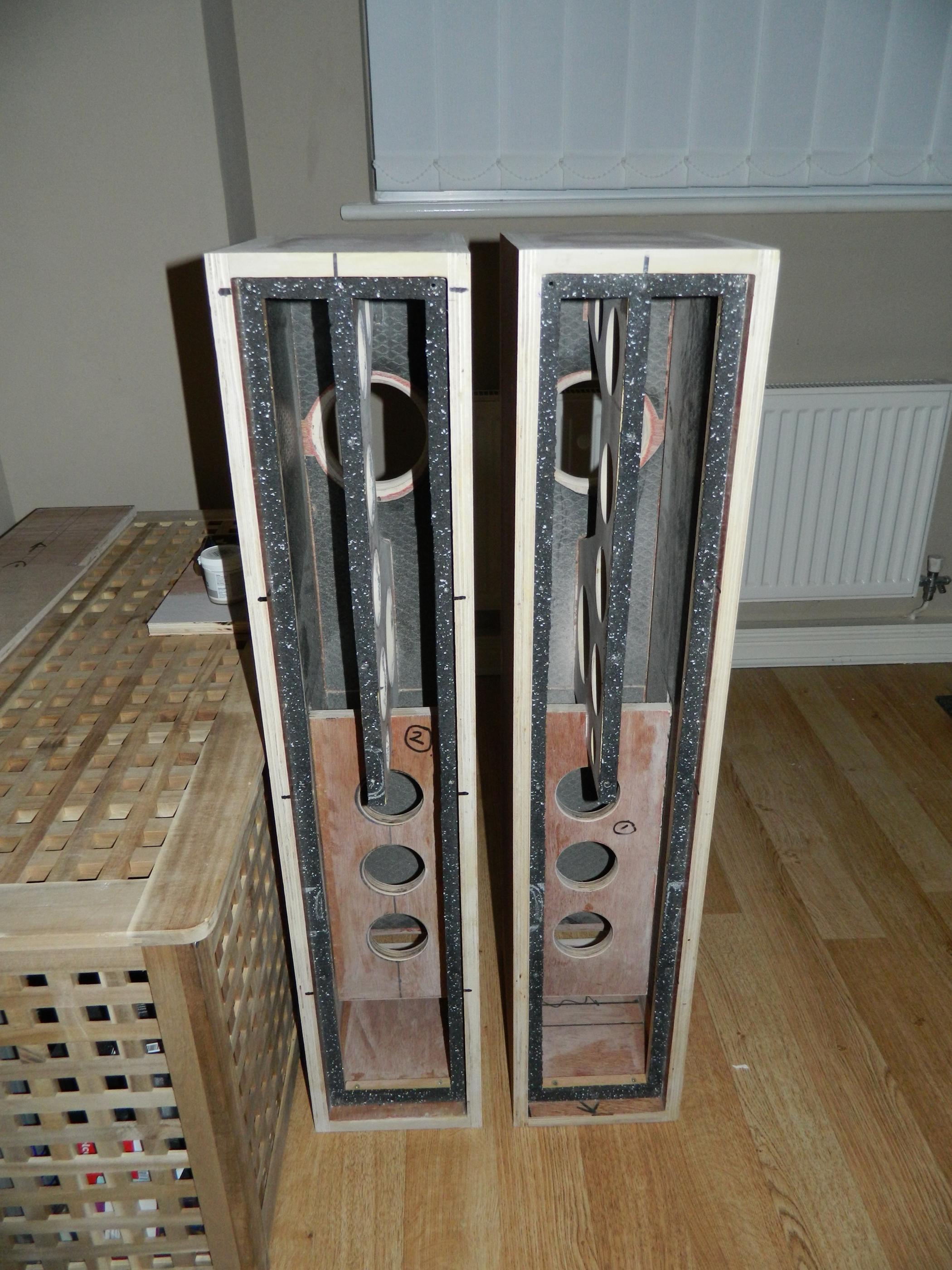

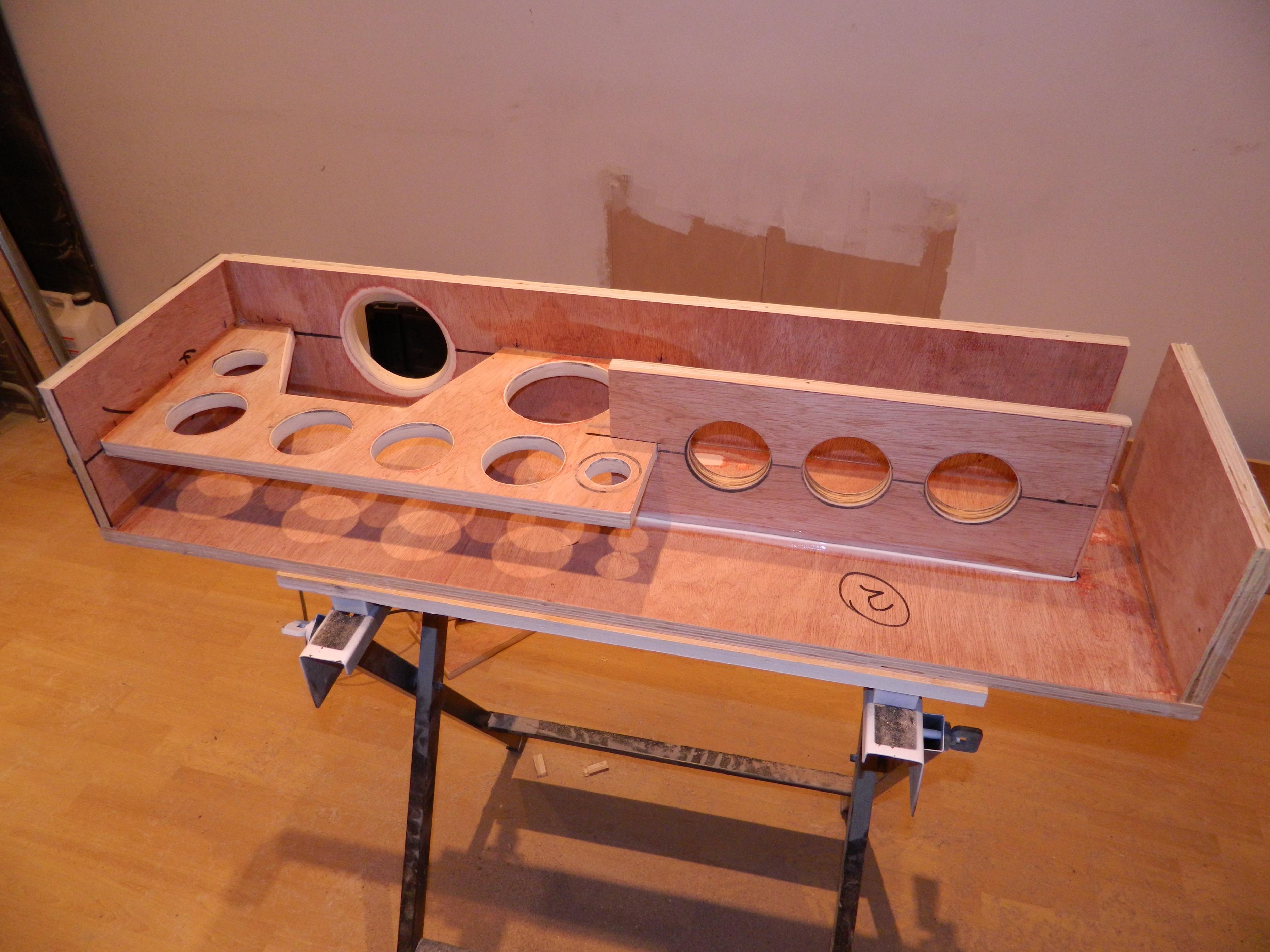

Why's stuffing important if all the internal surfaces are very heavily bitumen damped with the best internal brace I could build ? Pictures below, very best regards, Steve.
Nb..The Alpairs will be 100Hz high passed so any boominess will hopefully be avoided ?
All transmission lines have a fundemental 1/4 w/l resonance and a bunch of higher harmonic resonances. The fundemental improves bass extension, all the rest cause ripple in the LF response. The idea is to keep the 1st one, and eliminated all the rest. Driver offset can be used to mostly eliminate one of those, usually you try for the 1st one, a restricted terminus improves the low pass function of the line, but volume fill damping is a prime tool for reducing this ripple.

Bitumen padding is certainly one way to significantly reduce enclosure panel resonances
(Assumming bitumen padding -- you did also say paint)
Actually it can be a mixed bag. You are adding damping, which will suck up energy that can cause the panel to resonate, but you are also adding mass without stiffness which both lowers the (potential) resonance frequency and lowering the Q, which means there is more energy to excite it, and lower Q resonances are more audiable. Since it is solid you are also reducing enclosure volume, so changing the design parameters.
