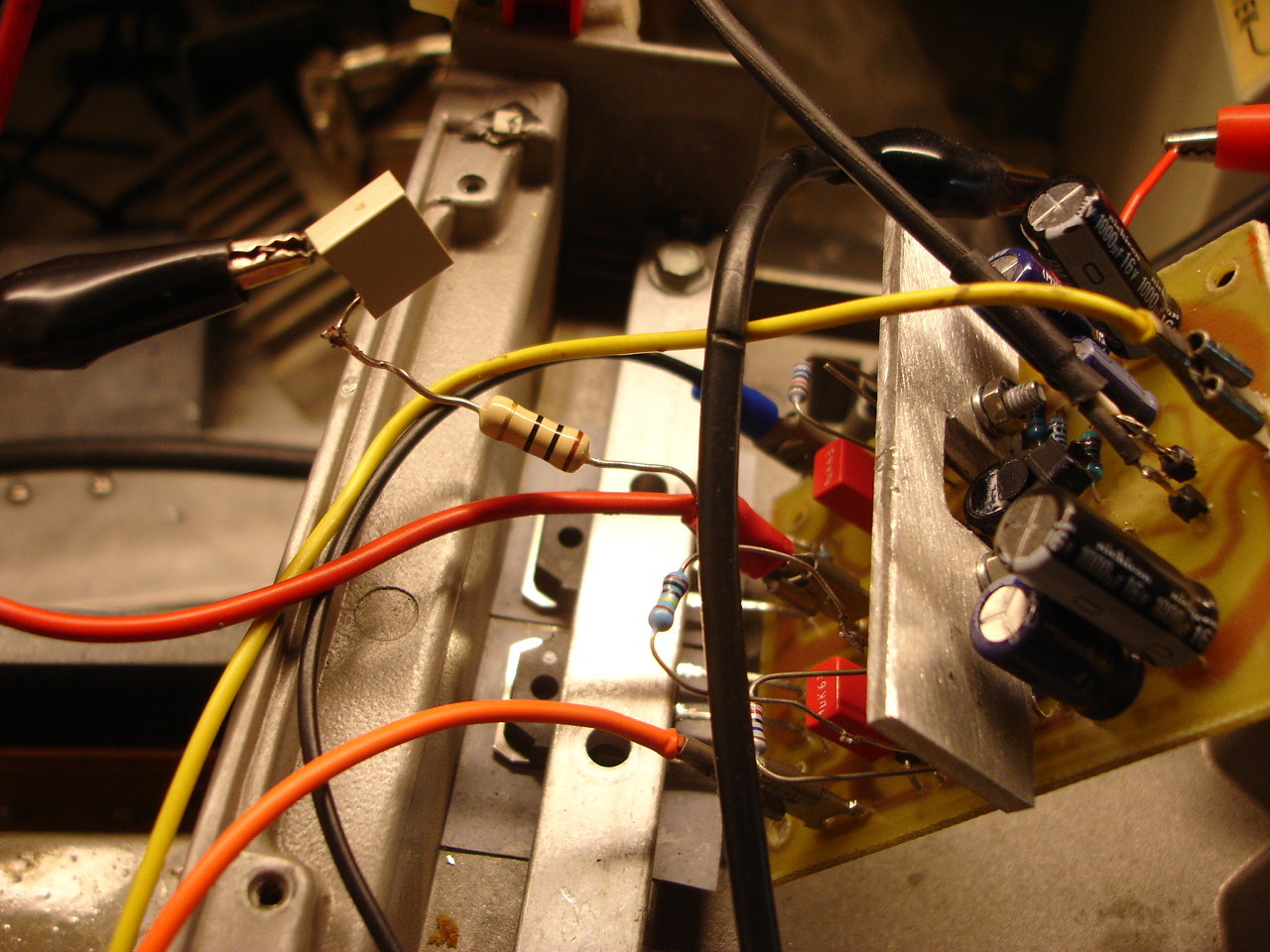

Peeceebee

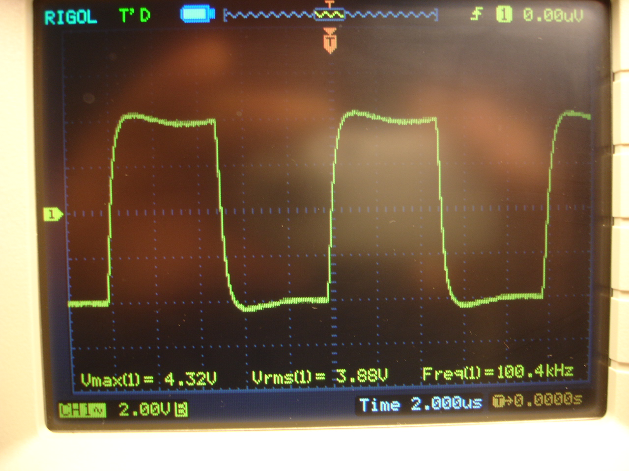

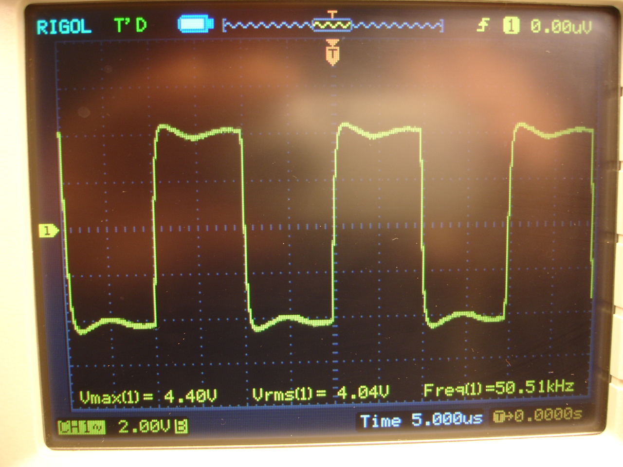

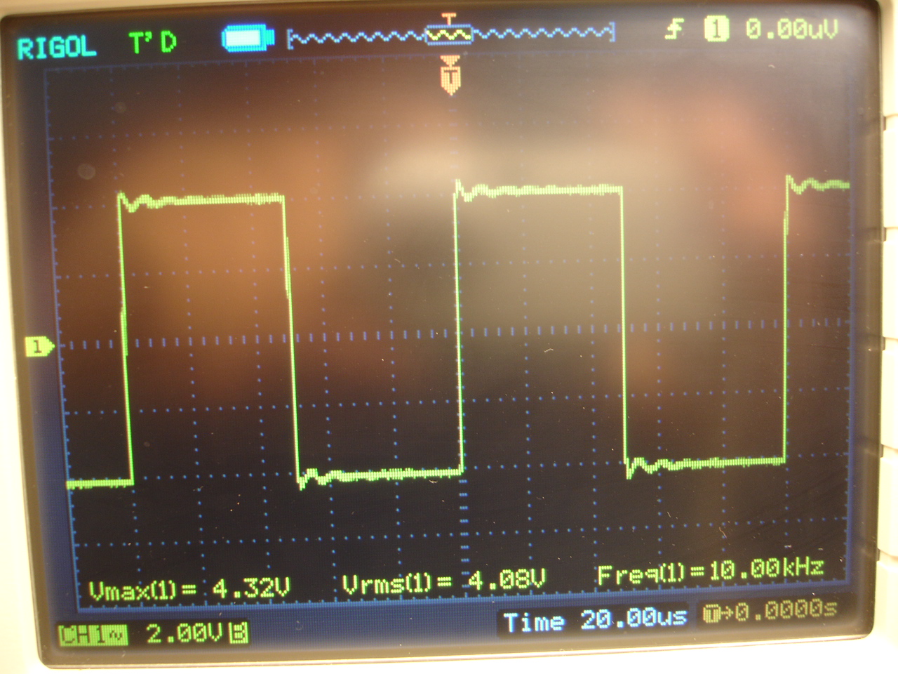

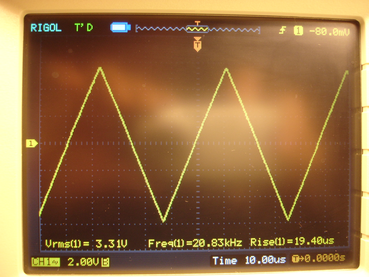

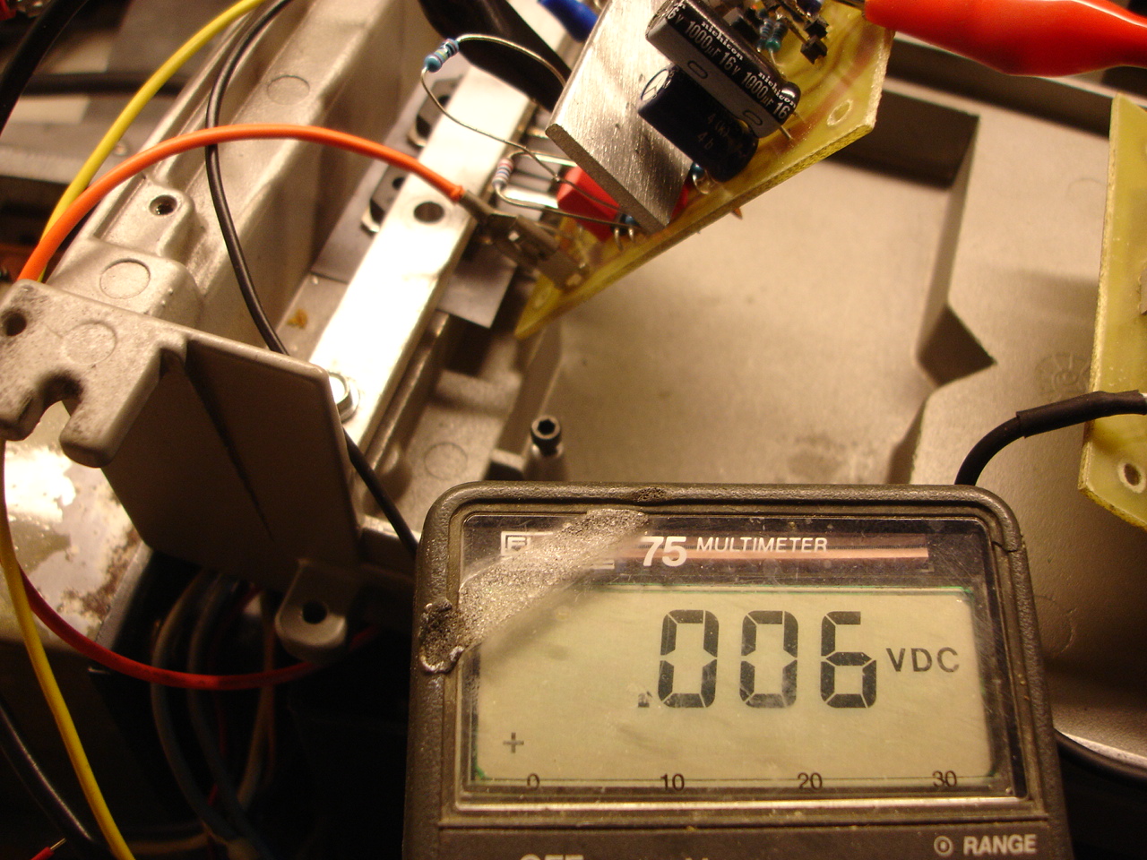

My Peeceebee first test.
+/-35v
Dummy load=6R
VAS current=30mA(0.3V On 10R)
Compensation capacitors=33pf

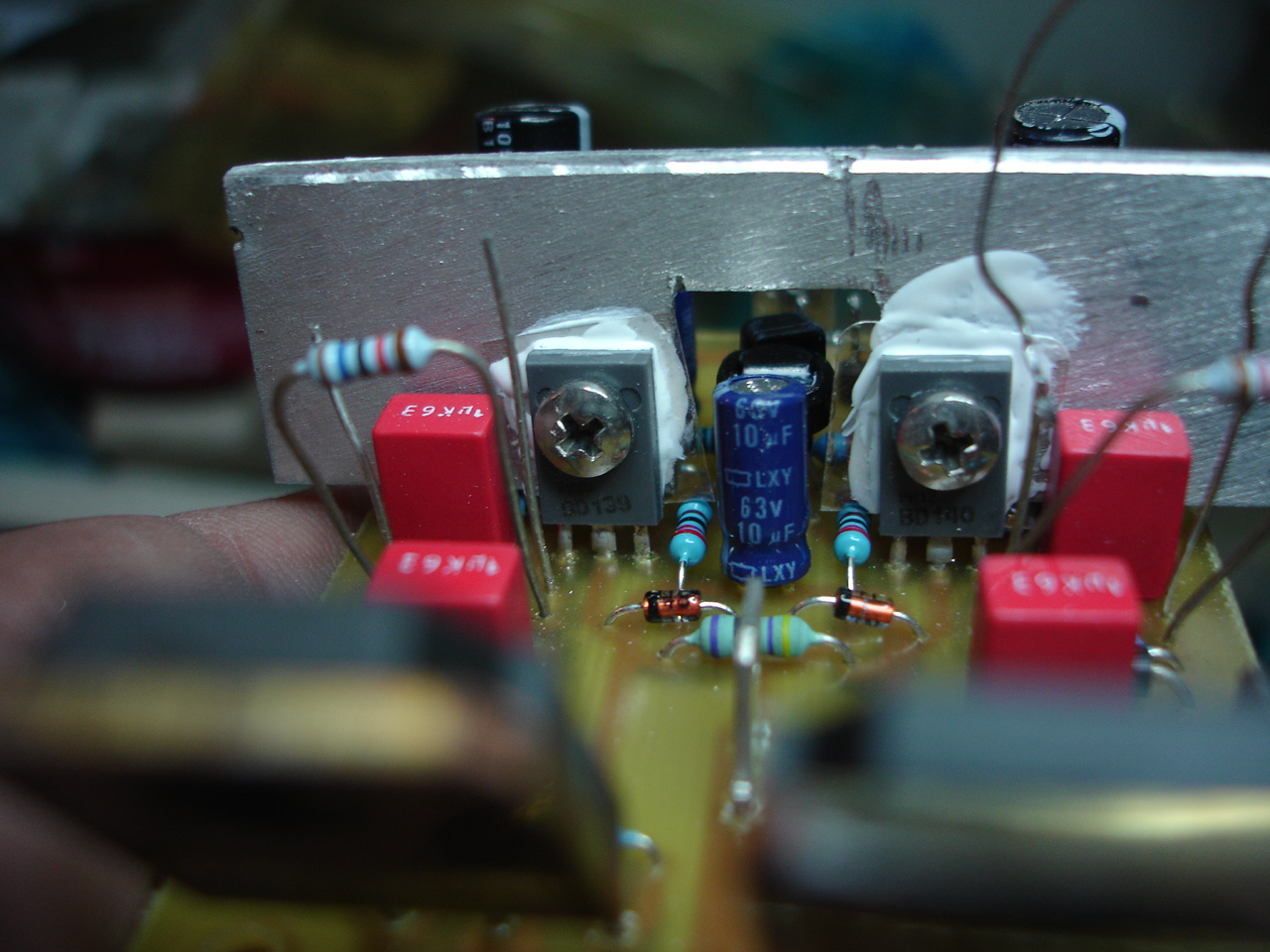

Hi Shaan , BD that i use aren't labeled as -16 but i will try this soon.Hi thimios.
Seems you are using -16 suffix BD pair. Are you?
Just increase the 15k resistors to 22k and you should be near 15mA.
Keep us updated.
I don't see any. Are they underboard?
Yes ,compensation capacitors are populated under board, directly connected at transistors pins.I don't see any. Are they underboard?
Oh sorry,i didn't try this.I will try this tomorrow.Hi thimios.

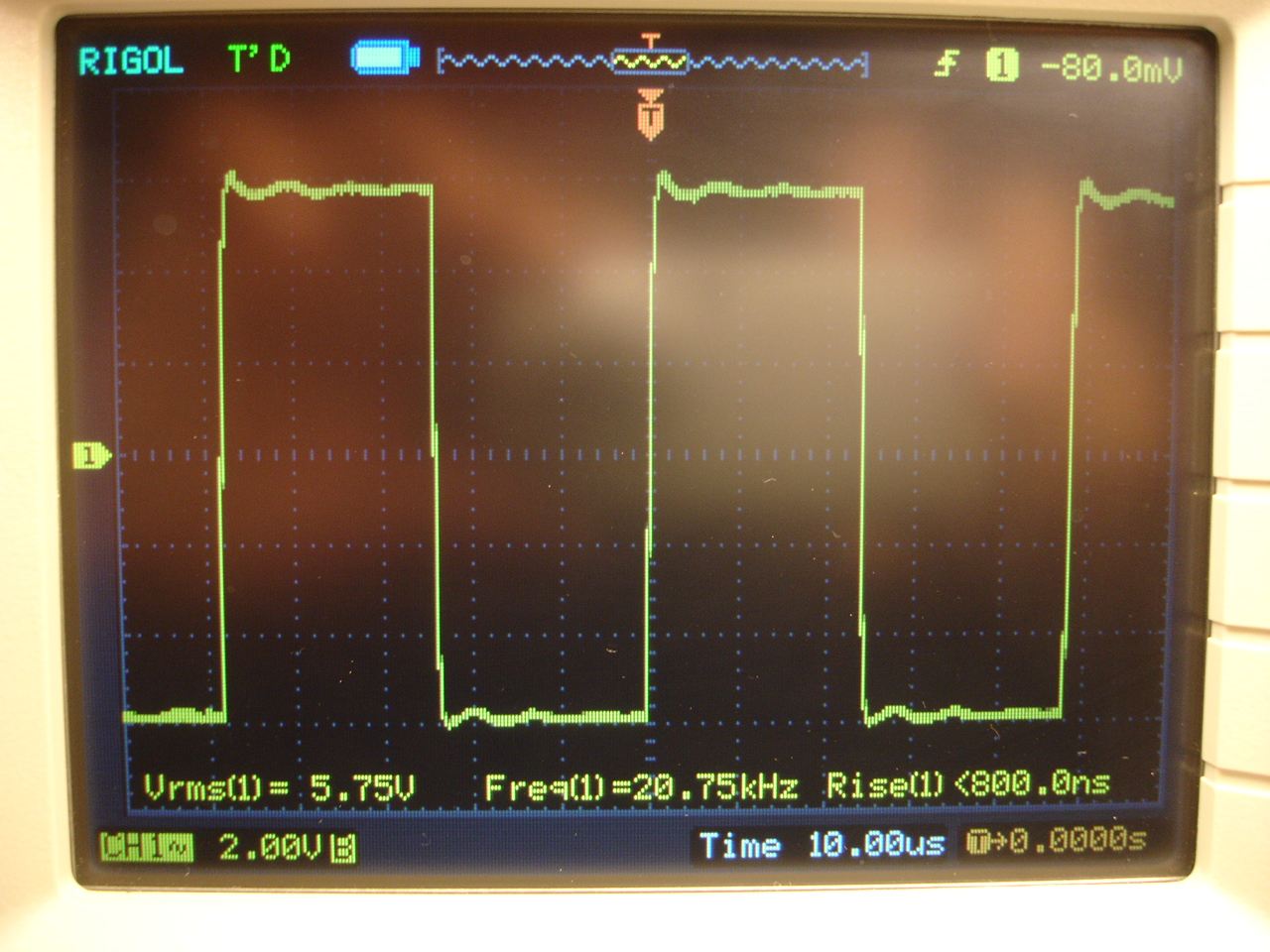

Does the amp oscillate without the comp caps?

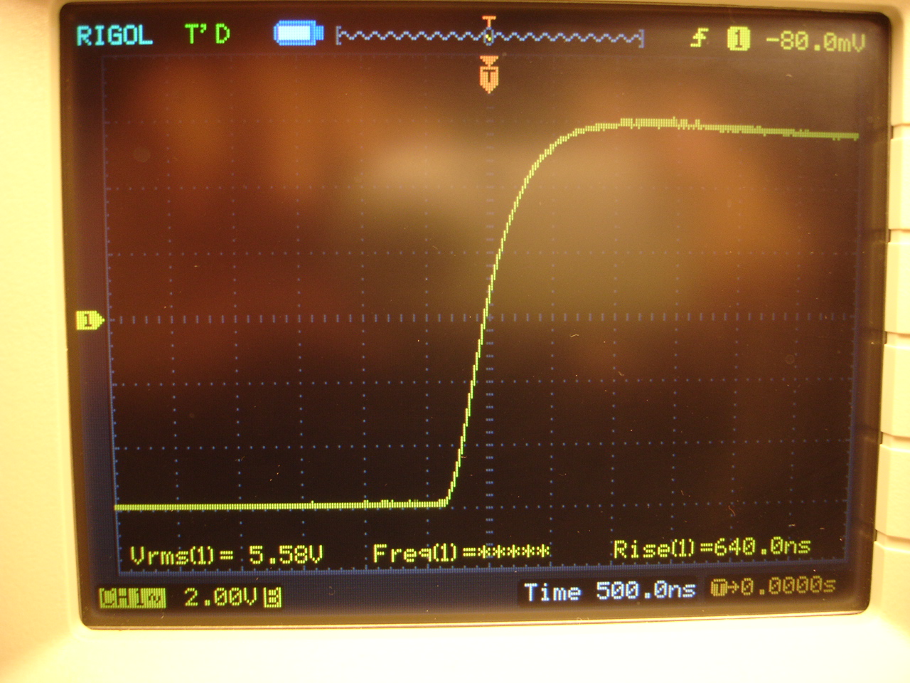

VAS current=14mA(0.142V on 10R) With 16K VAS emitter resistor.(putting here 22K the VAS current is 2mA only!)
Offset =6mv(1M//16K on the positive rail)
Raise time=640ns!
NICE.
Hope you get a wonderful listening expdrience.
Very good offset and VAS current.
Please play some music with PeeCeeBee with the comp caps connected. If you like the sound then keep the caps in the circuit.

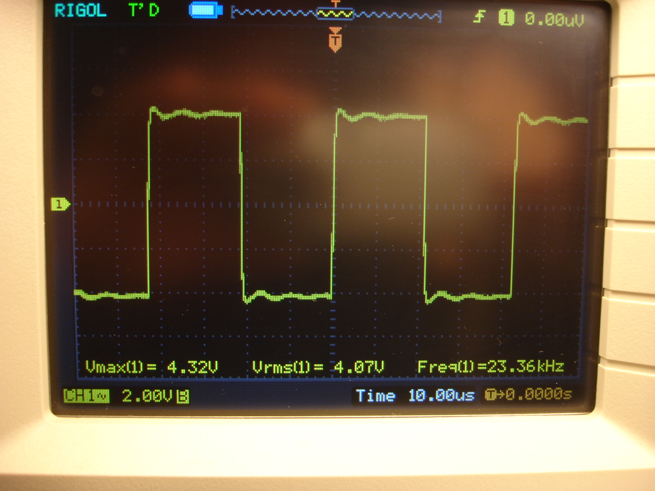

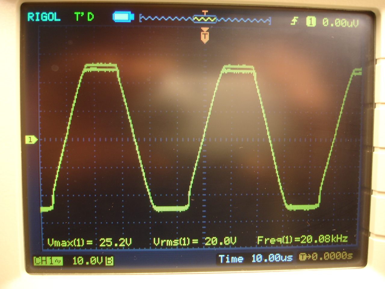

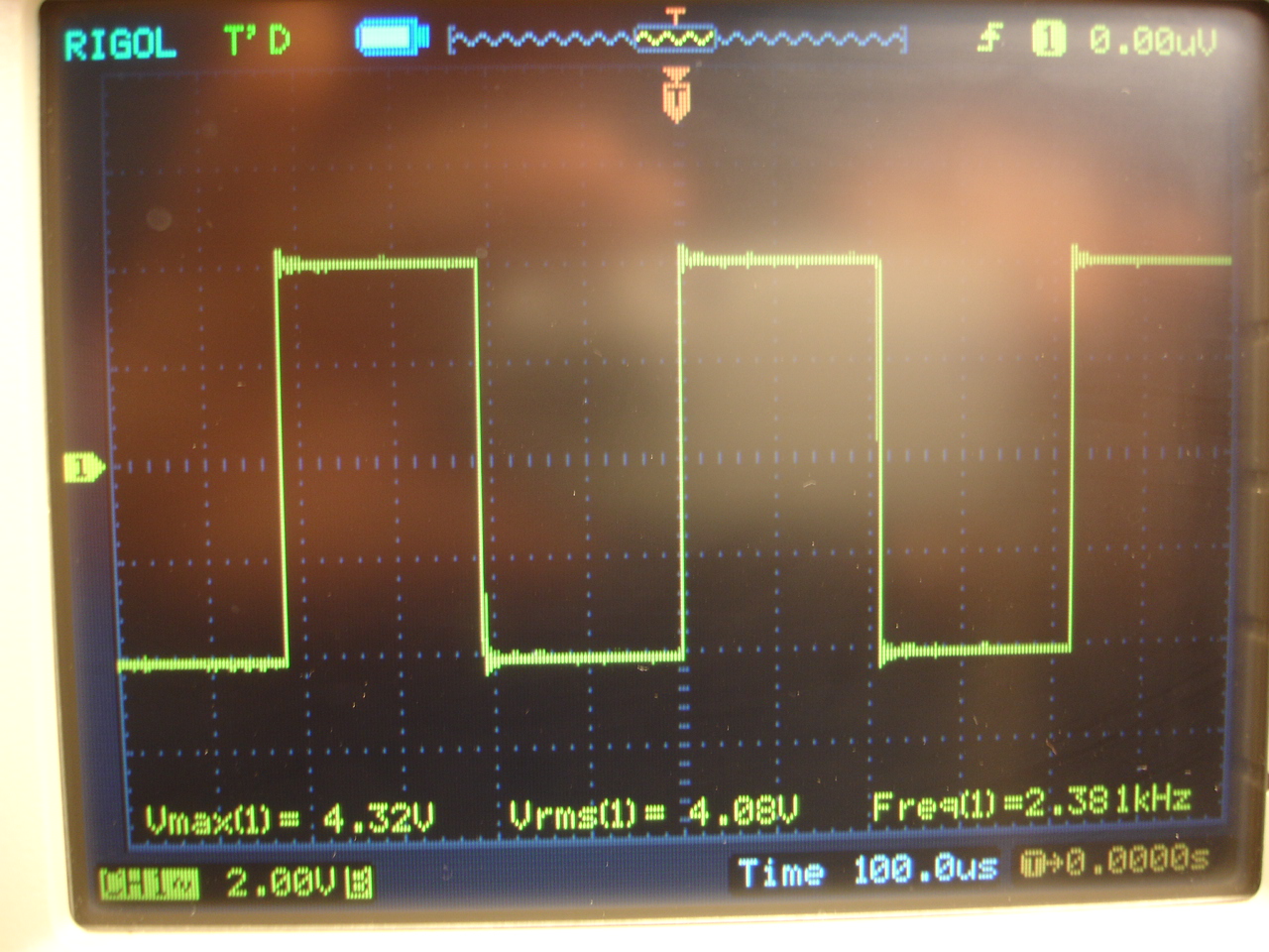

Is any of these Peeceebe working well (no oscillation)without compensation?
I will try without compensation caps ...my curiosity
Can you try test 15kHz square with load 8r with 470nF in paralell, thanks.
Regards
Regards

In which power level?Can you try test 15kHz square with load 8r with 470nF in paralell, thanks.
Regards
May I ask what this test reveals?
Thanks, Terry
Speaker is not resistive load, stability with reactive load is important for sound fidelity.
Regards
Stability in capacitive reactive load.
