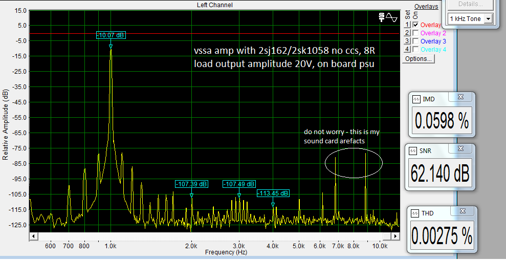

I did small measurement today. Looks very good as only there is 6 transistors in the amp.

Nice. That shows minuscule amount of THD+IMD. Great job.
I'm no expert but I think what the resistor does is preventing a ground loop to form with fully earthed source and amp system. To its disadvantage the AC impedance of the input at RF range is no longer zero, i.e. 10R in series with the input lowpass filter network to ground, causing some RF interference to get its way into the main amplifying stages resulting in audible/inaudible anomalies like noise and distortion. To solve this just place a 100nF cap in parallel with the resistor and all is well.

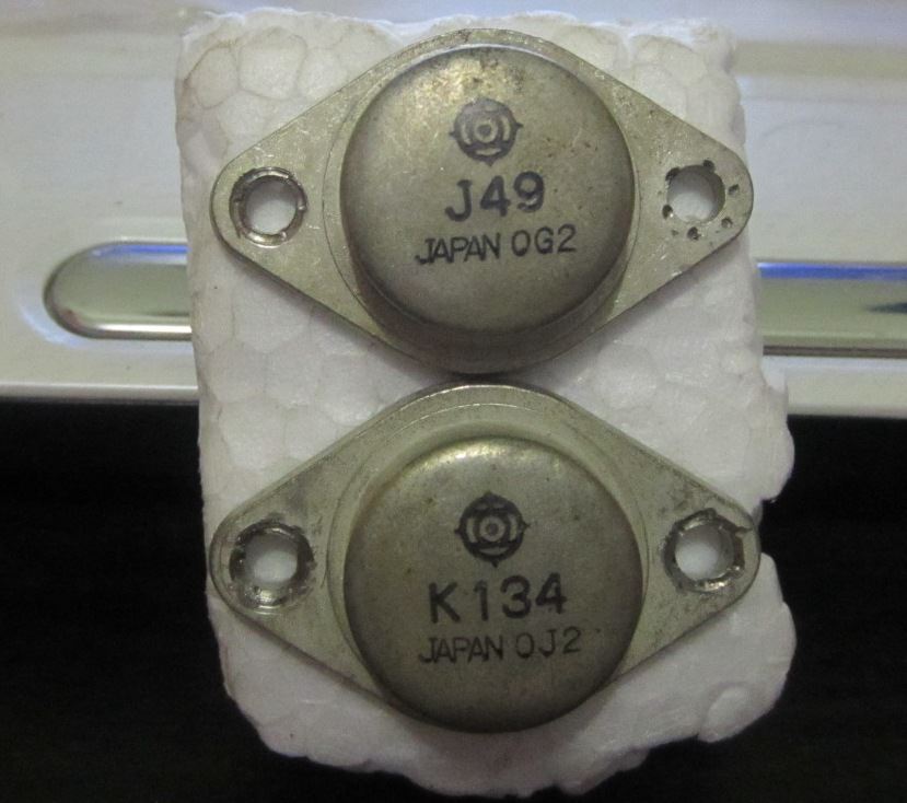

hi kang daman, where you get those fet?
See post #388 (http://www.diyaudio.com/forums/solid-state/231662-peeceebee-39.html)

my friend offered it to mehi kang daman, where you get those fet?
