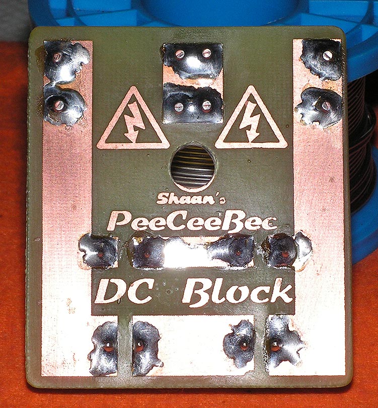

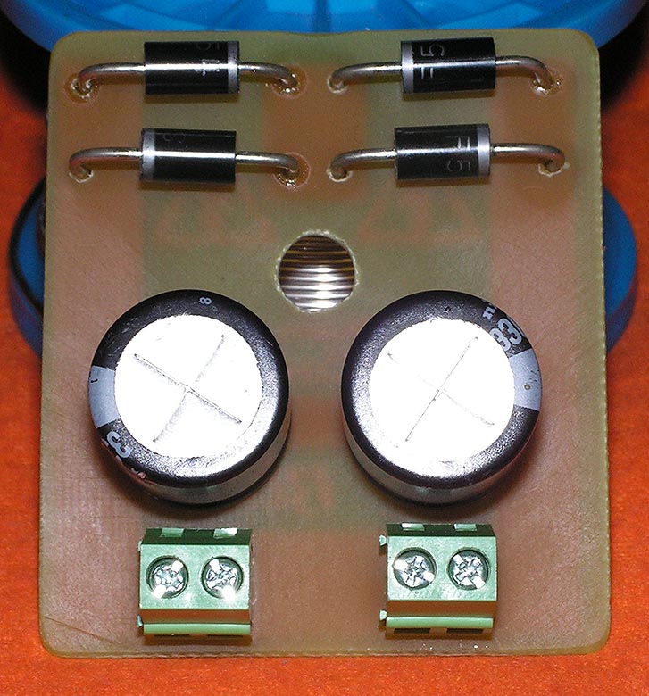

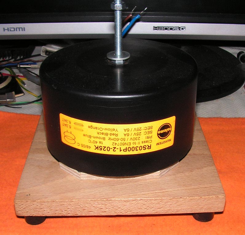

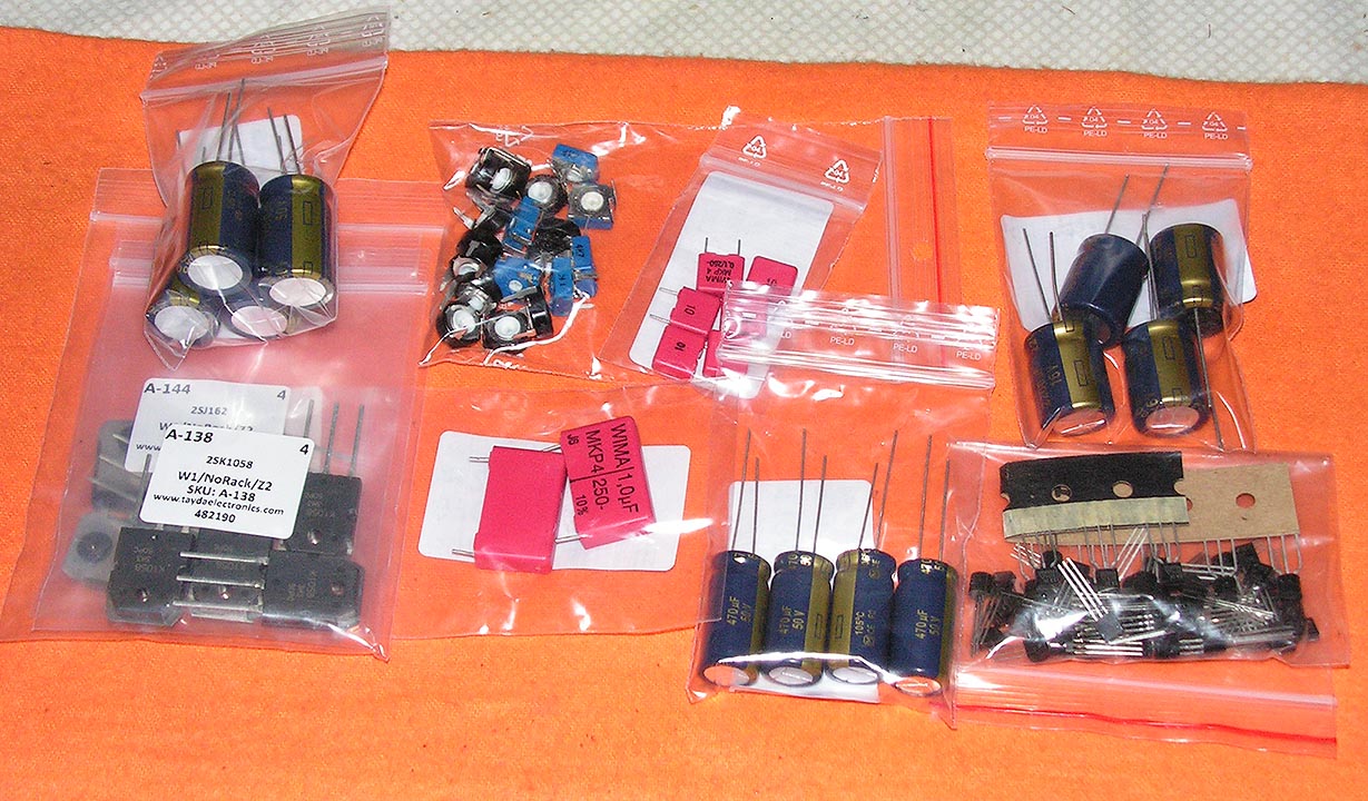

Ok, let's start (slowly but Start).
Some photo of components...
Mosfet from Tayda
Panasonic FC caps
Wima poly caps
Transistors to match
Nuvotem Talema 25+25 6A
DC block for toroidal
Stay tuned!!

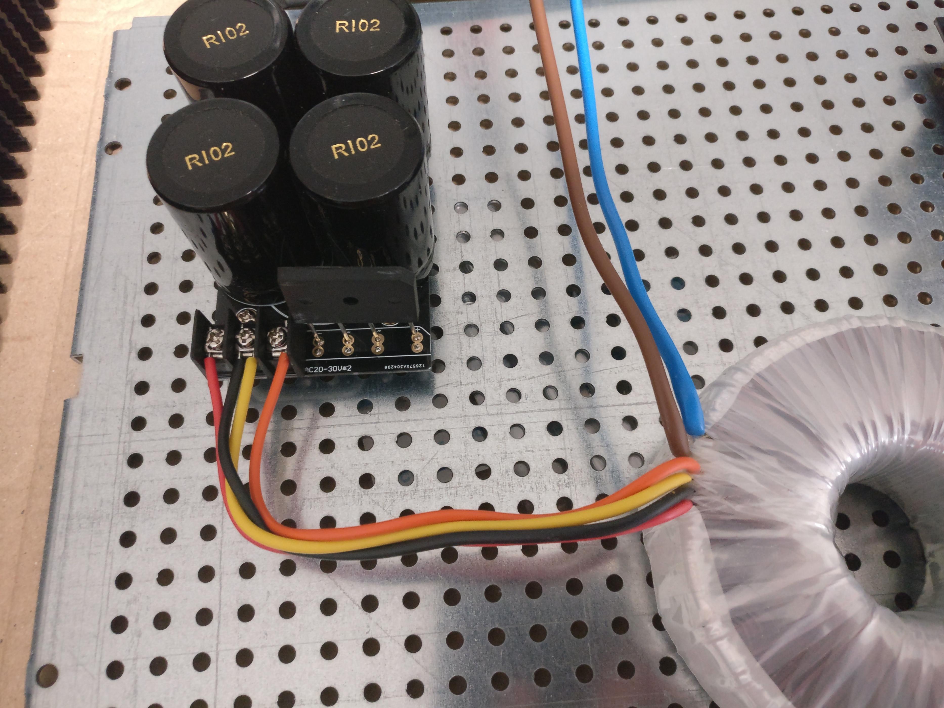

I have a doubt about connecting the transformer with the PSU.
PSU have 3 connectors ac / gnd / ac and my transformers have 2 secondaries. I've connected this way (see attachments)
Is it OK?
Is it OK?
Lift the RED and ORANGE cables.
Connect the transformer to main voltage.
Using an AC voltmeter measure between black/yellow and red,you must see 25v.
Measure again between black/yellow and orange,you mast see 25v.
If so you have correct connections.
In any case your transformer isn't suitable because of low current(low VA range).:(

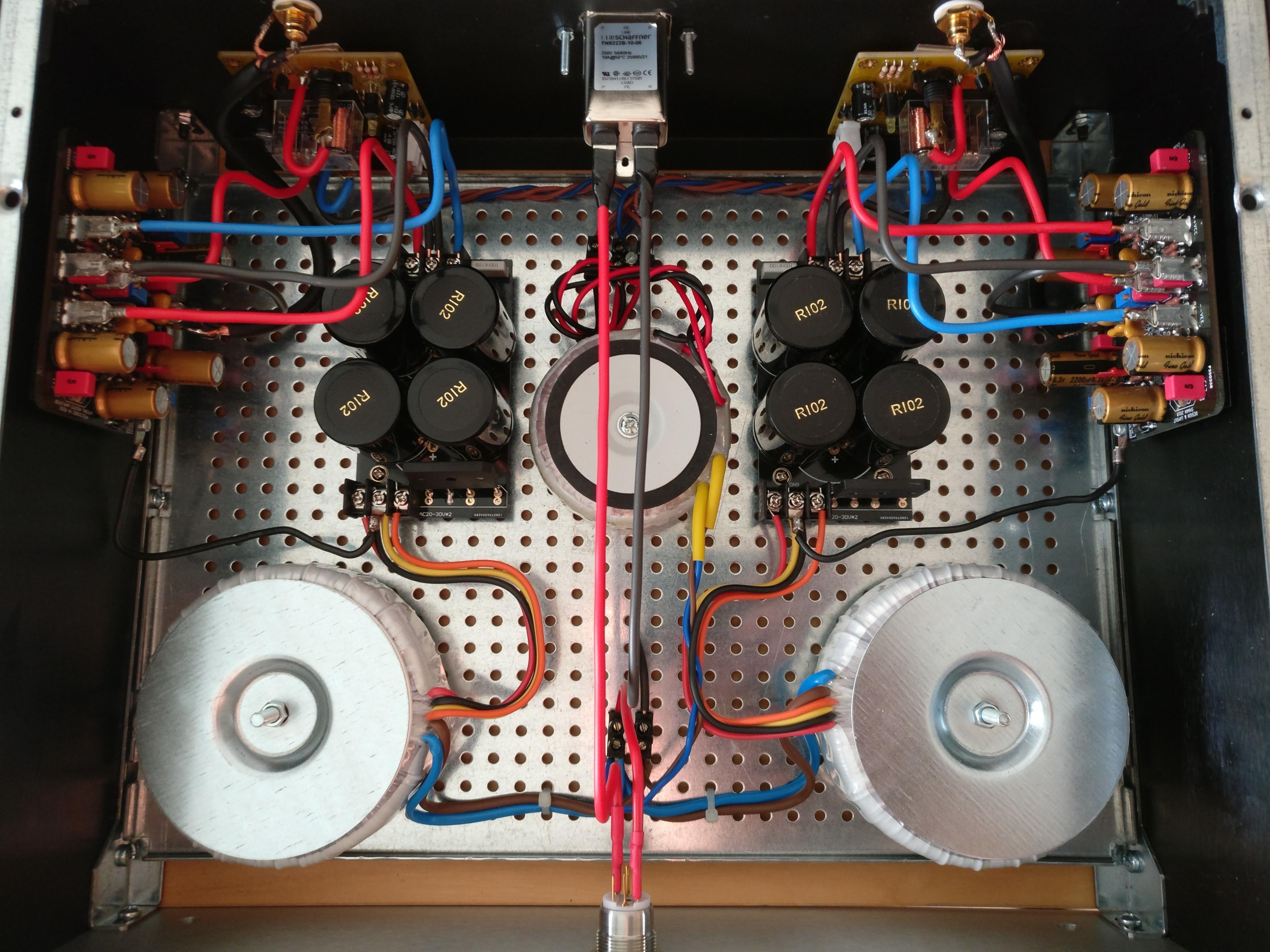

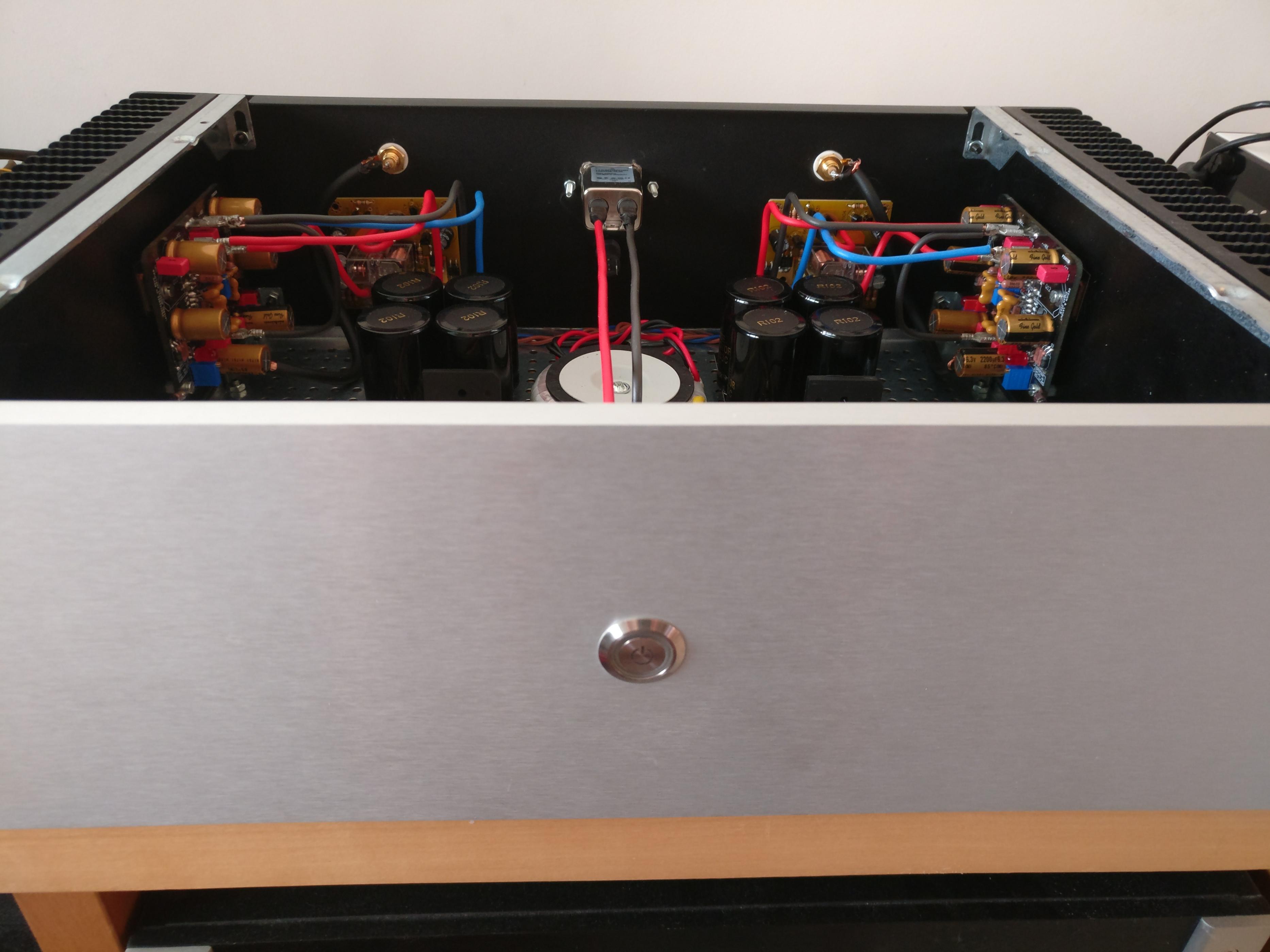

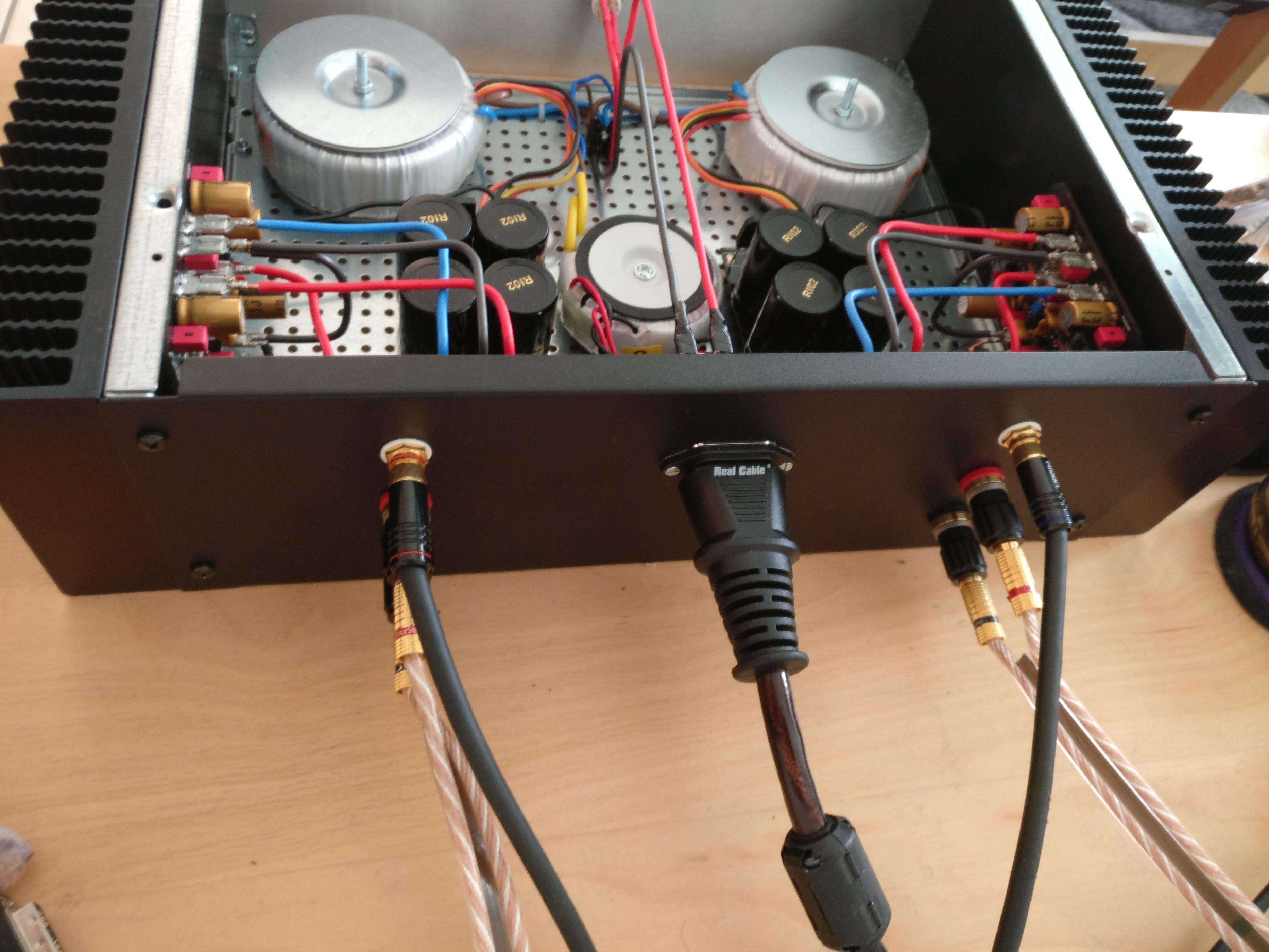

Here's my final build :)
Just need to add a fuse and to connect the switch to the 12V to enlight it.
I tested it a few hours this week end, and i like it a lot. I'm not very good at describing the sound and english is not my first language, but i'll try.
My system is composed of a PC with Qobuz, an Atoll Dac100SE directly wired to the power amp, I don't have a preamp for the moment, and a pair of DIY speakers, the Prima from Justdiyit (Scanspeak discovery serie).
My previous amp was a 5 channels Emotiva UPA-5, that was already a lot better than my Denon X4000. But now I can hear that the Emotiva was not that good, the bass were not tight and not very defined. With the V4 everything feels very clear and transparent.
I can feel the the V4 is less powerfull than the Emotiva, which is supposed to be 5x125w/8ohm, but it's enough to drive the Prima and make my neighbours come to yell at me :)
And more importantly, the sound is still very clear at higher volume level !
Anyway, I'll will try to make the V4H later !! =D
I think that now, I've other thing to work on to improve my system (preamp, dac) :)
Fabio
