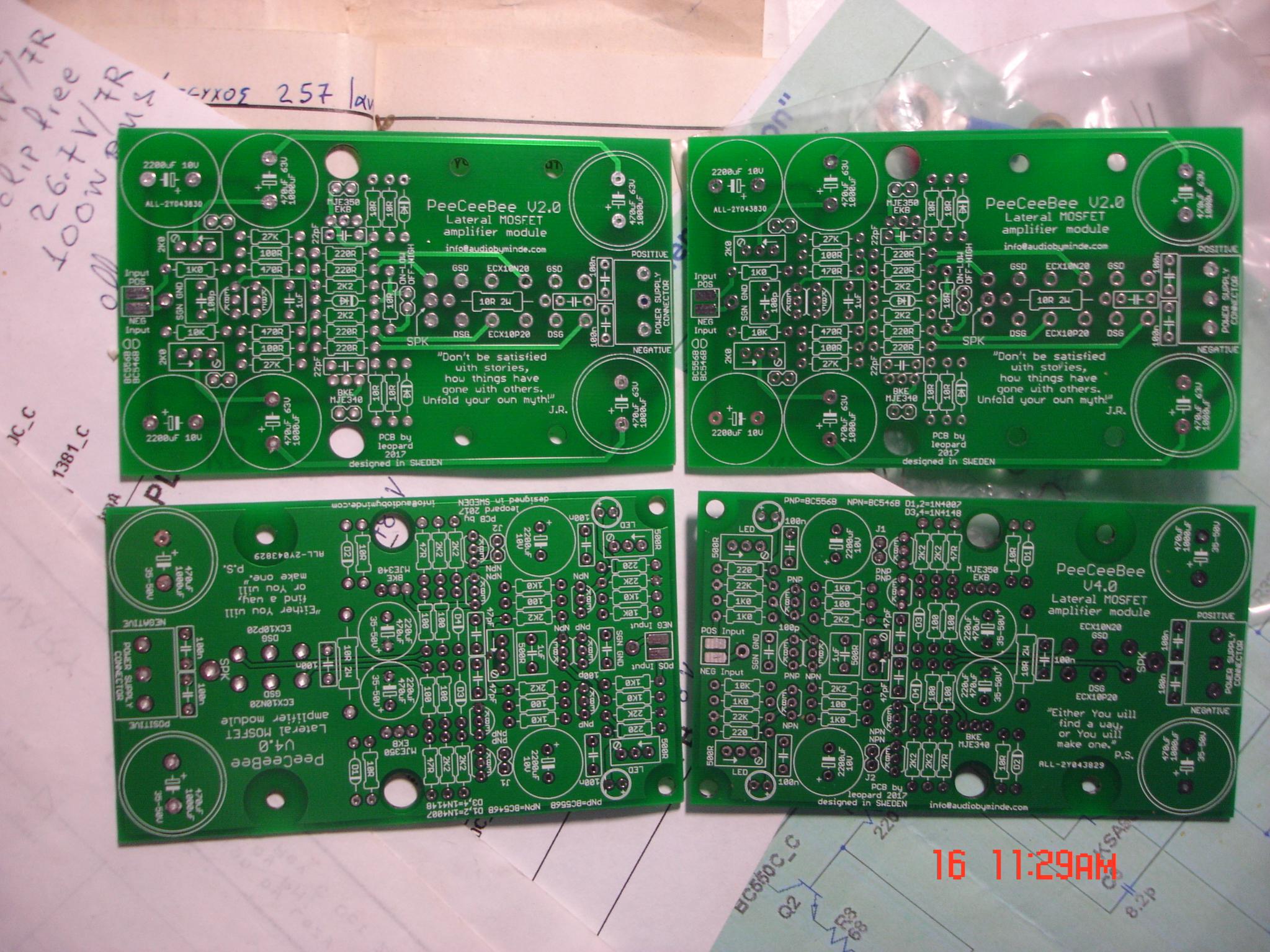

Hi Shaan,
Peeceebee boards received today.
Much appreciated..
Thanks,
Boyet
Some time ago a diyaudio member(mindutis) donate me with theese boards.
He want to see these boards tested.
Now i must ask Shaan if this test can be posted here or a separate thread is necessary.
First thing that struck me, gate stoppers are so far away...shaan puts them very close I believe.
Otherwise looks very symmetrical.
Hi Thimios.
Posting test results in this thread is most welcome after the full PDFs are uploaded for these boards.
Thanks.

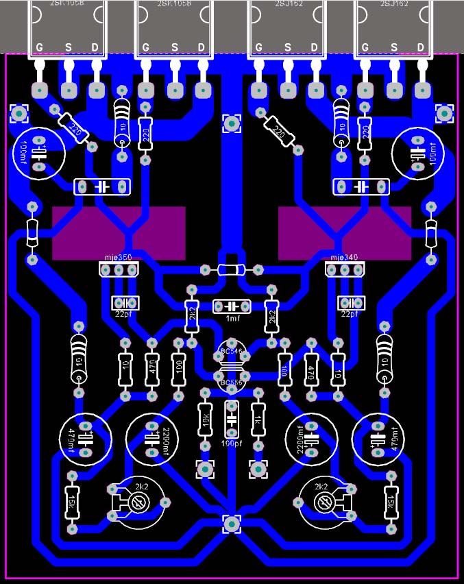

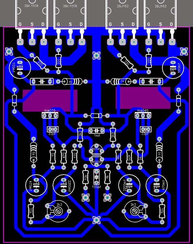

Well....what do you think about this horryble design?
I have made a mix of V1.1 and V2 and my own.
(I hope you are not angry for this mix.....)
I haven't inserted 10ohm and 100n in speaker output, they will be
inseted dierctly in bindig posts.
Hi Franz.
It's cool because this is what this thread is for - to make and share new PeeCeeBee layouts. So keep it up.
Try to put 100uF electrolytic caps as close as possible to the MOSFETs and also onboard zobel network may be unavoidable with this layout. Will wait for your tests on it.

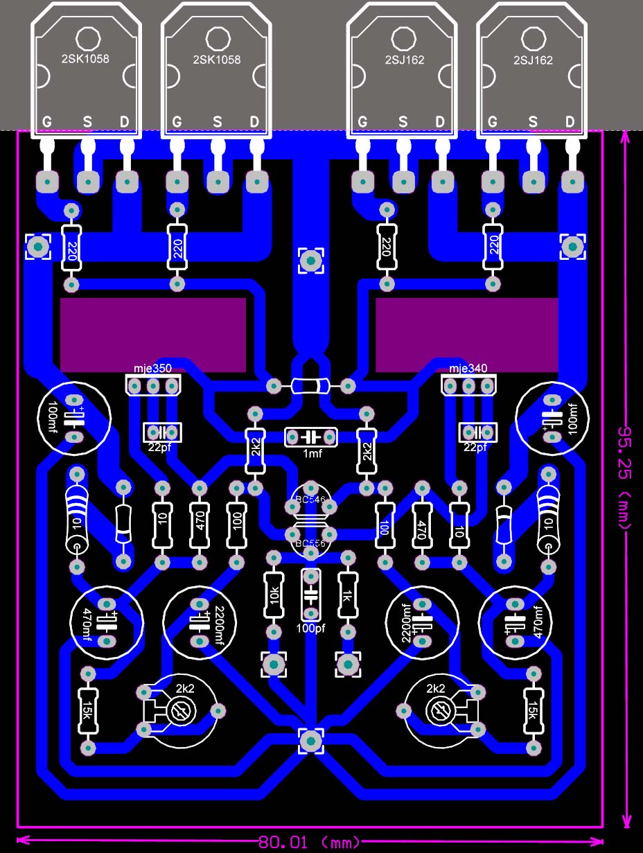

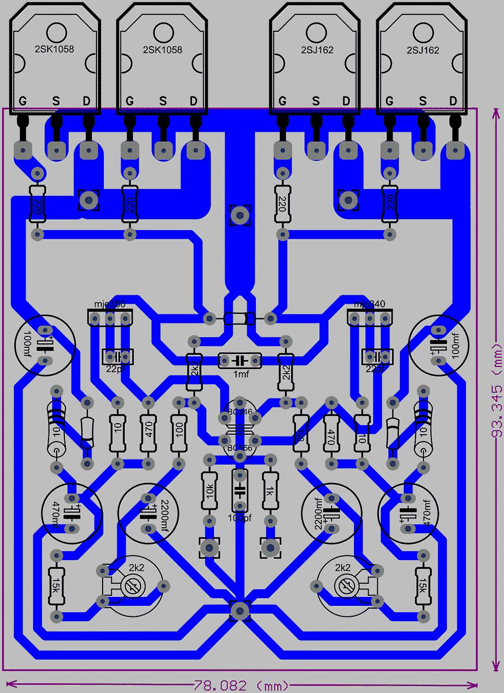

Hi Shaan,
this is my limit....design a decent layout. I don't know where to move caps.
I will make a try...
MOSFETs are bloody fast and must have local rail decoupling capacitors from closest to drain leg to ground, or oscillation is almost certain.
Zobel will be in bindig posts...is wrong?
Might cause some discomfort to the MOSFETs, and might not. The inductance of the shared output trace can potentially cause parasitic oscillation in the MOSFETs at 10-40MHz frequencies and ruin your day. Better to have space for Zobel networks closest to the MOSFETs' source legs, then test if using them makes any difference. If not, omit them. The very first PeeCeeBee ran stably without Miller caps or Zobel. But it can't be expected nor guaranteed to be the same in every case.
As it will be a high power amp it's best to make sure it doesn't oscillate in standard operating conditions. All the bests.
Turn on the am/fm radio, tune it to a station and keep it close to the amp when it's on. If it's oscillating, the channels will be dead or extremely noisy.
Also monitor output offset, if it's too high like 5-10volts and cannot be trimmed to zero then most probably it's oscillating.
And there's a chance of high heat dissipation during oscillation so keep an eye on the heatsink temperature.
