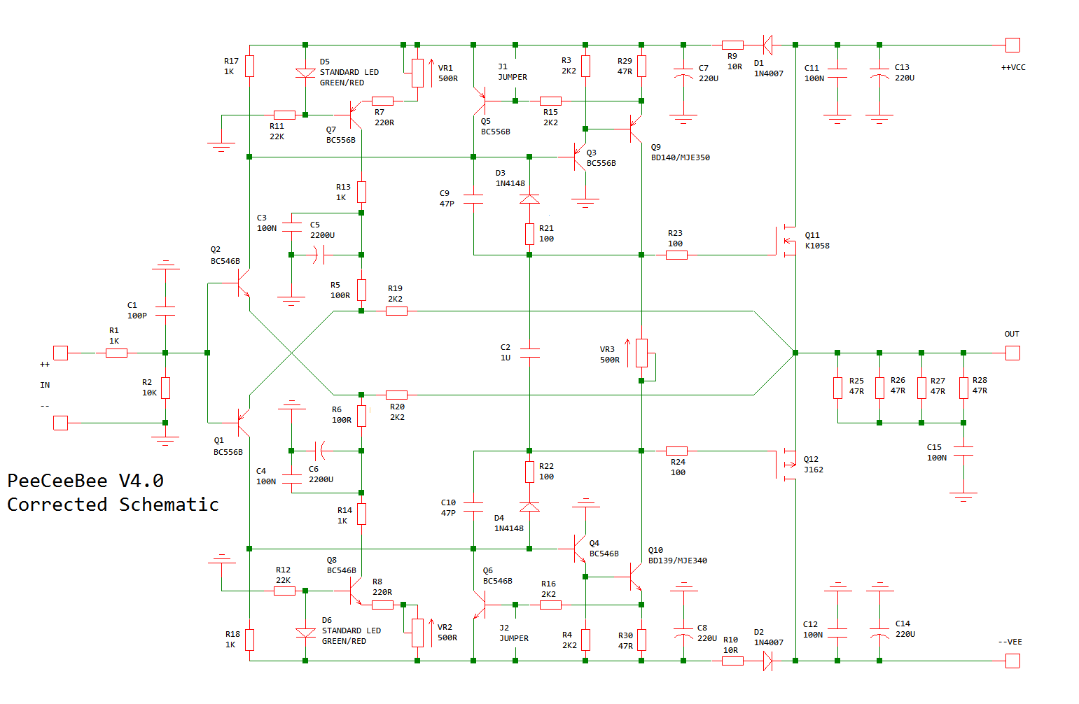

As reported by mexakin in the original PeeCeeBee thread, there have been a mistake in the schematic. The indicators Q1 and Q2 have been swapped and have been shown for the wrong transistors. My apologies for this overlook in the schematic.
Correct indication: Q1 = BC556B, Q2 = BC546B. Corrected schematic attached below and will be linked in the first post.
The component indication in the Setup Guide linked in the first post has no errors. It is yet again suggested to everyone to follow the guide for assembling and setting up the boards.

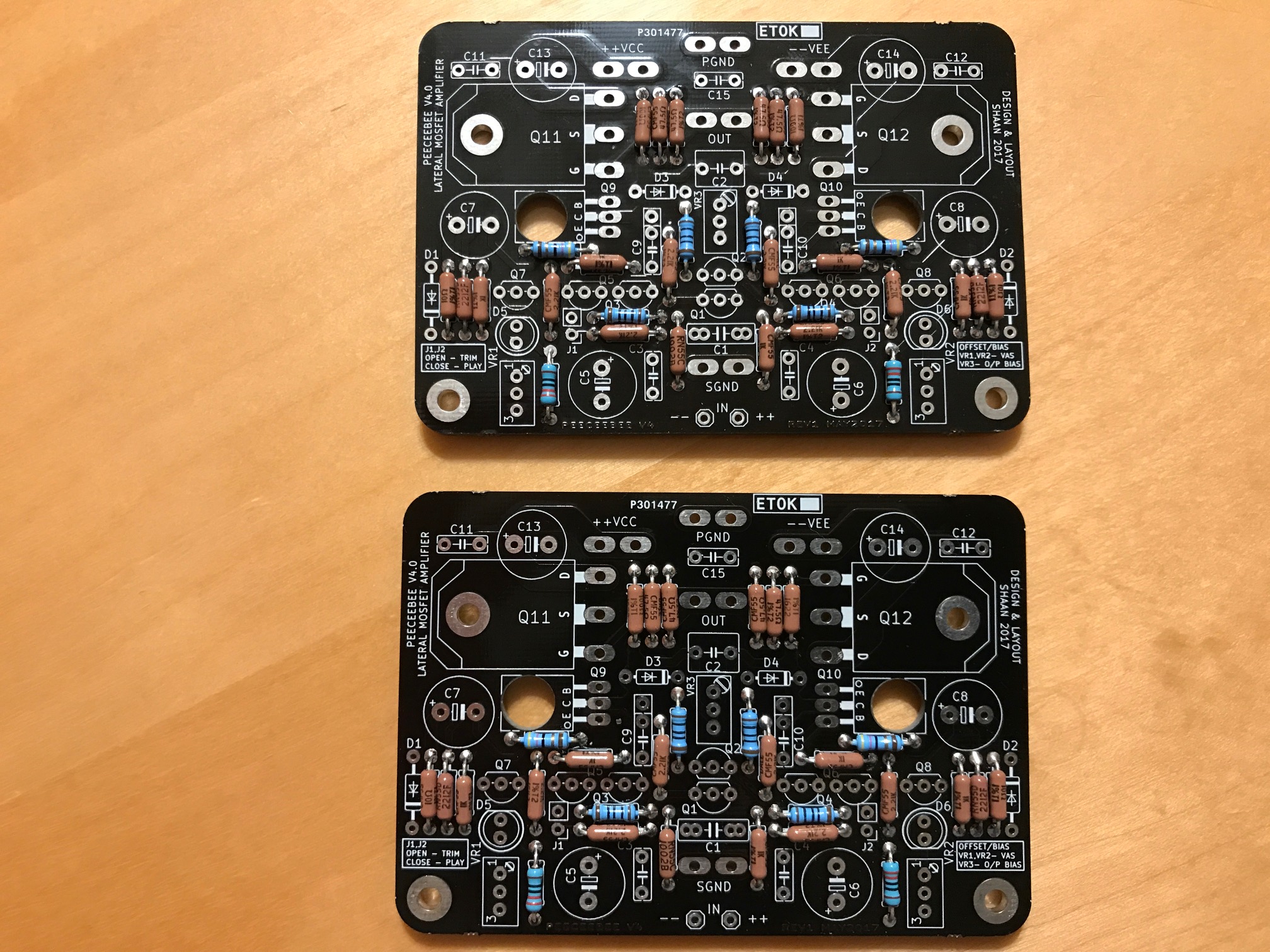

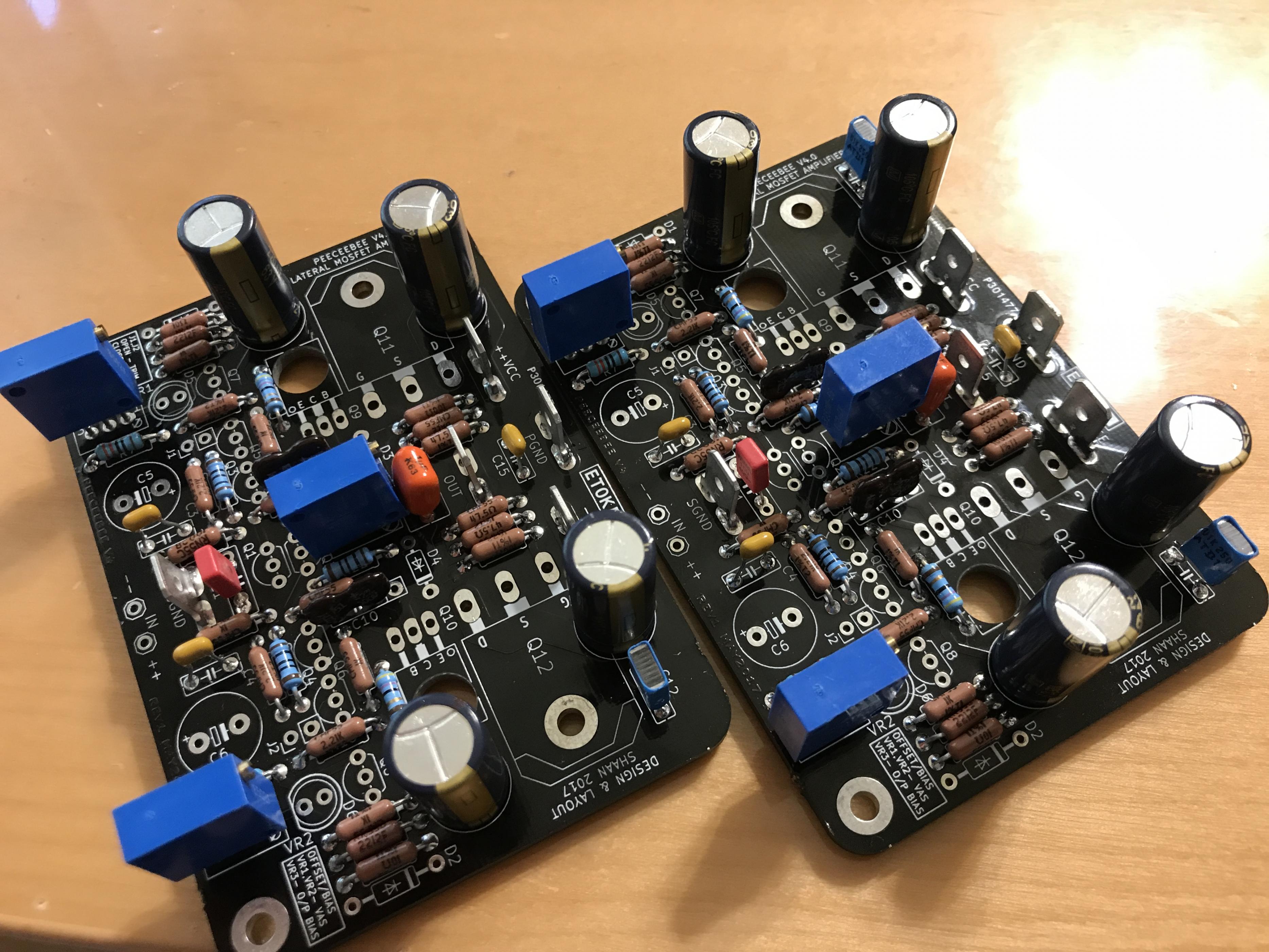

some questions
I am not sure if I should ask these questions here ,
I started populating my boards....
Those ceramic capacitors really have to be on 500v?
Are the values critical? Instead of 47pf can I use 51pf?
I already have 1k trimpots , can I use those( not to buy 500ohms) ?

You can use 100V ceramics. These capacitors are always loaded by both AC and DC so a higher voltage capacitor will be sturdier in this respect.
51pF is absolutely fine.
You can use 1K trimpot. Before soldering just turn them to measure 500-600 ohms between legs 1 and 2.
Lastly, yes you can post all your questions here. :)
