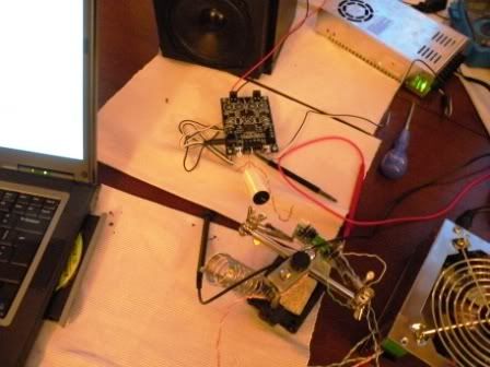

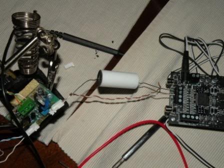

Still missing some improtant parts, but managed to get one buffer tested.
Bit early to pass commnent on the sound quality of the buffer, but it is running well with a Sure T amp.
I could swear it improves the sound, but through one mission 760i speaker and an unmodded Sure amp, I think that I would be jumping the gun
