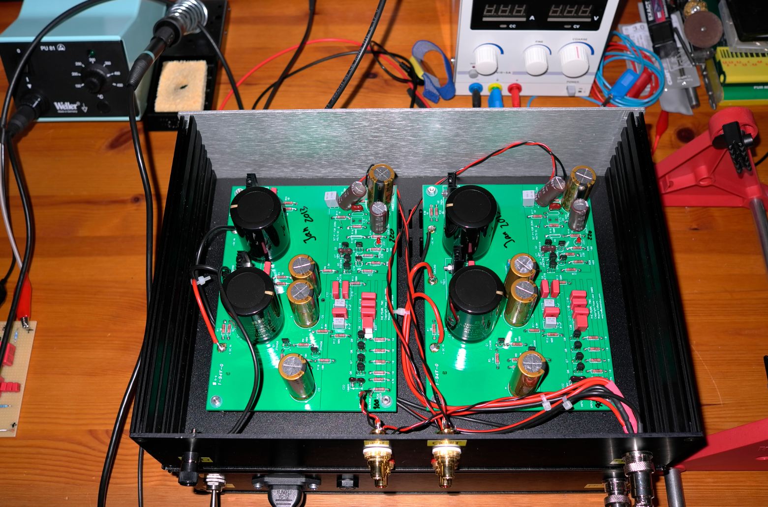

Hi everyone,
finally I got my Pass Pearl 2 working! A good friend of mine who is really an electronic expert did the measurement with the scope and soon found out about it. The problem with the faint signal on both output channels was simply due to the fact that none of the gain stages was working properly. Reason for that was that I apparently blew all ZTX450 bipolar transistors, so the JFETs did not have any power. I must have burned them when I had them soldered -I didn't know that they were so sensitive.
After replacing them with new ones and carefully re-soldering them I got the gain stages to work. Interestingly none of the JFETs was damaged (I was lucky, since these were the matched ones that I got from Pass Labs). Anyway, after replacing the ZTX450, one could notice a slight imbalance in output voltages, so I replaced the MOS-FET ZVP3310 and after re-calibrating voltages with P1 the output on both channels was fine and more or less equal.
I am happy and am looking forward to listening to some good old vinyl now!

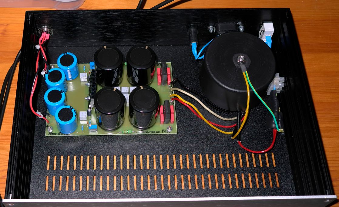

Attached are two screenshots, one from the amp itself and one from the psu. I am using LM317/LM337 voltage regulators in the psu and 28 V per rail.
Thanks for help in this great forum!

Poli - That looks fantastic!! Bravo and congratulations!

That is looking great! The 22 muF caps are quite big, what type are they? Also quite some capacitor real estate in the PSU...
