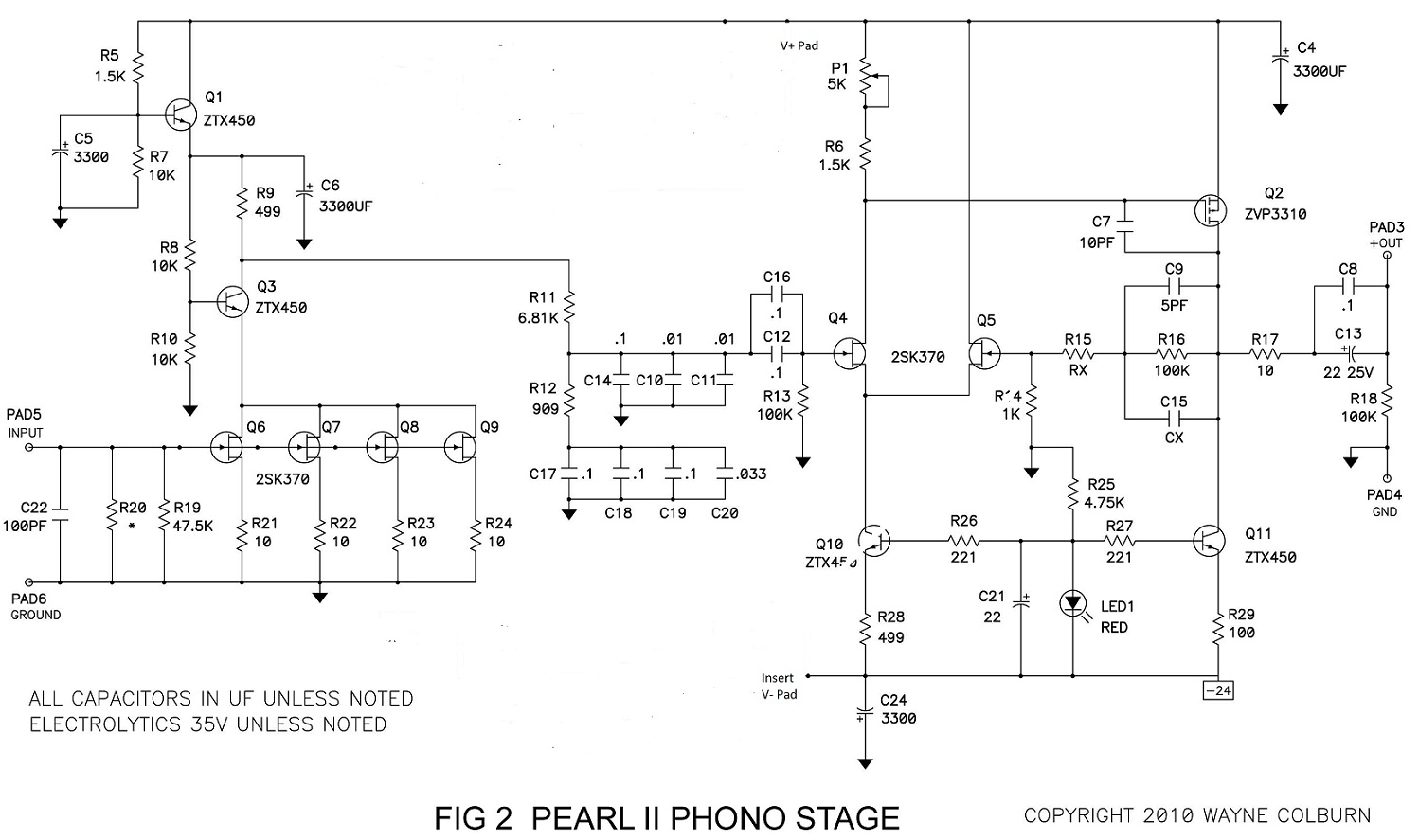

Judging from the voltages I get, isn't the Q1 the most suspicious?

Hello, again. I've tried relative mode on DMM. No help. I've connected ground direct to bridge ground like this:
http://i198.photobucket.com/albums/aa276/aeroplane_album/Pearl2PSU.jpg
didn't help either.
Here are some pictures:
http://i45.tinypic.com/29nz2iv.jpg
http://i48.tinypic.com/294gwsg.jpg
The grounds of L & R boards are tied together underneath with thick 0.6mm squared solidcore copper wire. Right in it's middle point respective ground and sense wires are connected from two shunts. Same goes for the "bridges" that you see above connecting to +/- pads and having +/- shunt Vout wires tapped right in the middle of them. I know, they don't remind the thing of beauty, but I was aiming for the shortest distance between pads for now. If you have suggestions how to make it proper, I'm all ears.
Here's a DC factory rat nest:
http://i46.tinypic.com/iqagyc.jpg
So, the voltages from the shunts seem stable, but I can't adjust P1 and having wrong measurements right below Q1.
Now I need your help. I can measure, make pictures and stay patient as much as a hard days night allows me.

You can't get proper biasing if you omit the voltage links on the boards. I assume you use shunt reg and no onboard regs. You need the 10R filtering resistors though, and also the big capacitors to be onboard. You also need to short in and out of the 78xx / 79xx holes onboard in order to get the voltages for proper biasing. Refer to 7824 and 7924 datasheet to find the good pinout

Anaël, yes I'm using shunts and this schematic, as proposed by Salas and tested by Tea-Bag already.
http://www.diyaudio.com/forums/gallery/data/1463/Pear_two_sans_regulator.jpg
Reading you now, I think, I've got my major mistake. I've bypassed the onboard regulators with a jumper from +DC IN pad to R4 point, BUT, I haven't bypassed or referenced ground. I wonder how the circuit worked at all!
The bypass are under the board I guess ? Not easy to check at a first glance.
Do you have correct DC supply potentials in place on the Pearl boards ? It seems led is lit so it is a good sign. Maybe check with another multimeter ? Sometimes they can go wrong, had it when modding my Pearl II. Another meter worked fine

I have bypassed from +/- DC pads to respective points indicated on this schematic:
The ground pads are just tied together. Should I have a link from them to somehwere? Yes, lids are lit.
When I check DC supply on Pearl boards I check on GND pad and the jump point.
