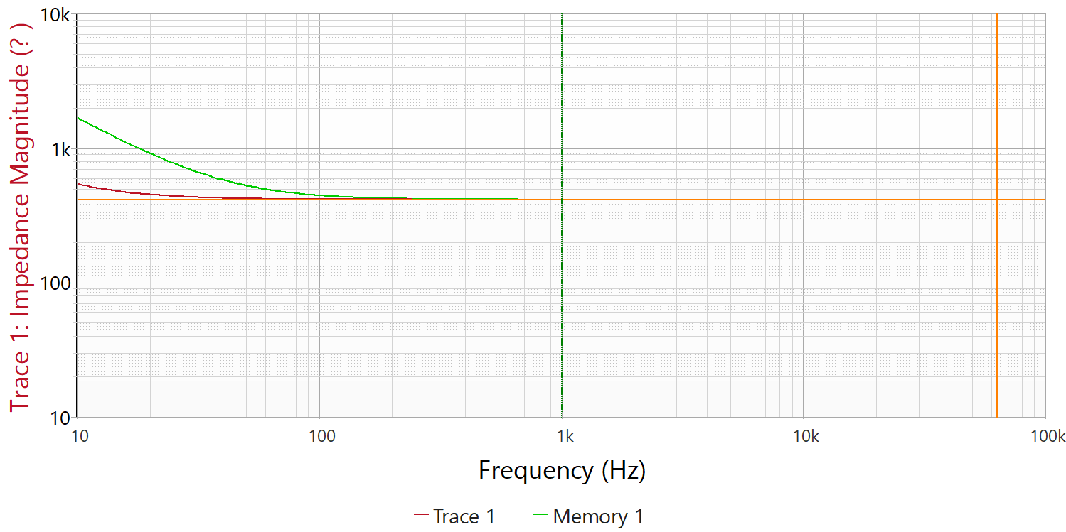

Bet you haven't seen this before:
Output impedance of the first gain stage -- about 416 ohms. I would have though it was lower. (I used two different coupling capacitors -- that's why the curves vary at low frequency.)
This will (should) affect the values of the passive RIAA compensation network.
