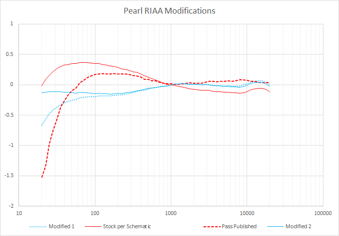

If you are planning to tweak the design, adjusting the RIAA component values gives the best bang for the buck.

Thanks for the reminder on the RIAA changes, Jack. I made some notes from your original post on this topic some time ago. I noticed in your graph that the units displayed were on the order of 0.25 and 0.5dB. How audible of an impact were these changes you made?
Dont' tell anybody -- the only time you'll hear a difference is when the two channels aren't matched to each other. As most of my vinyl dates from the 1960's and 1970's other things are much more bothersome.
If you are going to invest the time on a Pearl 2, probably worth buying a 10 pak of the two RIAA filter caps OR invest in an assortment of smaller value caps which you can tack solder in until you get two curves which resemble each other.

Just to refresh -- way back in the thread -- this is how the improvements suggested for the passive network affect performance.
