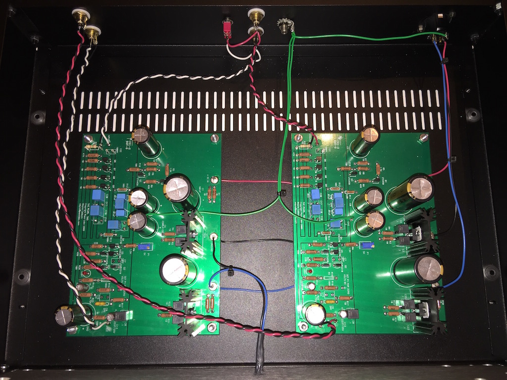

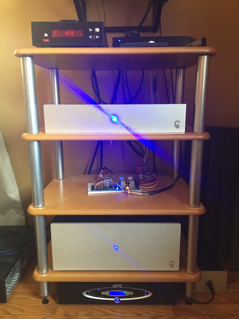

I got the Pearl 2 wired into it's permanent home last night and it looks great and sounds even better! What an incredible phono stage!
Now just waiting on the faceplate back from the machine shop for the Mezmerize (getting an LCD window opening).
Question for the gurus ... I added a mono switch to my build. You can see it to the left of the input jacks in the pic above. When I switch it to mono, I get an out-of-phase hum. Since these boards are mono, should I also be switching the signal negative leads and shorting them as well?
