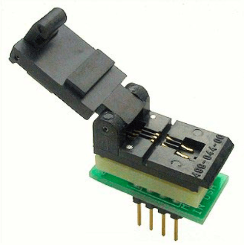

I matched a few quads/octects of 2sk209s, if I remember correctly the first three parts I tested off the reel were relatively tight matches (less than 0.1mA), then after testing 6 or 7 parts in the Idss jumped by 2mA, so it seems luck of the draw. To make a long story short with a little luck you might be able to get two quads with 20 parts, but with 50 you are more likely to and will probably get tighter matching. it was tedious using tweezers to pick and place those SOT-23s correctly into my fixture.So, if I'm right, looking at the data sheets 2SK209 Yfs with Id of 2 mA (typical for the P3) is around 12. 2SK170 Yfs with Id of 3.6 mA (my P3) is around 25. Double the gain due to higher Yfs, 6 dB loss of gain due to drain load according to @Auricle. Net result would then be the same gain?
