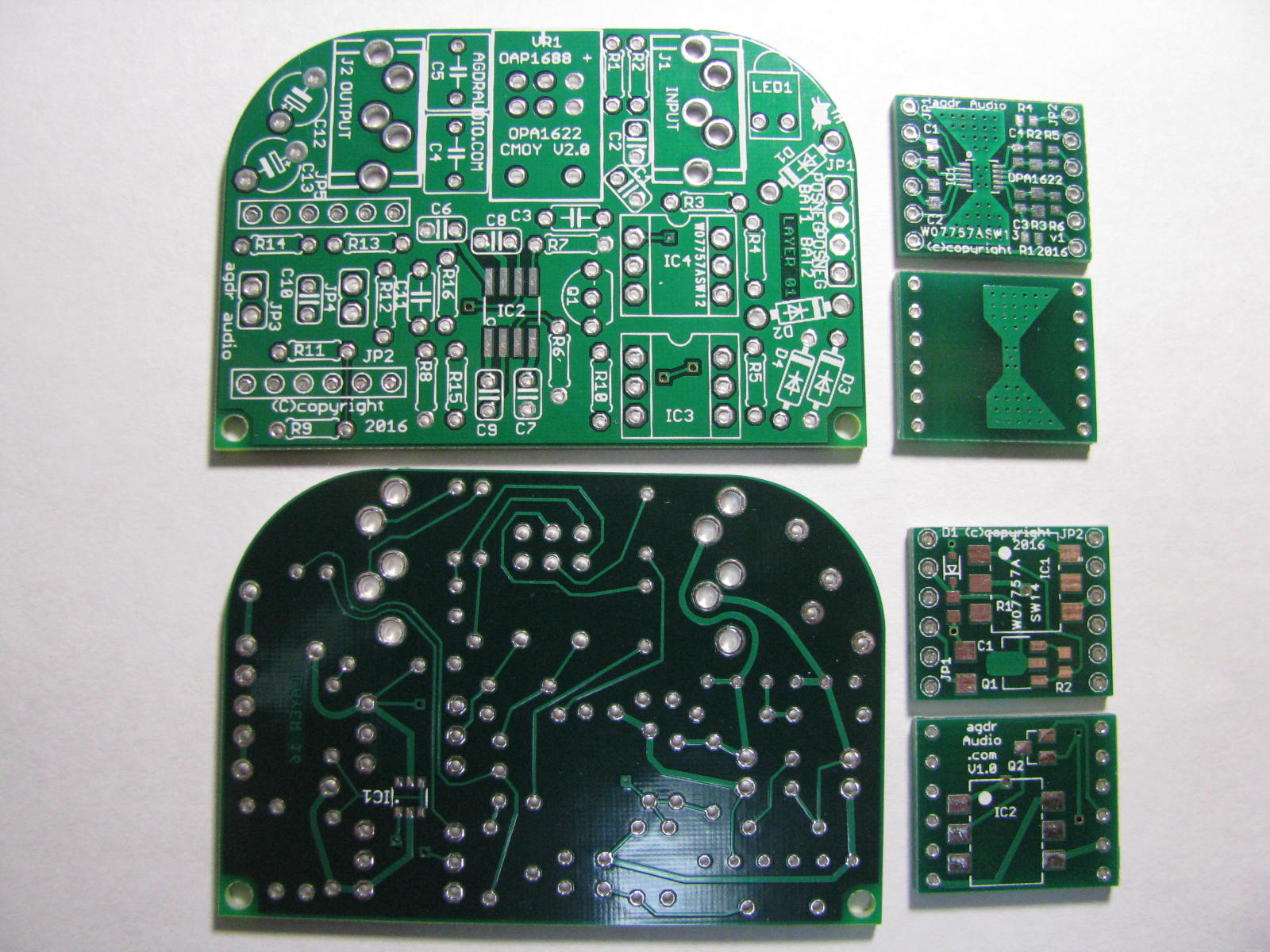

Here is another pcbway ordering trick I've run into. I had 3 different project boards to go out and asked if they have combined shipping for the DHL. Sure enough, if you submit them all at the same time, when they come back from the "review" phase it will show combined shipping.
On the 3 boards below, 10 of the bigger 4-layer and 20 of each of the smaller 2-layer the DHL shipping would have been $25 each. By submitting them all at once it came back with just one $25 shipping for the whole bunch! Sure enough they all arrived today in the same box.
I'm taking advantage of that again an sent out 3 more yesterday. This had two 4-layers of 1o pieces each and 1 2-layer at 10 pieces. The individual DHL shipping showed $25 each on them. The combined shipping for the 3 projects together clocked in at $38. I guess $38 is their next-larger standard box size past the $25.
On the first combined order their "review" of the submitted boards didn't happen for about 40 minutes, so no troubles with getting all 3 submitted before the review. On the second batch though the review started just about 5 minutes after I submitted the 3rd project! I would guess that if they happen review them before all the projects are submitted that customer support could be emailed to make the combine ship number correct.

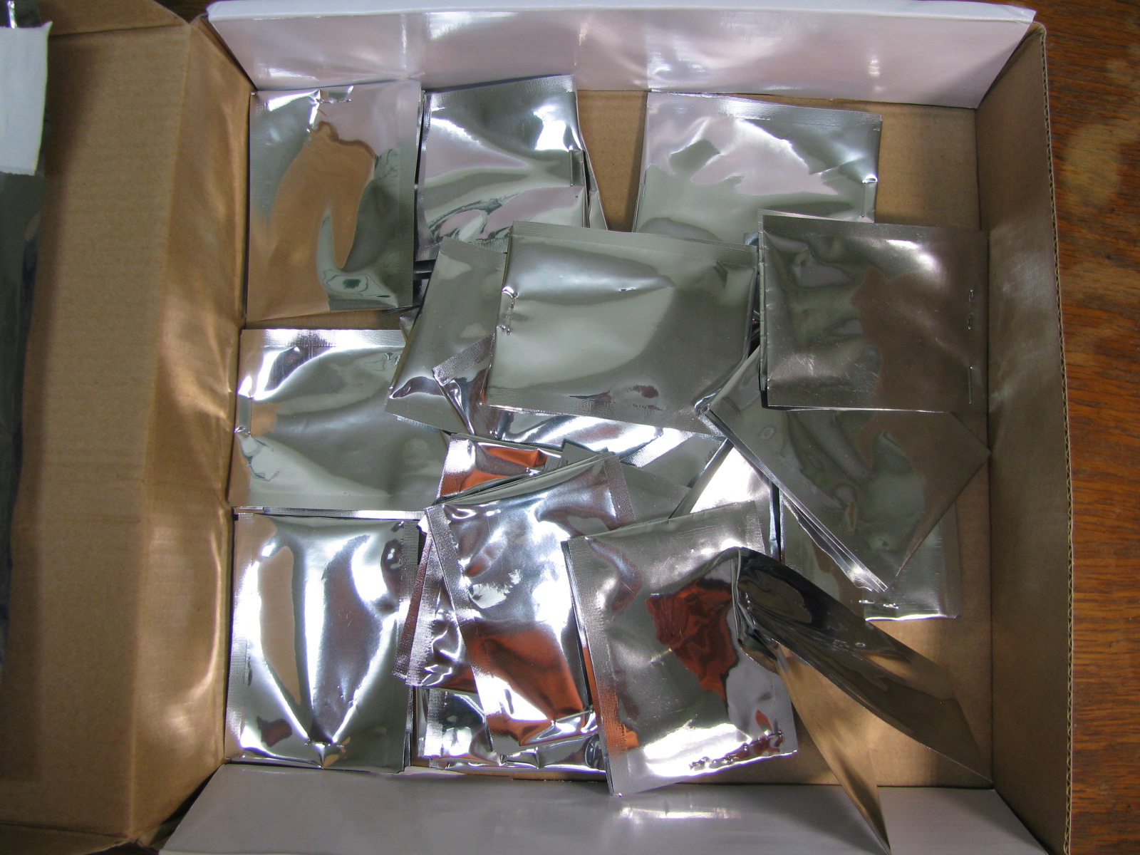

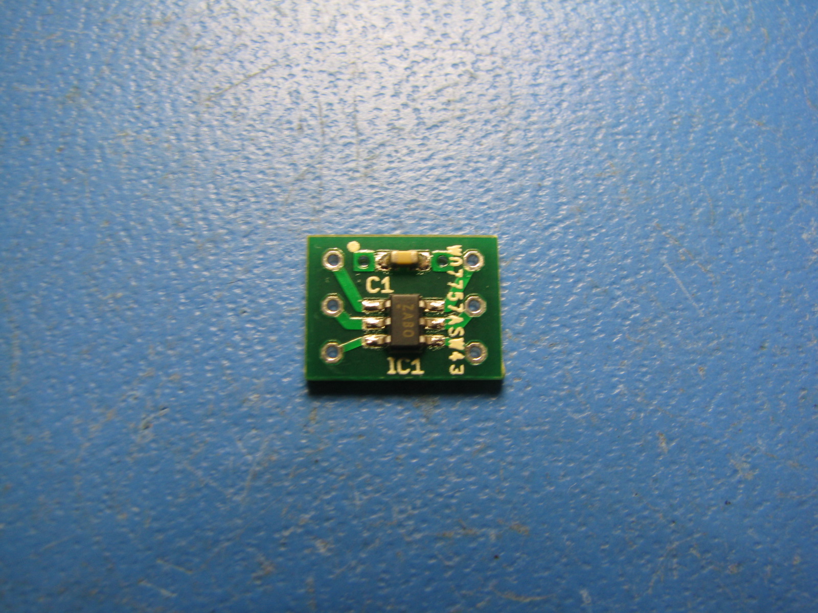

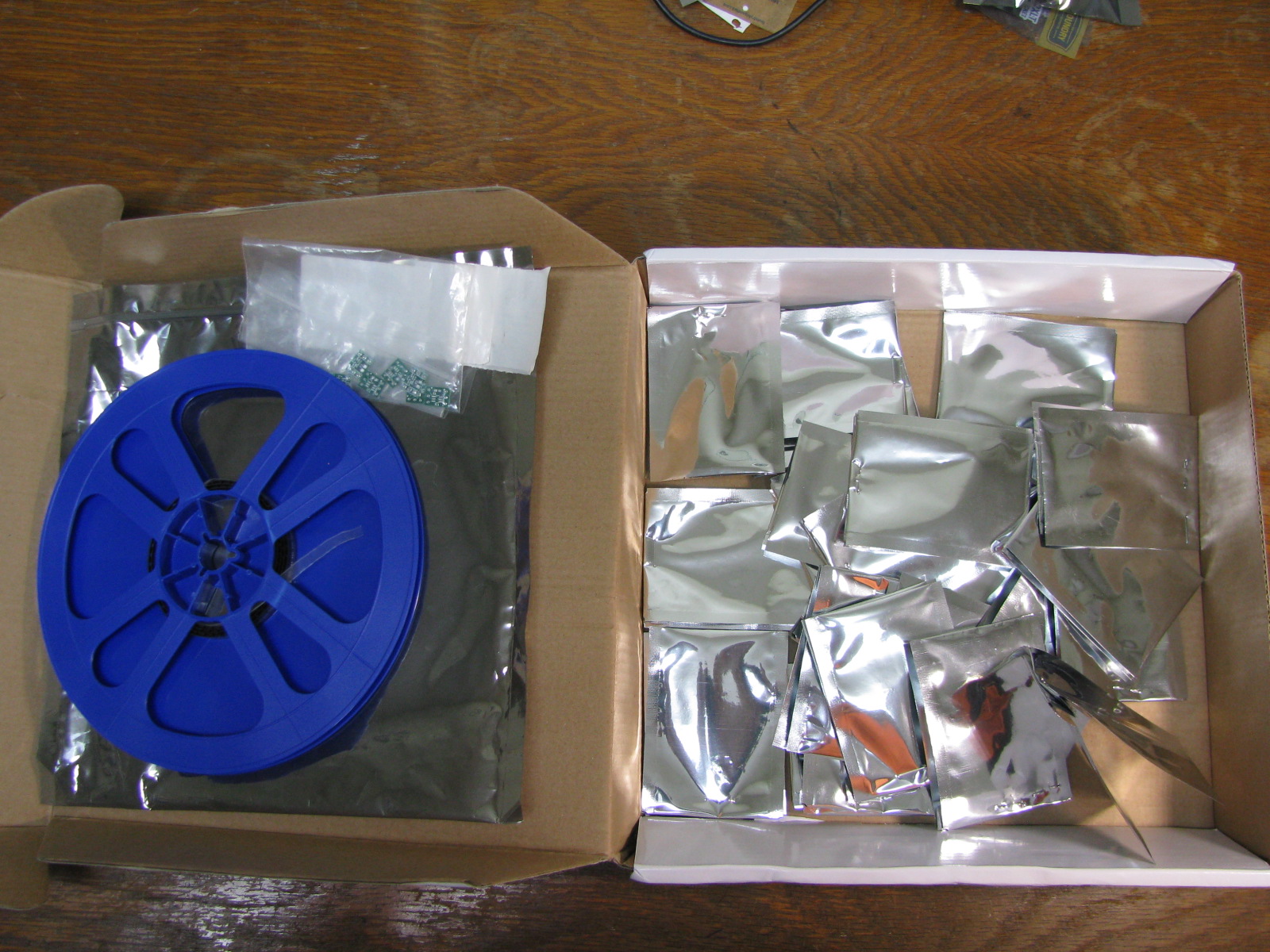

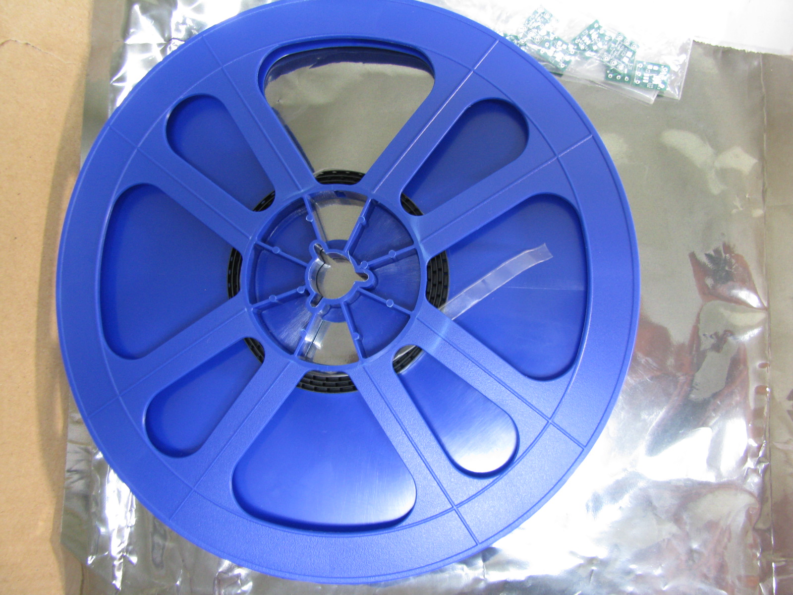

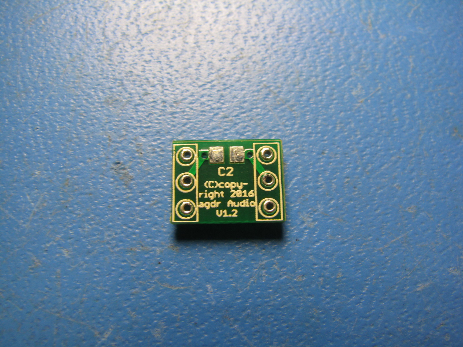

I finally had an opportunity to try out pcbway's assembly service. I'm quite impressed!
I had been talking on and off with one of their customer service reps for a few months about potentially assembling this board. The chip involved, a TPS3701DDCT comparator, is a SOT-23-6 that has proved to be just too small to reliably hand solder, for me anyway. I wanted to get 50 assembled professionally. Having the board fabrication house do it seemed like it would skip a step. They can fabricate the board, assemble them, then ship off the assembled board. Everything went pretty smoothly with a few twists and turns along the way.
Pcbway's assembly quoter wants your Gerber files, a "centroid file", and a BOM. The centroid file tells the assembly machines where the center of each part is. If you are using Eagle it turns out that file is easy to generate. On your board layout view click on the "run ULP" button at the top and run the program "centroid - screaming circuits". The output file winds up in the same place as your generated gerbers. The BOM can just be a spreadsheet dumped as a comma separated list file (.csv). The format of the BOM isn't critical, just put headers on the columns to show what they are.
Pcbway can quote the assembly using your parts you mail in, their parts, or a combination of the two. In my case it turned out the TPS3701DDCT chip wasn't available in China yet, so I went with the third option. The board uses a 0603 sized 0.1uF 100V MLCC they sourced for $0.01 each - cheaper than I could buy them - then I mailed them the chips. First time I've bought a "mouse reel" from Mouser Electronics, their partial reel service, which is the blue reel in the photo below. Mouser charges a $7 fee to create the partial reel. Pcbway required sending in some overage, 80 chips to assemble 50 boards, but they returned the extras on the reel. Pcbway requested the chips be on a continuous strip, hence the partial reel.
Another thing I ran into was board size. Their minimum for machine assembly is 50 mm x 50 mm. This tiny adapter board is only 10.5 mm x 7.9 mm and they told me up front it would be hand-soldered. At first I balked at that, but given the trouble I was having soldering the tiny chip I figured they presumably do this all day long and have folks with maginifiers and steady hands. Sure enough, as the photos show the resulting solder job looks as good as a machine to me.
The boards can have lead-free finish at pcbway and they can assemble with lead-free solder. I never use lead-free solder myself, so this seemed like a good opportunity to get it done as lead-free and RoHS. I think it wound up being an extra $10 or so total for lead-free.
One small hiccup came in mailing the reel of chips. For some reason DHL out from the US is a lot more expensive than DHL to the US from China. I went with the post office here instead, which charges $13.50 to send a padded envelope overseas, then another $13.50 to have it sent "registered", which was supposed to provide tracking the whole way. The "registered" thing turned out to not really work. It did wind up going by air (postal clerk thought it went by ship) by being registered and arrived in Beijing in just 4 days. But there it sat for the next 4 weeks with the tracking saying "departed Beijing for destination". I assumed it was stuck in customs, but instead the postal folks over there simply had not let pcbway know the package was ready for pickup. So my advice here is use DHL, the extra cost and real end-to-end tracking is worth it. I believe DHL has in-house customs which speeds things up.
Once pcbway got the chips they immediately started the assembly. They had already fabricated the bare boards weeks before. They sent me a photo of one assembled board to get an OK, then they had the rest soldered up and in the mail by the end of the next day. I was impressed that they bagged each one in a separate little anti-stat bag, in the photos below. The whole thing was then put in a large anti-stat bag. I only had the two surface mount parts assembled. There are two rows of connection pins I'm going to solder myself. Finally got some no-clean lead-free solder. Leaving the through-hole connection pins out of the assembly reduced the cost a bit and made the boards small for mailing.
All in all I'm very happy with their assembly work and would recommend it. They communicated well (email) through the whole process.

$210 for all the work at pcbway, which included fabricating the 50 lead-free bare boards, the 50 0603 capacitors, surface mount lead-free assembly/soldering, the paypal fee, and DHL shipping back to the US. The 50 chips at Mouser were $110 (I bought 80, but at their 50 piece price the 50 used come to $110), shipping and tax from Mouser was $16, the mouse reel fee was $7, then the USPS shipping for the chips was the $27.
So all total ($370 / 50 boards) = $7.40 a board.
What really made the decision for me was going through 3 chips every time I tried to solder a board myself. One or two would fly off the tweezers and wind up in the rug. I often had to re-position a chip so many times (to get the other 5 pads lined up with just one corner pad soldered) I started worrying about heat damage and tossed the chip in the trash. I've been soldering for 40+ years and almost never kill a chip with soldering heat anymore. Yet I managed to do it with two of these boards I assembled.
I did try quoting two US assembly outfits and the cost would have been something like 3x - 5x.
A higher quantity would have really lowered the price. I asked how much to assemble 100 rather than 50 and it was just incrementally more, something like $240 instead of $210 as I recall. A lot of the price is probably one-time setup. I just didn't know what I would do with that many boards!

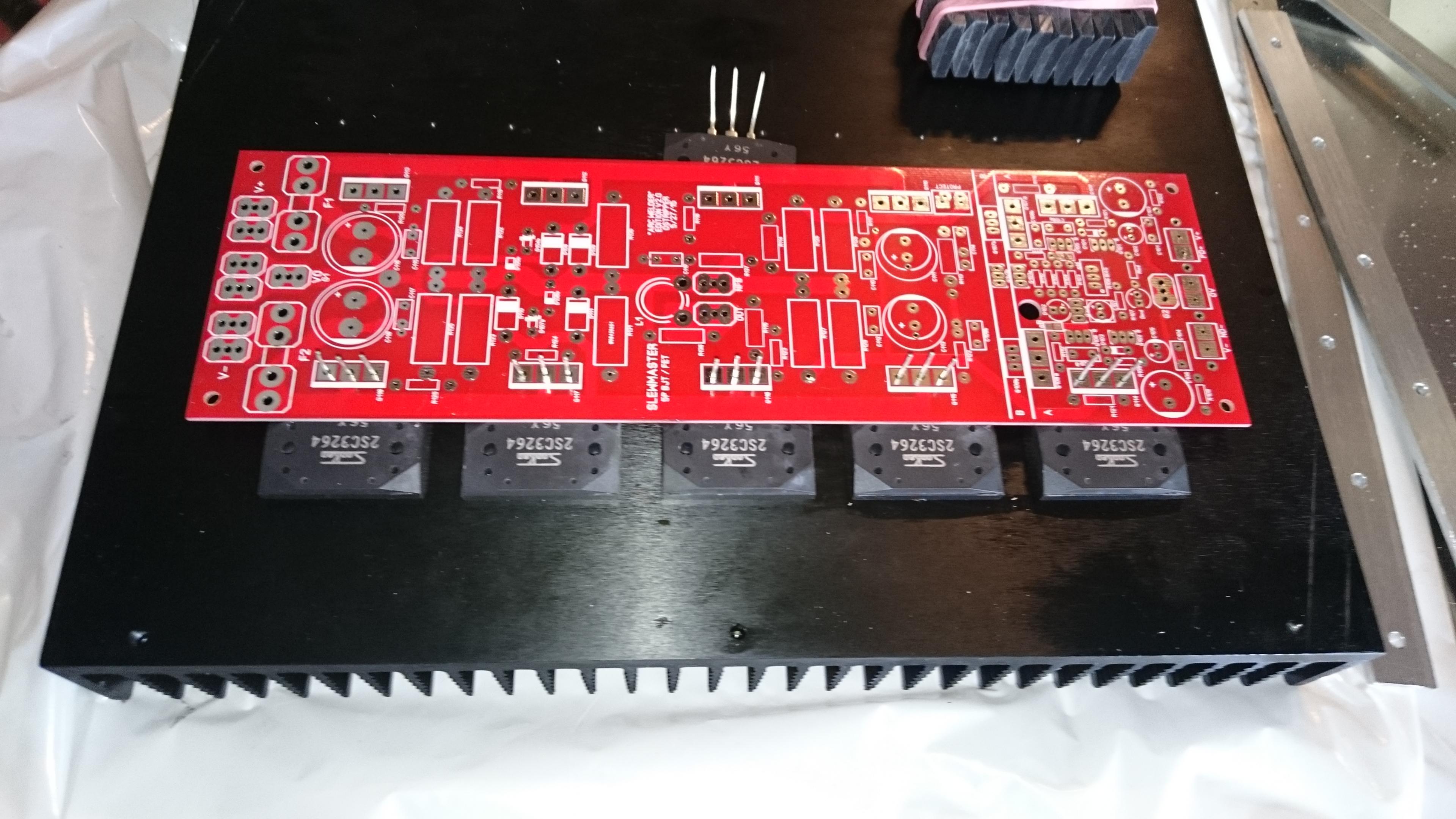

I recently put a pcb order into pcbway.
I sent off my files and they were approved.
The pcb is a little odd in that it has some none plated holes for TO3 transistors.
After a day I had a look through my files again in my gerber viewer.
I suddenly realised I had sent a blank drill file for the none plated holes.
I quickly got the right file together and emailed it to pcbway.
Luckily I had caught them before they had started making the pcb.
Got the pcb's through the post and they are great, excellent quality.
Built a couple up with components and they work great.

If you ever tackle a project like this again, let me just mention that like you, I struggle with less than perfect eyesight and less then super steady hands, and its forced me to get creative when it comes to building boards at home. I had a long thread on StackExchange.com inquiring about the best way to simply hold tiny SMD parts in place while I soldered, and it was there that I got the advise that changed my electronic DIY life. What I learned is that you need not try to individually solder the parts with an iron. Instead, I now get solder paste in small syringes, dab a little bead on every pad, place the parts, and flow the whole board. I either use a toaster oven, or a hot-air reflow workstation (which are very reasonably priced these days, on EBAY).
Note that when it comes to small chips, you don't even need to apply the paste to individual pads. Instead you just draw a line right across all the pads and mush the IC into place. The secret that makes this all work is the way the solder beads up and pulls together around the pads and conductors when heated. Once in a while you might get some solder bridges, but a short time with some solder wick cleans it right up.
Another trick you should consider is using your PCB software to make multiple replicas of small layouts on a single board. kind of like "Panelizing". For small uncomplicated layouts like yours, that process will enable you make many boards together, and cut them all apart later.
Thank you for the feedback and tips! You are right, I haven't tried hot air or a toaster oven & paste yet. I have a new (eBay!) hot air station that has been sitting here for a few months I just haven't had time to try. It does sound like a good solution. For this board though I was thinking that 10.5mm x 7.9mm would be too small to even hot air solder? I'm using a vise with rubber jaw liners and I was thinking the hot air might melt those. But a toaster oven would probably solve that.
Yeah I was thinking about panelization. I tried asking a couple of times if it would be possible for them, or me, to panelize a bunch of those boards to hit the 50mm x 50mm minimum size for machine assembly, or if the v-scores would come apart in the machine. But both times the language barrier got in the way a bit and didn't really get a clear answer. I figured I better just run with the individual assembly for now to get it done. I agree though, it sure seems like someone out there should be able to machine-assemble it as a panel of smaller boards!
Hey thanks for the offer to quote on populating and cutting! I'll keep that in mind for future projects. Sounds like you have the technique down pat.
