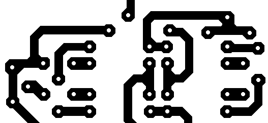

PDFCreator v0.8 p2 link provided does not seem to work here in sunny California. No valid results by Google.
pdf files are a simple jpg tool. Images are not in the 300-600 dpi range which I consider "nice" for ordinary work.
Not possible to post a proper tiff file here, but here's a "high quality compressed .jpg" at 300 dpi. BTW all .jpg and .pdf file formats are lossy by nature. Portability at the price of quality. Kinda like some "music" folks want to play on their iPod.

you are NOT right, in a PDF CAN embedded JPG, PNG or TIF.
But with PCB Express the image is a vector based image, witch can be scaled without loos to 'any' size = DPI !
Try it out !
Here is the link to PDFCreator again.
I hope you can 'click' on it.

.jpg and .pdf are lossy formats and not to be considered a high quality imaging product. It is not the point that it is possible to create a .pdf from a .tiff file.
I do not wish to scale the vector file, only produce it "exactly" as drawn. Which the http://www.expresspcb.com/ free software did not do on my recent installation, as expected, nor as you propose. Even so, this minor detail does not make up for other deficiencies.
Perhaps there is something wrong with my dual 1Gig Xeon w/ 4G of memory preventing this free software from functioning properly. I will investigate that possibility.
http://sourceforge.net/projects/pdfcreator/ is the correct link and yes I can click on it. Caution, you must re-boot at the end of this 7,385 kb install.

PDF: NOT a lossy format AFAIK. It is basically a form of encapsulating postscript, postscript is a computer language. If that embeds a TIFF then it's not lossy, nor is a native postscript-described vector layout (uber-gerber?). Granted, most postscript generators will use lossy formats for images (jpeg), but the biggest loss comes when images are resampled to a lower resolution for screen viewing, which is usually the case as that is what pdf is for.
Diptrace: I think no gerber output would be fine for the hardcore DIY community. I still don't send my own (as in DIY project) PCBs away for manufacture due to the expense, though I'll happily drop $4k on a multilayer prototype when the client pays me back
Perhaps .pdf is not a "lossy" format. So maybe someone can explain how a 1,460KB .tiff file somehow miraculously becomes a 66KB .pdf file without loseing something in the translation. If I convert the .pdf back to a .tiff file, is it exactly the same as before? Gee, I think not. Least not the last time I did it.

Hello acenovelty,
PDF creator can also convert the spool into JPEG or BMP or TIFF most of the common image formats apart from the .PDF and .PS. You can increase the quality (DPI) by changing the options in the PDF creator. Thanks to dx.master for the nice little software

acenovelty said:Perhaps .pdf is not a "lossy" format. So maybe someone can explain how a 1,460KB .tiff file somehow miraculously becomes a 66KB .pdf file without loseing something in the translation. If I convert the .pdf back to a .tiff file, is it exactly the same as before? Gee, I think not. Least not the last time I did it.
Most likely because you printed a .tiff file to a .ps file, then distilled the .ps file into a .pdf (or something did that process for you), which is a 'lazy' way of generating pdf (if the only practical way). B&W tiffs should easily compress by the ratio you saw, due to G4 fax compresison that gets used, and that is lossless. One of my boards just got a 792K -> 3K compression.
I see your overall point of course, but the reason I'm not so receptive is that I used to send PCB filmwork to imagesetters as .ps / .pdf format because that's what they took!
I've battled similar problems mentioned here, trying to invert solder mask artwork to work with positive resist. I ended up having to go through a fax driver at 200dpi to get a usable bitmap. These days I just print to pdf (in 'perfect' vector format) and rasterize to whatever ppi I want with Photoshop.
